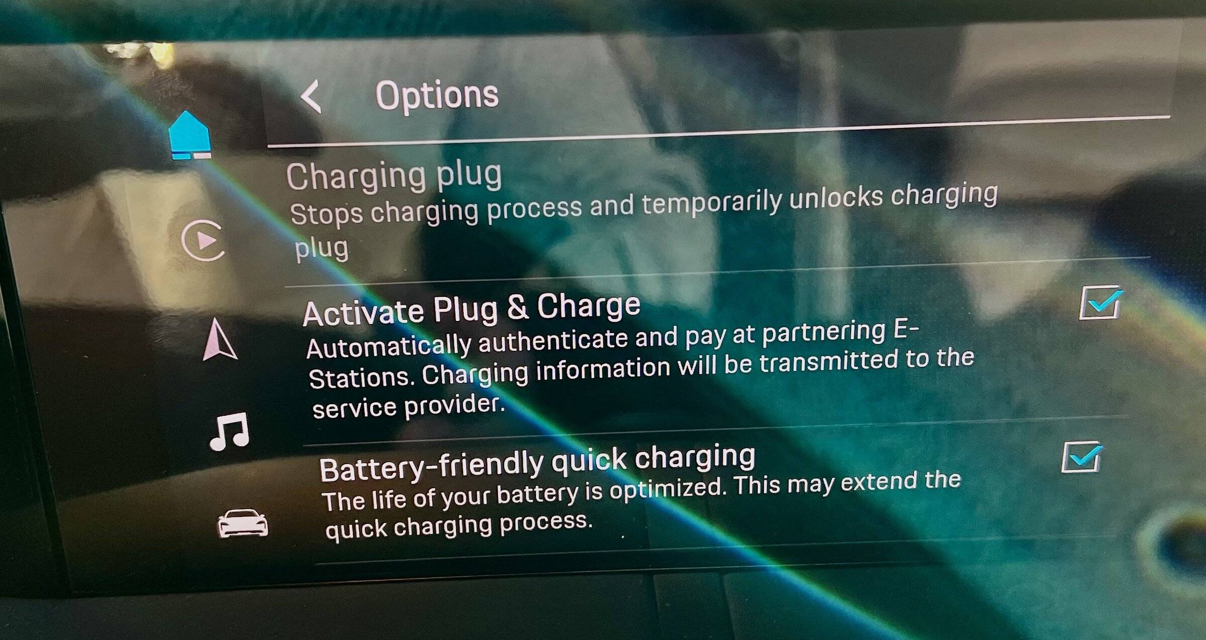

Hello
I found an option in the PCM to enable the plug & charge feature. See picture. All charging stations are not equipped with this feature then it will not work everywhere. If you use the app charging you can filter for EA station having the feature P&P on.
So far I was only using the Charging application. The process was :
  • Plug in
  • Start the charging from the application using the charger identifier
This weekend it did not worked and I called EA while at the charger and the lady told me not to use Charging but the new Porsche app. The process is now different:
  • you start the charge on the application
  • Then you plug-in
It worked twice already as the Charging application gave me error all the time.
I also found this option Battery-friendly quick charging option.
It is self explanatory but it does not really says what it does in term of charging power. Any idea?
It caps the high speed charging session to a maximum rate of 200kW, even in situations where you have optimal conditions and could get closer to the theoretical maximum of 270kW. See the following video staring at the 3:25 mark for more info on this.
