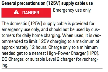

From the "manual" attached to the letter:
Porsche Taycan Email from Porsche: Mobile Charger current set to 50% as a precaution --  - utter BS - OMG they don't think they have a problem… 1673031201228

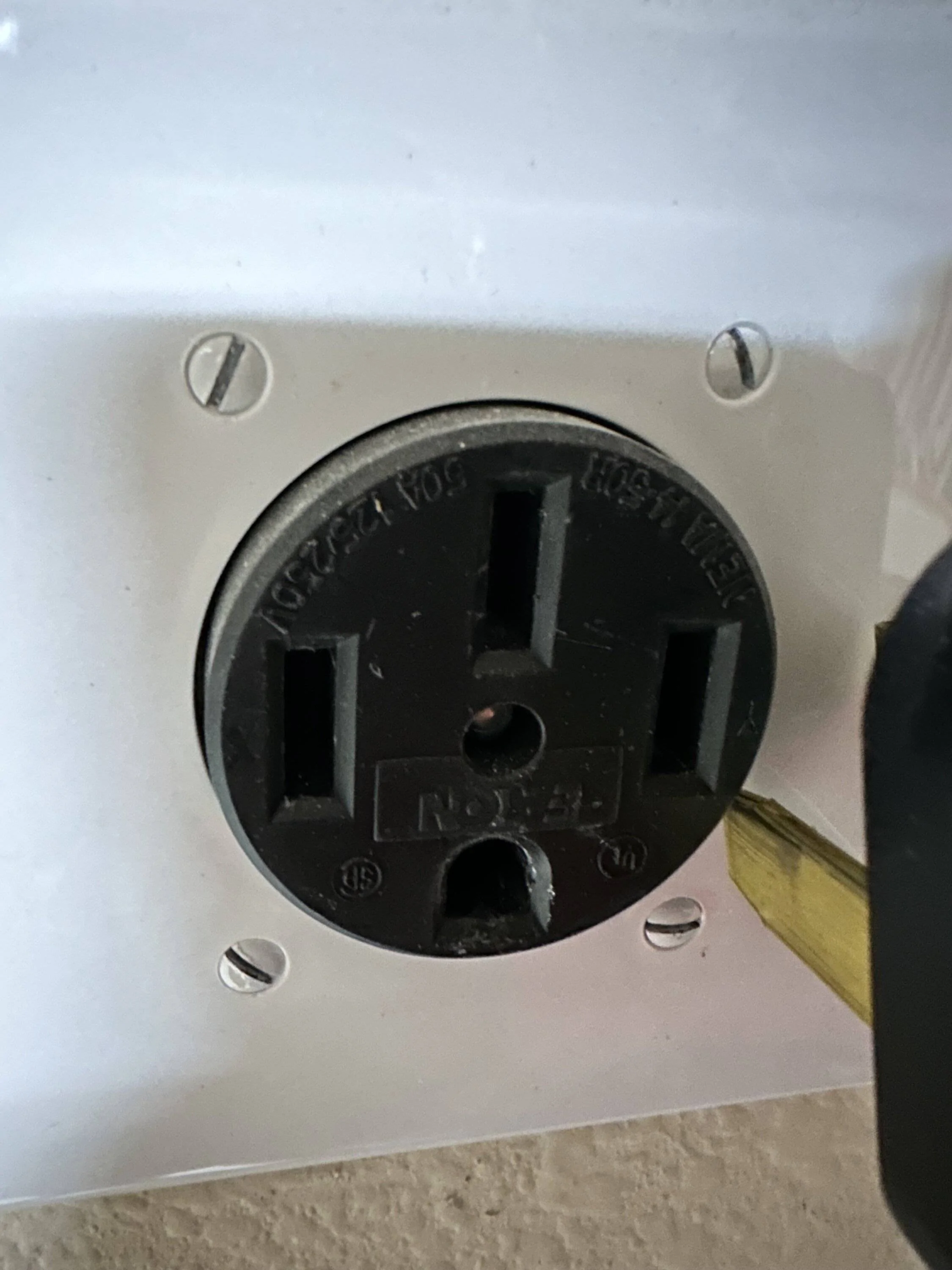

I have been using my Porsche Charger on a 6-50 50 amp outlet installed by professional electrician for my welder. I have had zero issue with heating or any of that. Even though I think my current set up is good I am going to change the receptacle to the specified Hubbell 6-50 and absolutely will not change the charger programming. I do have a Mustart but bought that for traveling. They should have at least sent a credit for a Hubbel outlet since their engineers missed the boat on US residential 220-240V wiring designed mainly for electric dryers and ovens.

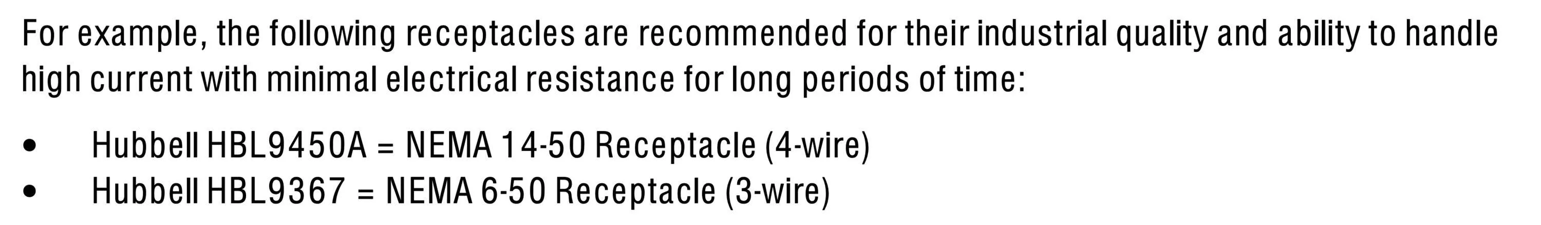

to be fair - Porsche's recommendation (and other EV vendors) to use a Hubble Commercial quality socket is 100% spot on - excellent advise and should be followed.
In this aspect of this situation 100% follow Porsche's advice in this space.
Porsche Taycan Email from Porsche: Mobile Charger current set to 50% as a precaution --  - utter BS - OMG they don't think they have a problem… Screenshot 2023-01-06 at 11.22.06 AM
the $12 Leviton stuff (or equivalent) simply is not rated or up to the task for multiple hour continuous load at high amps…
I don't care _WHO_ makes your EVSE - you should invest in the high quality Hubble (or equivalent) sockets - it's well worth it to avoid potential problems.
https://www.taycanforum.com/forum/t...-related-porsche-ntsb-article-analysis.13902/
https://static.nhtsa.gov/odi/tsbs/2022/MC-10222530-0001.pdf
