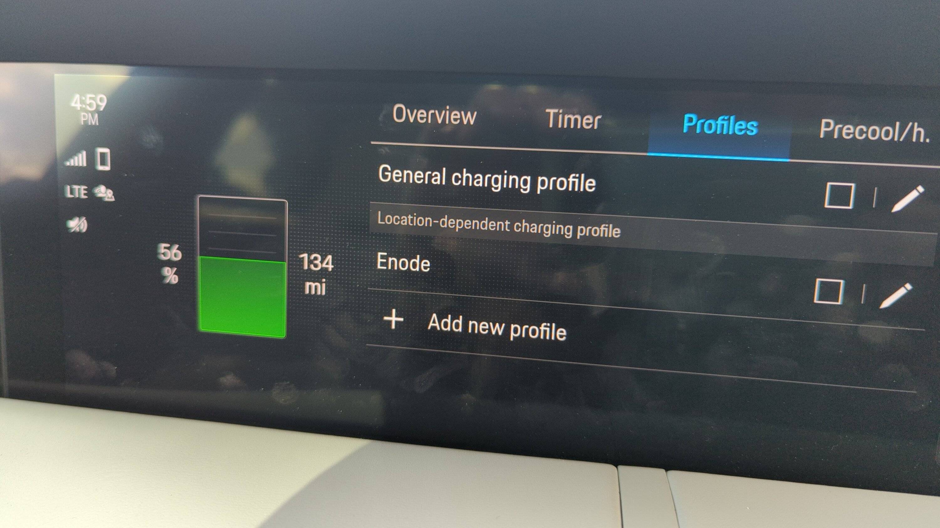

My car won't charge. Everyone I start a charge, it starts, all is treen, then the light by the port flashes blue. When I look on the car, the enode has turned itself on. I have to manually select direct but it still never charges. I'm going to run out soon. This my second Taycan and I've only ever seen it this week.

the flashing blue usually means you have a timer set and the charging is delayed by the timer (as I am sure you know)..but that should not happen if you are set to direct charge....maybe a reboot of the PCM? ..BTW, what is an Enode (I have never seen that on my US-based car)?

I noticed it has added a timer. Don't seem to be able to delete it either. You can until but comes back.
Actually I didn't know about the blue light as I've never used a timer, so thanks.

Enode is a profile sent by Octopus. OVO Energy also use the same software.
Change the settings in Octopus App if you need to charge immediately. The charing port flashes blue when charging is waiting for the Timer to start the charging session to meet your desired ready by time and soc.

That makes.sense now. Do I have to bump charge as public chargers as well?

No at any charger away from home the Taycan will charge normally. DC chargers ignore profiles and timers but at an ac charger you have to delete them or press direct charging
