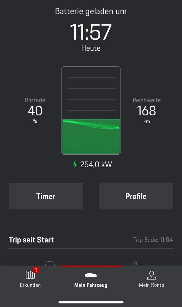

I regularly hit 260 kW on Ionity here in Ireland if state-of-charge is low enough. So you are likely getting that rate!
I've used the 350kw chargers on this trip at least 10 times. Everytime the battery was below 20%, it went straight to 250kw. I was just shocked to see it at 40% SoC! o_O

I am on my way back from Italy to Switzerland. Innodrive doing it’s job while I type. This is on a empty highway of course, doing this for science.
I wanted to share this screenshot.
Can’t believe how fast this car is charging, or it’s a false reading from the app ?
So geil!
