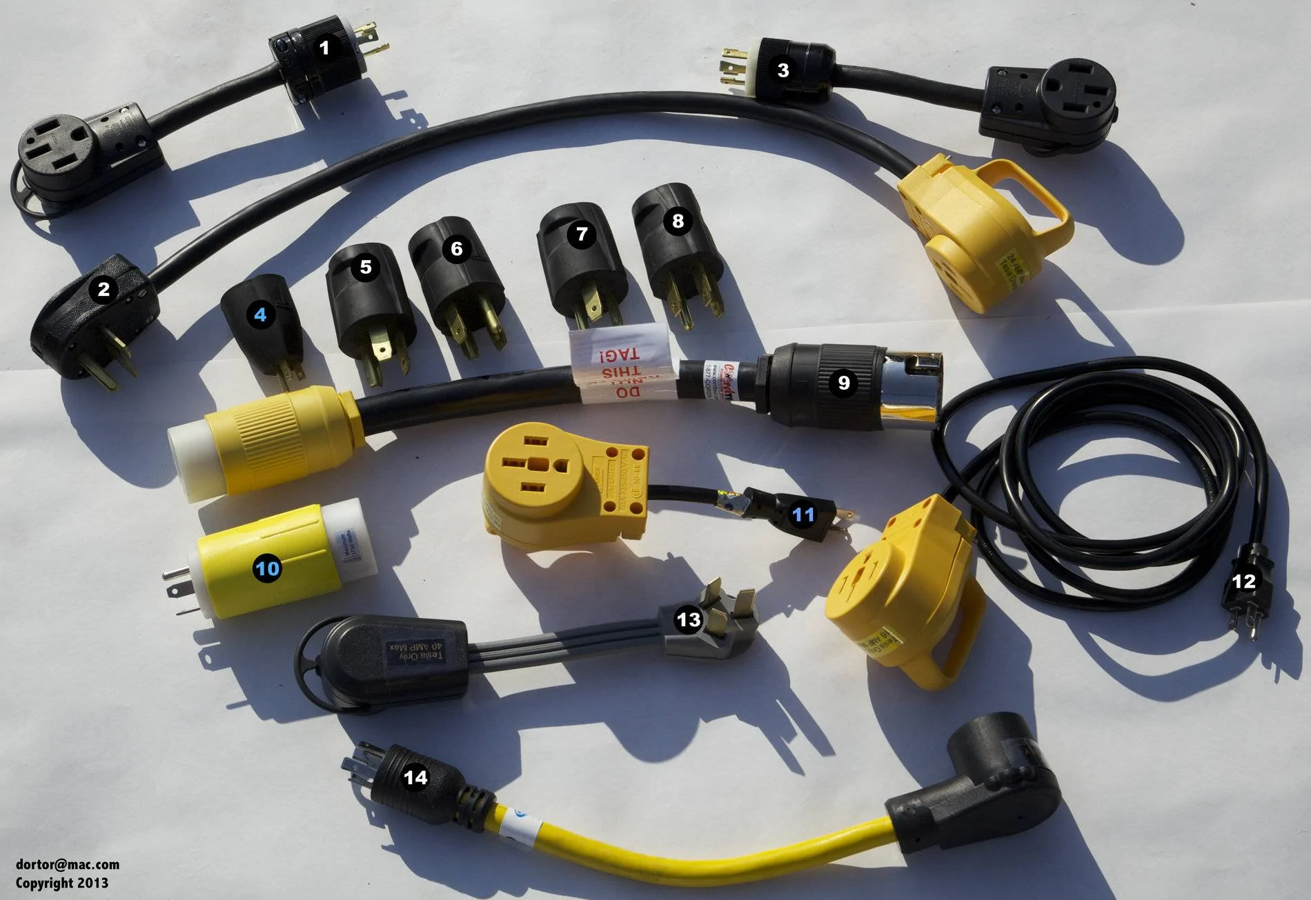

here is a picture of all the "adapters" I have in my kit - again this is not for the faint of heart and entirely un-necessary - and 7 years in many have remained unused "in the wild" - but it's listed here for completeness - and yes I could charge my EV at virtually any plug one could/should find in North America…
Porsche Taycan EV Roadwarrior adapters “kit” All Adapters 1.0

  1. NEMA L6-20P to 14-50R - 240V - 20 AMP Service - 16 AMP Charge - 3840 watts
  2. NEMA 6-30P to 14-50R - 240V - 30 AMP Service - 24 AMP Charge - 5760 watts
  3. NEMA L6-30P to 14-50R - 240V - 30 AMP Service - 24 AMP Charge - 5760 watts
  4. NEMA 5-15P to Tesla Charger - 120V - 15 AMP Service - 12 AMP Charge - 1440 watts
  5. NEMA 10-30P to Tesla Charger - 240V - 30 AMP Service - 24 AMP Charge - 5760 watts
  6. NEMA 14-30P to Tesla Charger - 240V - 30 AMP Service - 24 AMP Charge - 5760 watts
  7. NEMA 6-50P to Tesla Charger - 240V - 50 AMP Service - 40 AMP Charge - 9600 watts
  8. NEMA 14-50P to Tesla Charger - 240V - 50 AMP Service - 40 AMP Charge - 9600 watts
  9. NEMA SS2-50P to 14-50R - 240V - 50 AMP Service - 40 AMP Charge - 9600 watts
  10. TT30P to 14-50R - 120V - 30 AMP Service - 24 AMP Charge - 2880 watts
  11. NEMA 5-20P to 14-50R - 120V - 20 AMP Service - 16 AMP Charge - 1920 watts
  12. NEMA 6-20P to 14-50R - 240V - 20 AMP Service - 16 AMP Charge - 3840 watts
  13. NEMA 10-50P to 14-50R - 240V - 50 AMP Service - 40 AMP Charge - 9600 watts
  14. NEMA L14-30P to 14-50R - 240V - 30 AMP Service - 24 AMP Charge - 5760 watts
adapter #11 & #12 have been replaced with "official" and supported adapters from the EVSE manufacturer since this photo was originally taken.

Adapters I've actually used over the past 7 years - in order of frequency - top is most frequent - bottom least frequent
Often
  • JDapter/Tesla-Tap - NOT SHOWN
  • NEMA 14-50
  • NEMA 6-50
  • NEMA SS2-50P (marine shore power connector - concert venues as well - stadiums may have these in parking lots - this pig tail converts the round connector to a standard NEMA 14-50 plug - I have been surprised how many of these plugs I've found over the years and charged at 40 amps)
Sometimes
  • NEMA 5-15
  • NEMA 5-20
  • NEMA 14-30
Rarely
  • NEMA 6-30 (Laguna Seca garage tire warming plugs)
  • NEMA L14-30
not listed - then probably never used other than in testing
Toby Pennycuff
Toby
Jun 12, 2019
172
204
Dallas, TX
Porsche 911S, Porsche 930, Porsche GT3 Cup, Taycan 4S
Dave,
Thanks for all of this detail! Were most of these adapters (the non-plug converters anyway) "Lowes" or "Home Depot" projects?
Toby
160
5,808
8,639
NEMA 14-50
NEMA 6-50
NEMA SS2-50P (marine shore power connector - concert venues as well)
NEMA 5-15
NEMA 5-20
NEMA 14-30
Amazon and do it yourself
All "hand made" adapter were of the following model:
[Plug-Type] I wanted to achieve to NEMA 14-50 "socket"
i.e. take ANY plug I wanted to be able to plug "into" and convert it to a NEMA 14-50 - and then rely on "in car" AMP adjustment to make sure I don't overload the circuit
from the numbered list:
  1. purchased - I'll try and find the source
  2. DYI - purchase a NEMA 6-30 "plug" + wire + NEMA 14-50 "socket"
  3. purchased
  4. Tesla Gen-1 mobile EVSE adapter
  5. Tesla Gen-1 mobile EVSE adapter
  6. Tesla Gen-1 mobile EVSE adapter
  7. Tesla Gen-1 mobile EVSE adapter
  8. Tesla Gen-1 mobile EVSE adapter
  9. purchased
  10. purchased
  11. DYI - purchased 5-20 extension cord - cut off one end - expose the wire - wire into a NEMA 14-50 "socket"
  12. DYI - similar approach to #11
  13. purchased
  14. purchased
most of the materials I "sourced" from amazon or dedicated EV charging sites
if I had it to do over again I would do the following
get the adapters for the mobile EVSE (Tesla mobile gen2 + all adapters)
get the NEMA SS2-50P (shore power)
I've attached a document that I wrote up in 2013 w/links - they may or may not still work…apologies if they don't
the real key to this approach with Adapters is to have some way to adjust the charging rate (either with the EVSE or in-car) because some of the adapters covert say 30 amp plugs to the 50 amp plug - and since the EVSE doesn't know it's using a converter cable and you're using a 50 amp plug on the EVSE you MUST be able to ramp down the AMP's for a 30 amp converter cable to 24 amps - so the EVSE doesn't draw too much current…this can be achieved with the right car (Tesla) or the right EVSE (Porsche Mobile connect EVSE) - but either way you MUST be able to adjust charging rate when using these types of approaches…or both ends of the cable must be "matched"…

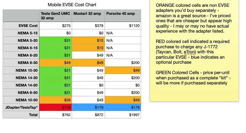

@Nevadagame what an excellent question:
given infrequency of use - and likely overnight @ hotel 32 amp vs. 40 amp is not likely to make the difference (since most road trips fast charging is the watch word of the day - and L2 charging is "overnight" @ the hotel)
if you were at 5% battery and plugged into 32 amp vs. 40 amp the charge time different @ the hotel would be:
95% of 83.4 kwh is 79.23 - let's call it 80 kWh
charge time for 80 kwh @ 32 amps - 7.68 kW - 10.5 hours - call it 11 hours
charge time for 80 kWh @ 40 amps - 9.6 kW - 8.5 hours - call it 9 hours
I recommend the Tesla mobile 32 amp charger for the following reasons
  1. price - $275 for a small, light, well made, well designed, rugged 32 amp EVSE is the best deal going in the EVSE community - seriously show me another mobile charger for $275 that is small compact and simply works so well
  2. the 32 amp mobile charger from Tesla has a wide range of adapters for most any plug you'll encounter - the 32 amp mobile charger has the following NEMA adapter available for purchase (it comes with a NEMA 14-50)
    1. 5-15 - 120 volt 15/12 amps
    2. 5-20 - 120 volts 20/16 amps
    3. 6-15 - 240 volts 15/12 amps
    4. 6-20 - 240 volts 20/16 amps
    5. 10-30 - 240 volts 30/24 amps
    6. 14-30 - 240 volts 30/25 amps
    7. 14-50 - 240 volts 50/40 amps (32 amp limit of EVSE)
    8. 6-50 - 240 volts (50/40 amps (32 amp limit of EVSE)
  3. The Tesla Mobile EVSE is much smaller and lighter than the Porsche model.
  4. the Tesla 40 amp Gen1 corded mobile EVSE is limited to NEMA 14-50 - but it's 40 amps, but it no longer has the NEMA adapters - it's a fixed 14-50 charger these days (it used to have it's own set of adatpers
  5. there are other non-Tesla mobile EVSEs - but none that I've seen match the quality, mobility, adaptability of the Tesla offering - and keep in mind the price of $275...
so for the "road warrior" kit - you have the following elements:
total is $734 w/Jdapter or $674 w/TeslaTap (you need one or the other not both) - or almost half the cost of the Porsche Mobel connect EVSE with more adapters than Porsche even offers or comes with…
also you honestly have to back out the cost of the JDapter - since for any serious EV road warrior you're going to have one of these regardless - because this lets you use Tesla L2 chargers at businesses and hotels and such…
so independent of the JDapter/Tesla-Tap - the total cost of the 32 amp Tesla Mobile EVSE w/7 NEMA plug adapters is $495.00 - or almost 1/3 of the Porsche charger.
A quick survey of Amazon - shows EVSE's range in price from $189 (16 amps) - $699 - and not all of those are "mobile" or even have plug adapters as an option..most aren't even 32 amps.
the closest competitor to the Tesla offering in terms of price and feature appears to be this one…
https://www.amazon.com/MAX-GREEN-Ou...1&keywords=40+amp+evse&qid=1590177764&sr=8-13
@ $279 w/5 adapters - but it's only 16 amps - not even 32 amps like the Tesla model.
no question 40 amps is better - but the question is given frequency of use and the likely use of fast chargers - the 32 amp options is worth considering in my opinion, but only as an informed purchase…also keep in mind with 7 adapters in play - only 2 of those adapters are 40 amps - the other 5 adapters are all far less than 40 amps, and not even 32 amps - so if you're using the adapters you aren't charging at 40 amps anyways…
I hope this helps - I won't tell you the 32 amp is ideal, but I'll state it's nice set of compromises for price, flexibility, portability and general utility. 40 amps would be better, but I don't have a product that is as good on price or flexibility or mobility in mind or that I've found.
The Porsche product is a great product and excellent EVSE and oozes quality - but it's price point of about $1300 before any adapters - and it's weight/size make it less desirable than mobile alternatives - but there is NOTHING wrong with the Porsche charger, and given how infrequently you will actually use a mobile EVSE on the road - it's really NO problem to simply pack the Porsche charger only when you Tavel, and let it live in the garage the other 98% of the year…

new plug adatper - NEMA 10-50
here is the NEMA 10-50 to 6-50 adapter on amazon $39
https://smile.amazon.com/NEMA-10-50P...217743&sr=8-10
in 7 years I’ve never encountered 10-50 plug on the west coast of the US…but this would work for any EVSE with 6-50 plug adatper - and no special instructions because the amps are the same - this is the simplest of adatpers.
I’m not recomending it - but it’s a plug type that was not previously covered...listed here for completeness.
