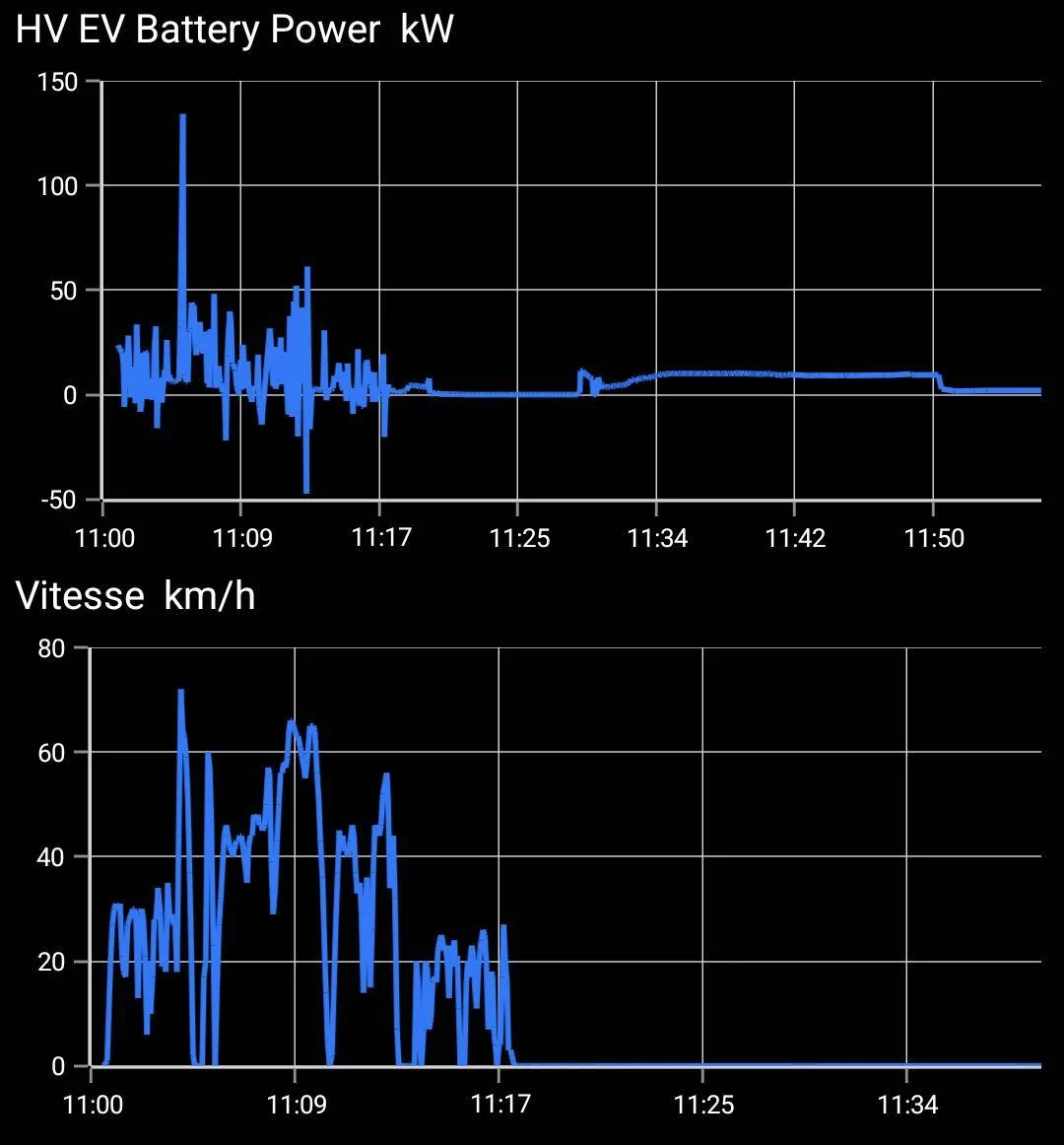

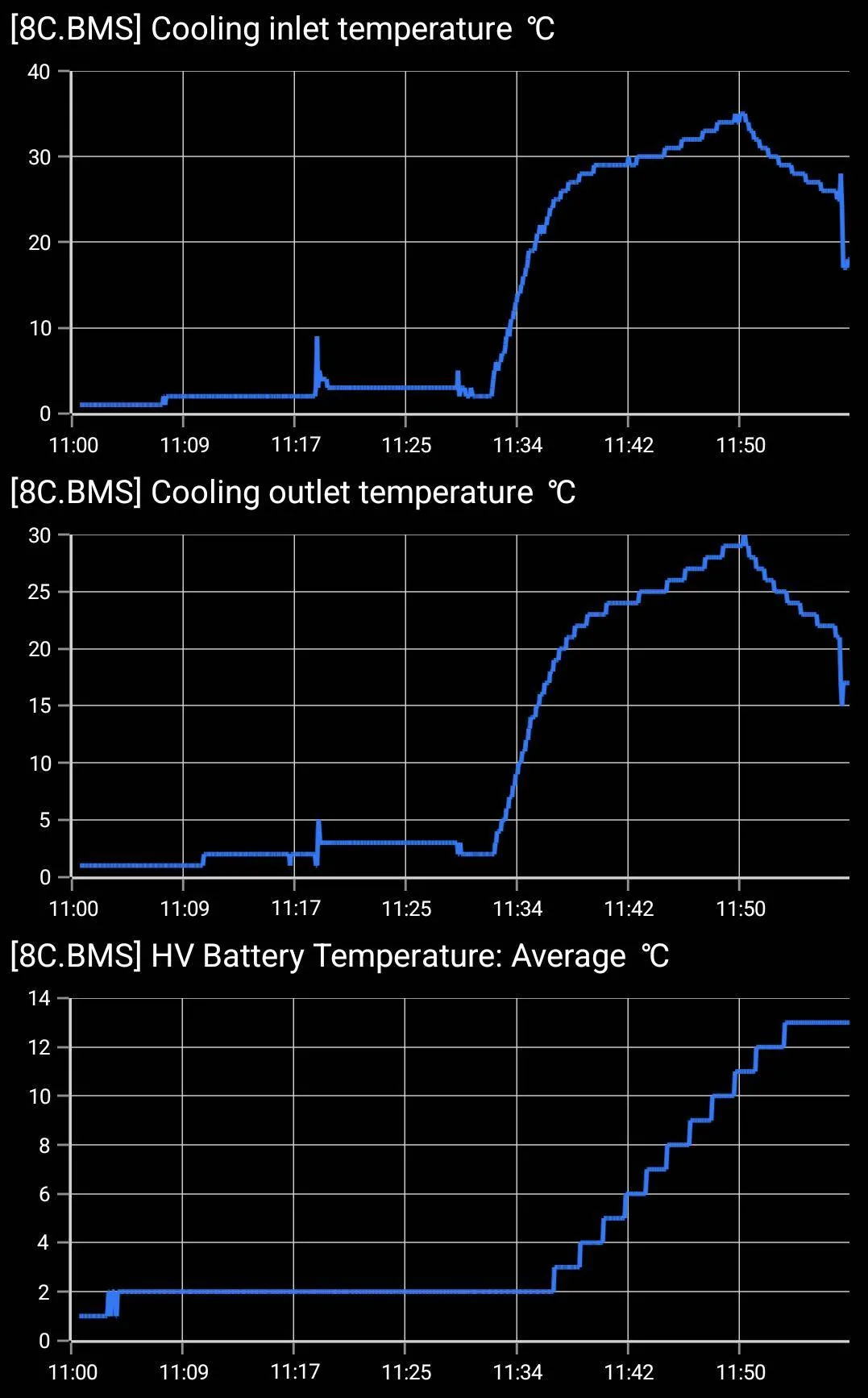

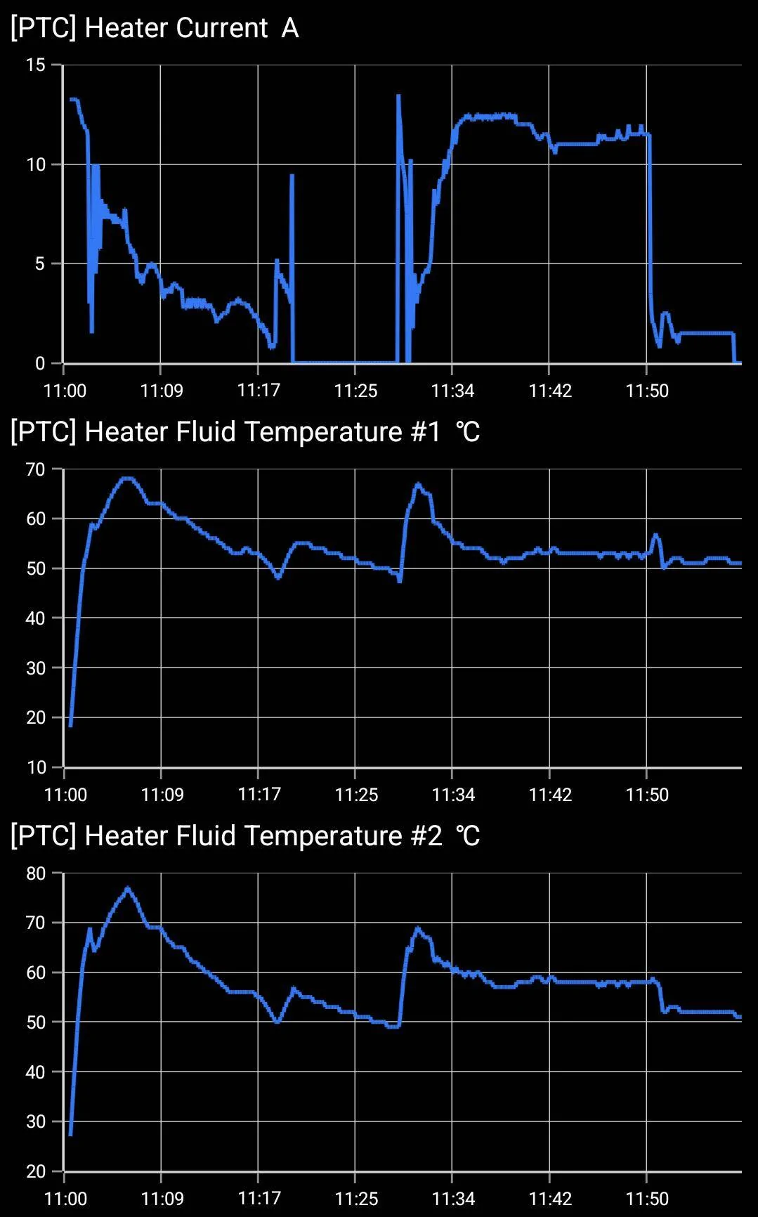

I did (another...) test this morning :
- outside temp about 3°. car stayed outside all night, unplugged.
- drove the car for about 15 mn (no pre-heating),
- shutdown the car for about 10 mn,
- started pre-heating for about 20 mn
Porsche Taycan Extreme Winter Driving pros and cons with Taycan 01
observations:
- heater will instantly heat the heater fluid used to heat the cabin. it'll go from 12A (seems to be the maximum) down to 5A and less when the heater fluid reaches 80° (max. temp ?) after 5 or 6 mn. goes down to 0 when car is shut down....
Porsche Taycan Extreme Winter Driving pros and cons with Taycan 02
....however the BMS cooling inlet (warming in this case) fluid is not heated at all during driving (-> 11:17). Battery temp. remains at 2°. Only when starting the pre-heat (11:30) fluid is warming up to 35°, heater goes up to 12A, and battery temp increases up to 13° (max.)
Porsche Taycan Extreme Winter Driving pros and cons with Taycan 03
I should try again in Sport Plus mode, but temp will go up to 10° today and next days, i'll have to wait another cold wave :(

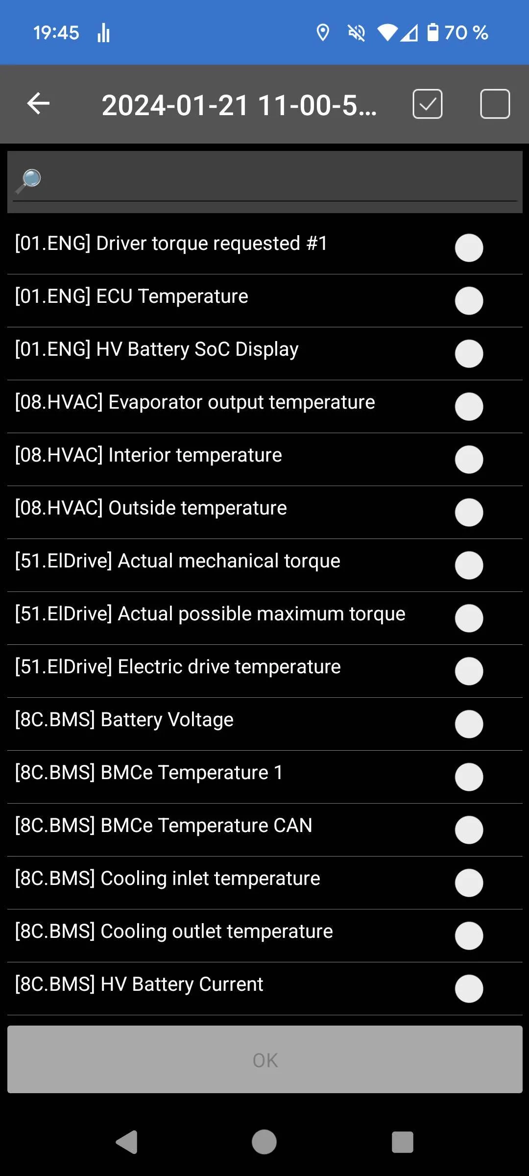

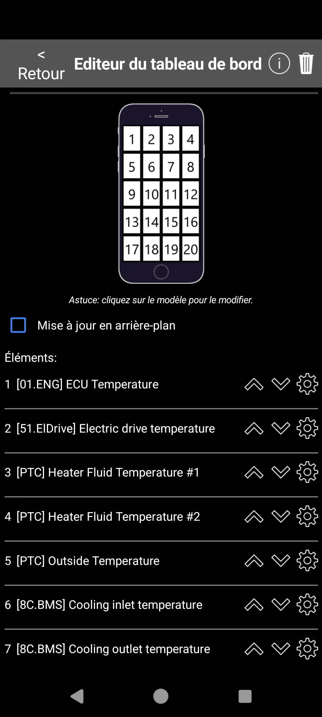

@Gru , nice diagrams of the Battery heating etc! Did you configure this in CarScanner?
yes.
you can create pages with the parameters you'd like to monitor.
once done with the measurements, you can go to your dataset and select the parameters you want to display in one or several diagrams.

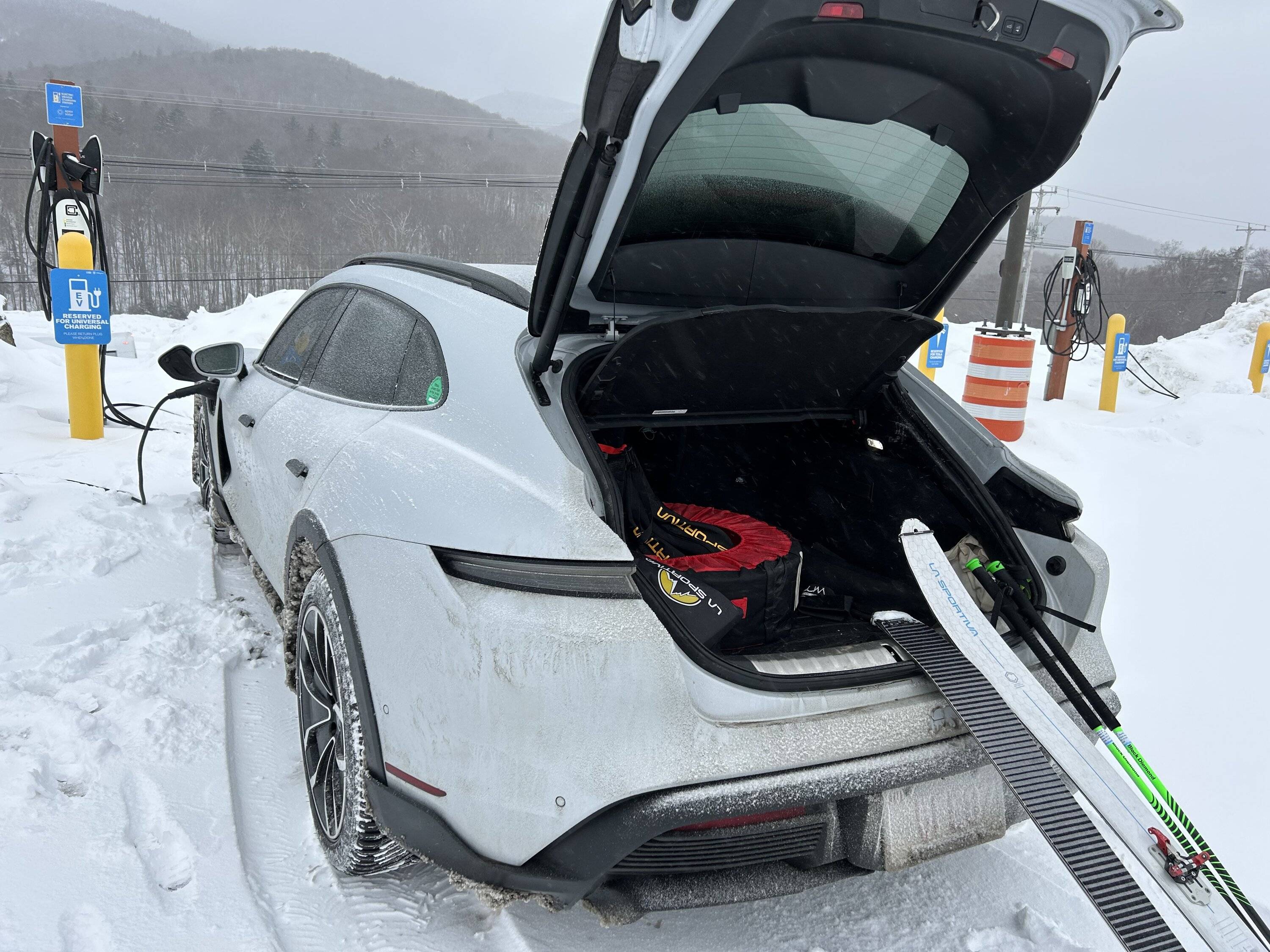

Parked my CT early Wednesday morning at the ski resort for free charging ($20 worth at my home electricity prices), then headed off into the backcountry.
Emerged from the woods almost nine hours later to discover that what had been dry weather under the tree canopy was a freezing mist out in the open.
Walked past someone in the nearly dark and almost deserted parking lot chipping ice off his windshield.
My clothing was now shellacked, my fingers numb.
Arrived at my Taycan to find that the cabin heating I had activated on the app while still in the backcountry (excellent reception!) had cleared the windshield.
Removed my snow-caked ski boots and wet soft shell jacket inside the ~85F degree car with the seat heaters set to Incinerate.
(Oh, and of course the CT with CC2 tires handled wonderfully on the snow-covered roads during the pre-dawn drive. During the evening, steady rain as the temperature slowly rose during my drive home from 31F to 34F, but fortunately the extensive salting and steady traffic prevented any black ice from forming, so glad to say I unable to report on how the Taycan deal with ice!)

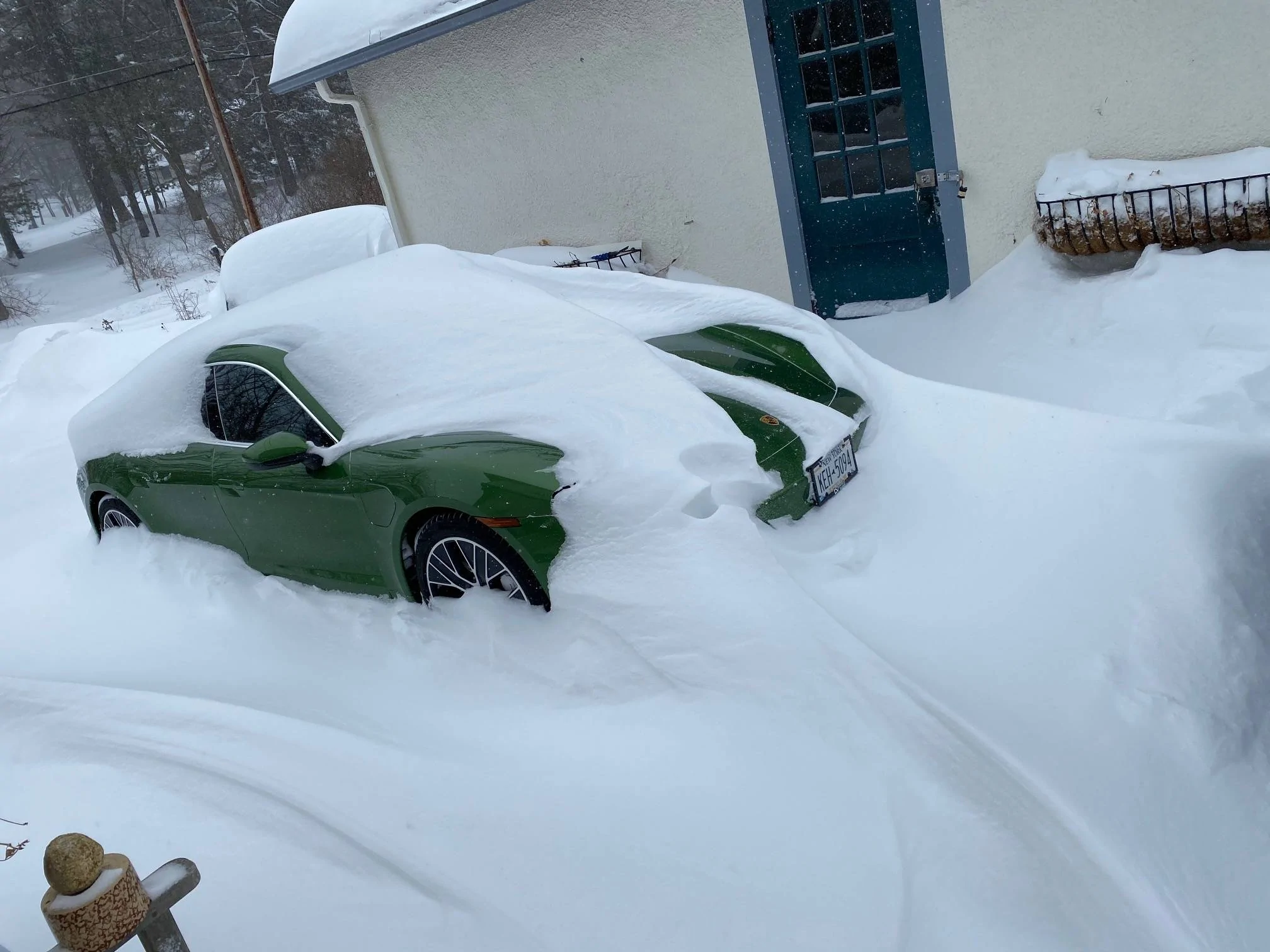

It's so great to see Taaycans well used in extreme weather
Porsche Taycan Extreme Winter Driving pros and cons with Taycan Snowed in
KLHubb
Kent
Jan 15, 2024
257
195
New York
^ Ooh, especially love seeing what I think of as a Miami color buried under snow!
Yes, Mamba Green metallic looks great in a snow drift....I dust it off each morning and drive off to the play in the snow. It is a great winter car..
