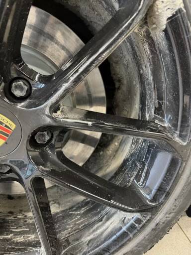

I am also based in eastern Canada and agree the CT handles very well on snow and gravel, but be warned after a couple days of driving to the ski hill etc the build up of snow and dirt is substantial.
I neglected to jet wash my wheels after a few trips and my wheels became very unbalanced. I had to reduce my speed to 50km/hr. The air suspension tried to level things but could not cope and eventually the warning came on Chassis defect drive to the work shop at reduced speed.
The dealer found that the rear right shock was defective and needed to be replaced, which would take two weeks as the part comes from Germany. Apparently the build up was primarily in the rear right wheel, see attached picture of the dirt from a single wheel.
So clean your wheels if you frequent dusty or snowy environments, also there are heating vents in the wheel arches that need to be hosed out when washing the car.

Good advice.
I didn't realize there are heating vents in the wheel arches. Can you attach a photo or describe where they are. I have had snow buildup in the wheel arches in heavy wet snow.
