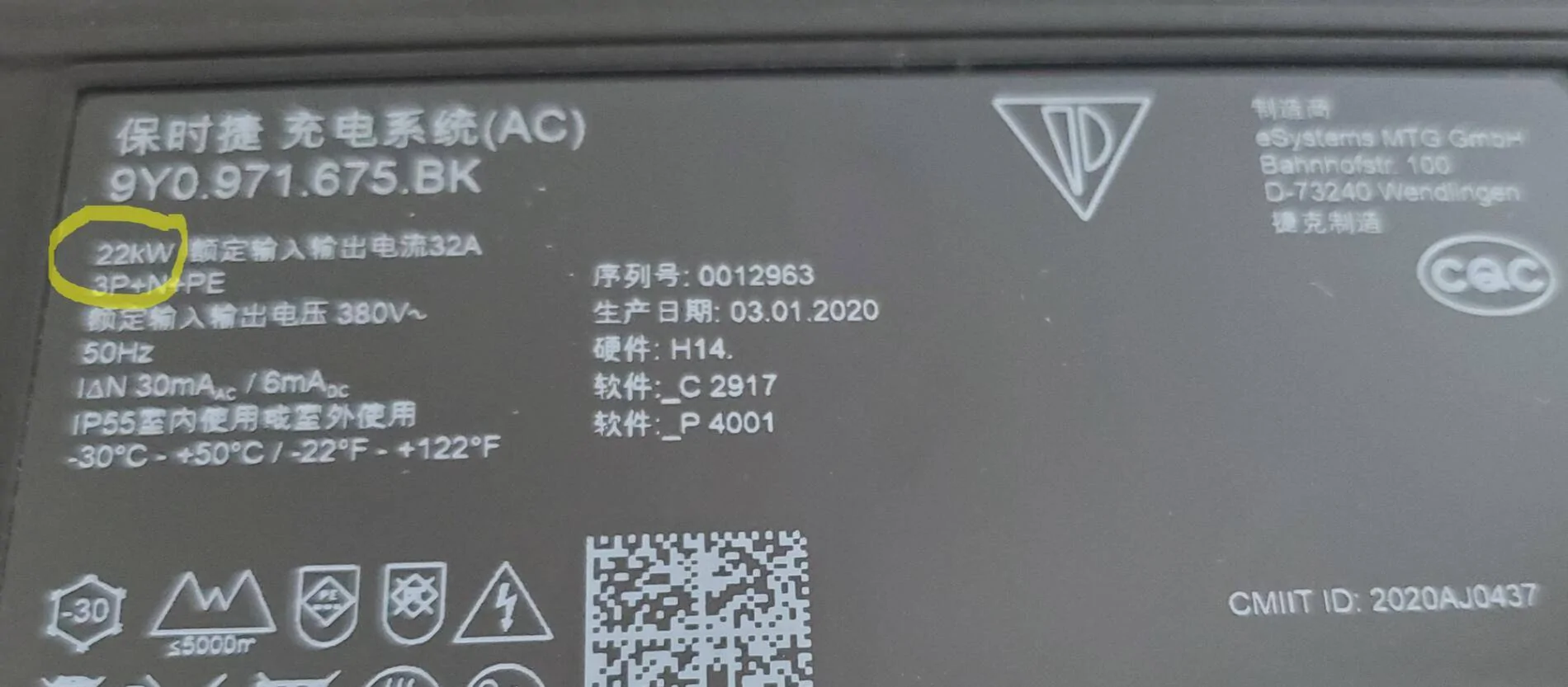

Could the car even charge at higher rate, i.e. 22kW with the right charger?

No, the max rate of charge on AC is 11KW currently, this is restricted by the fact that the car is fitted with a 11KW AC convertor to DC. I have the PMCC connected to 3 64AMp supplies, the charger says output of 22KW, so future proofed for when there is a upgrade (unlikely) or I get a new one in a few years time.

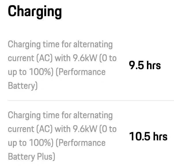

What's the Deal with 9.6 kW vs. 11. kW charging?
  1. in non-North American markets Porsche documents the maximum on board L2 charge rate as 11 kW maximum charge rate.
  2. at 240 volts 11,000 watts - 11 kiloWatts - 11 kW - requires 48 amps of electrical current - this universally true and does not vary by region/market
  3. for the North American Market Porsche documents the maximum charge rate of the Taycan as 9.6 kW (40 amps @ 240 volts)
    1. see here: https://www.porsche.com/usa/models/taycan/taycan-models/taycan-4s/
    2. Porsche Taycan Factual Report: just data - 11 kW charge rate Screen Shot 2020-08-30 at 10.17.49 AM

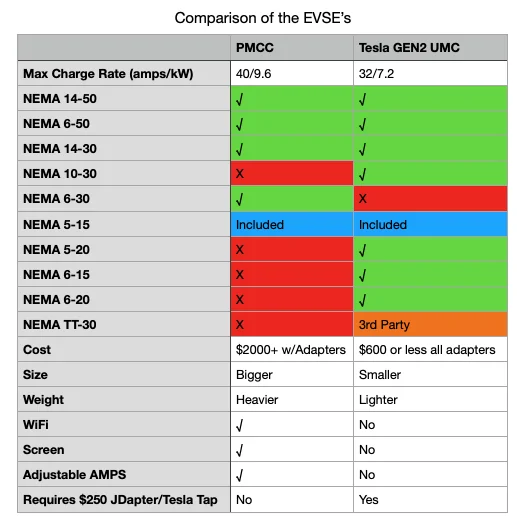

Is the PMCC as good as the Tesla Gen2 mobile charger?
hmm - as good - I"ll say different - here is a comparison table - I consider the Tesla charger a "better" mobile charger - but it is lacking some features of the PMCC - so it all depends what features of the two products you value.
I wouldn't say one is better - they have different capabilities.
Porsche Taycan Factual Report: just data - 11 kW charge rate Screen Shot 2020-08-30 at 12.03.22 PM
