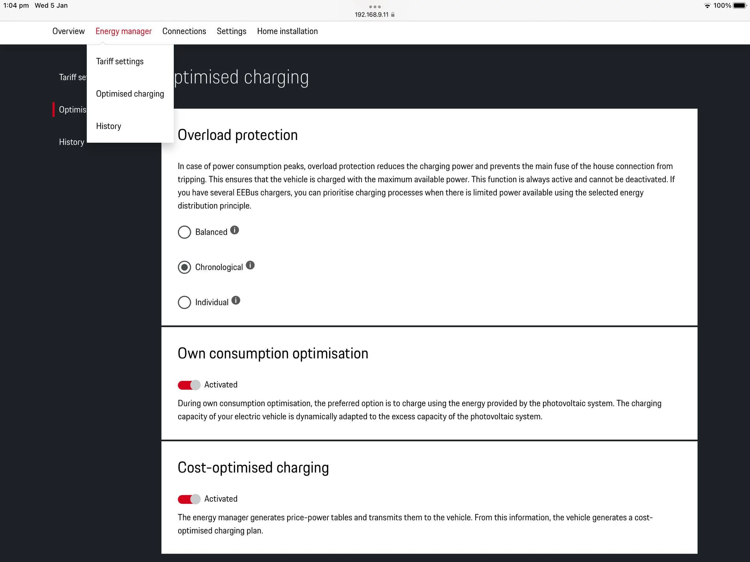

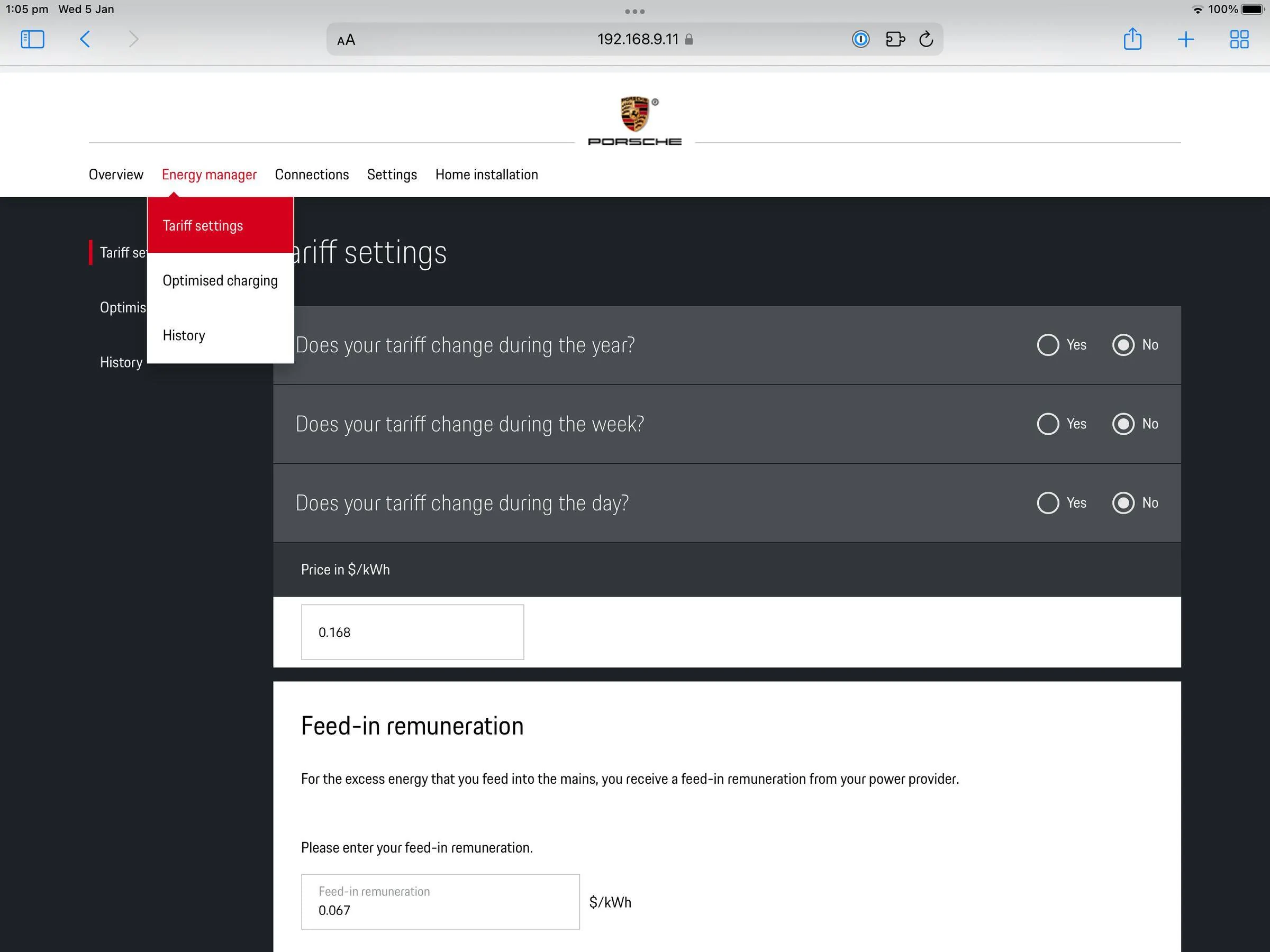

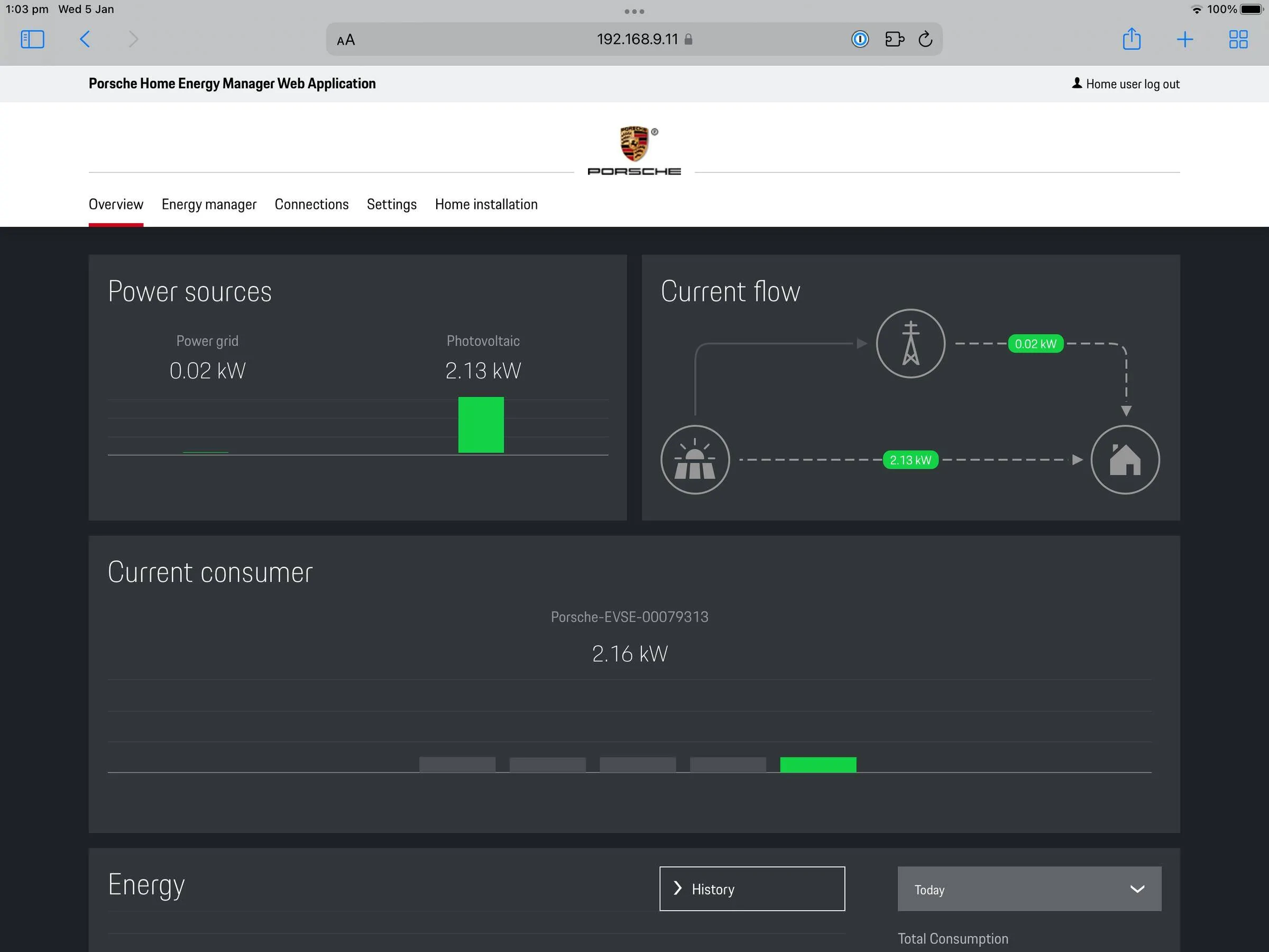

Hi Andreas - these are some of the settings. Hope it helps!
cheers
craig
