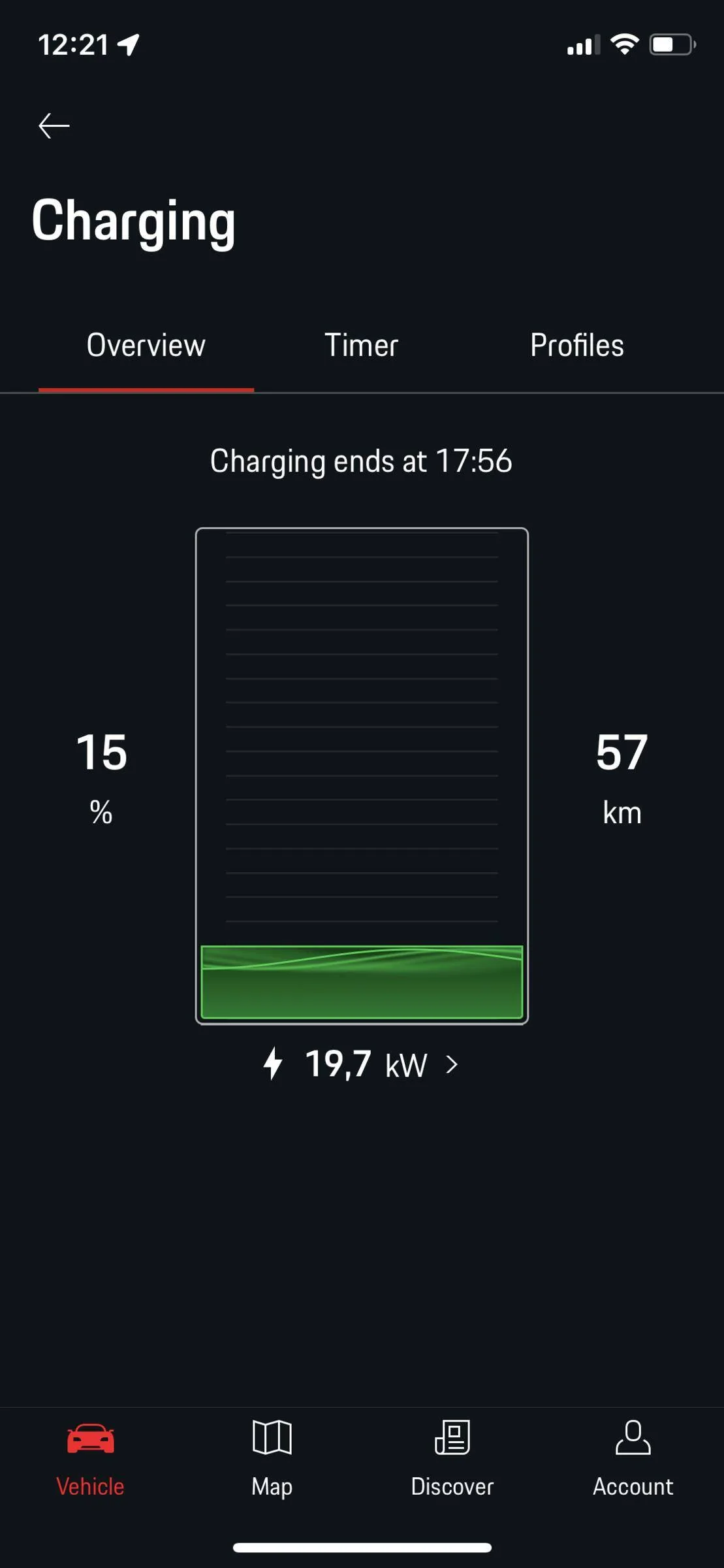

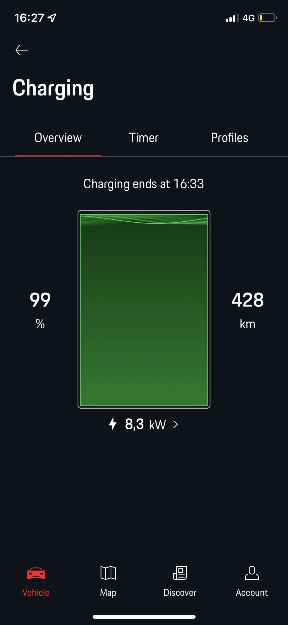

This is my experience with RWD PB+ after 1500 km / 11 days.
To keep it short and useful, my general consumption is 20-24 kW/100km depending on driving style, not speed. I feel like this car likes to sit at 120-140 km/h with 22 kW/100km consumption and yet showing me ranges of 420 km on these cold days (0* C) which seems reliable (with battery temp >15*C), after 350 km still showing me 57 km car on NORMAL mode with everything on.
Keep in mind that the battery had started with >15* C.
When the battery is really cold (0-5* C), range drops significantly. From ~400km down to 300km easily. This morning I started with 65% and showing me 240km of range with 5* C temp of battery. If you have a garage, I highly suggest you park it there, it wil help with range because it's not wasting energy on getting the battery at normal temp. Also, I found out that driving it spiritedly on SPORT PLUS really helps. Or you can enter in the PCM the nearest fast charger.
PCM Navigation is really good in my opinion. It shows ±1% estimated range figures, useful to have it in the instrument cluster.
About the car, I won't waste time telling you that is amazing. My Porsche app works fine for preheating, showing charging, but I can't get the profiles to work. It pauses and never starts, and when it eventually starts it's giving me the good ol' "charging error". Any tips on that?
