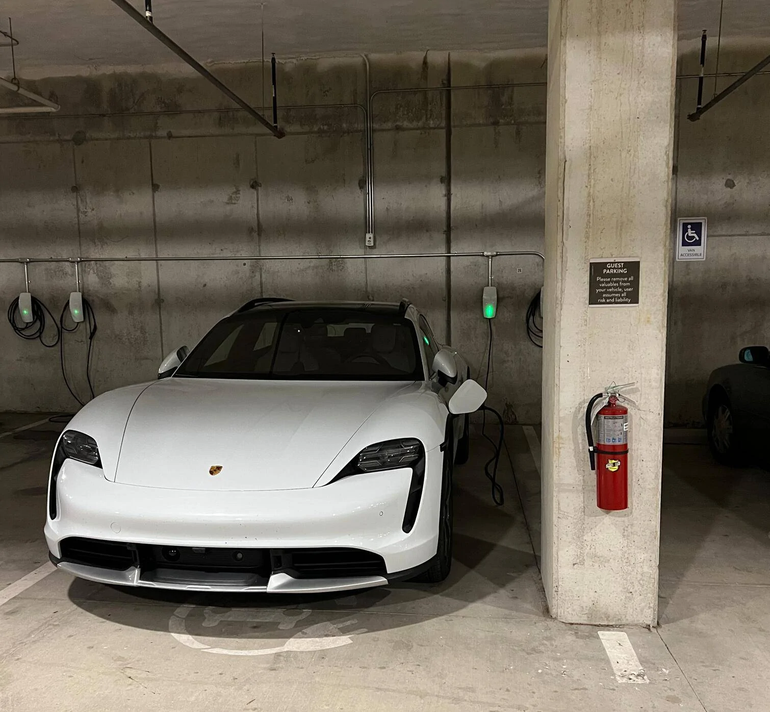

Check for Tesla destination charging. I just did a 3,500 mile trip across the USA and found that there are a lot more hotels with Tesla chargers than J1772. You can use a Tesla destination charger with an adapter, such as TeslaTap (make sure you get 80A version if you have 19.2KW charger in your Taycan, or 60A version for regular Taycan which will top out at 48A). Here is mine charging at one of the hotels on my trip.
Porsche Taycan First (and maybe last) Freezing Weather Road Trip 1677749851474
