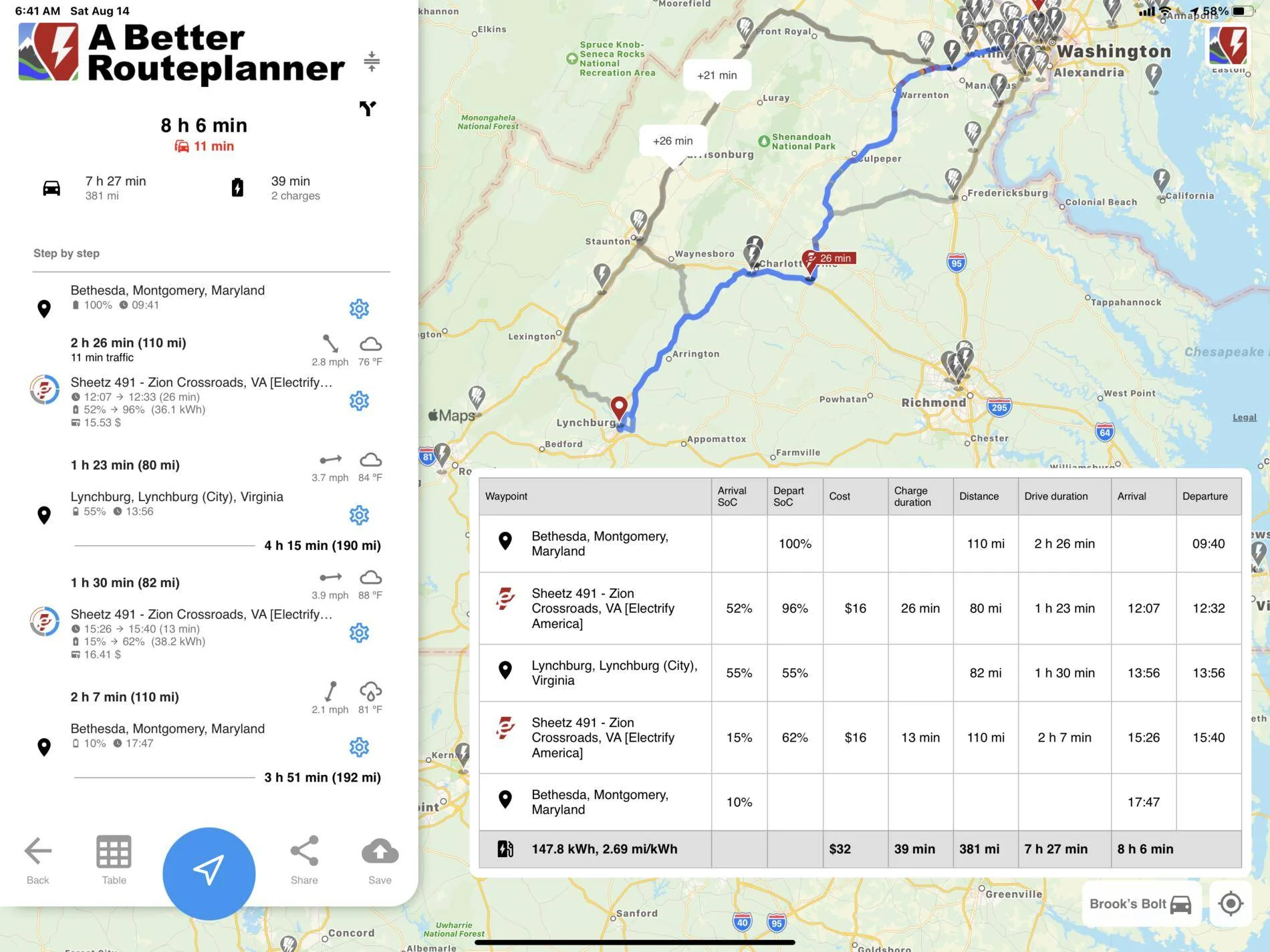

here for example is a 178 mile (one way) trip from Bethesda, MD to Lynchburg, VA (178 miles one way - I picked a random location about 175 miles one way - your trip will be different) - A better route planner suggest two stops @ Electrify America Zion Cross Road…and you’ll return to where you started with 10% battery if you followed this plan - 1 stop on the way there- and 1 stop on the way back for this hypothetical trip.
the trip breaks down as follows:
  • Bethesda —-> Zion CrossRoads EA Chargers - 100% to 52%
  • 26 min stop @ Zion - 52% to 96% charging stop
  • Zion —> Lynchburg - 96% to 55%
  • arrive - hang out - charge slowly for an hour or so - pick up 8% battery - now start the return trip
  • Lynchburg —> Zion - 55% to 15%
  • 13 min stop @ Zion - 15% to 62% charging stop
  • Zion —> Bethesda - 62% to 10%
  • 39 min total charging time
  • total trip time 8 hours 6 minutes
Porsche Taycan First EV Road Trip Tomorrow - Tips? C362785F-E823-4F96-BEA7-307DD20C30EC
if you use the Porsche Connect app or Charging NA app you can activate your included “free” 30 min charging sessions @ Electrify America so the charging session won’t cost you anything.
plugshare - says the Zion Crossroads EA chargers have a reliabillty rating of 10 out of 10 - that means no one has checked in recently and been unable to charge - so the likely hood of charging snafu is low - you can most likely rely on those chargers to be working, but occassionally EA takes chargers offline for maintanence so check with EA app to make sure chargers are “functional” prior to departure - if they are down - find another charging stop along the route.

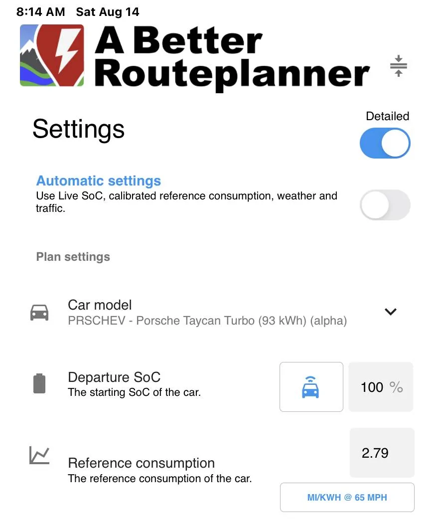

Just be aware the ABRP app assumes your car can only do the EPA given mileage of 200 miles range, so it will have your stopping more often than you should and the estimates for your power remaining at each stop will be lower in the app than what you really will have on your car.
ABRP can be “adjusted” to more realistic consumption metrics which it will then use to generate better estimates as to when/where to stop - the setting is here in this screen shot - is the “reference consumption” setting - and I’m comfortable putting in 2.95-3.2 mile/kWh for Taycan Turbo - this will greatly improve ABRP’s trip planning and move the plan closer to actual Taycan consumption values.
however - if ABRP says you can make it with the less efficient consumption value then we know we’re good to go with plenty of head room - and it’s still useful to quickly “find/sort” possible/likely charging locations and then you can make your own plan from there.
I use ABRP to “cheat” and quickly find the “likely” spots to stop - I then overrule it and make my own decisions before I leave and enroute - but it does the initial “legwork” of the basic outline and estimating consumption - it’s a cheat to get your planning started…
