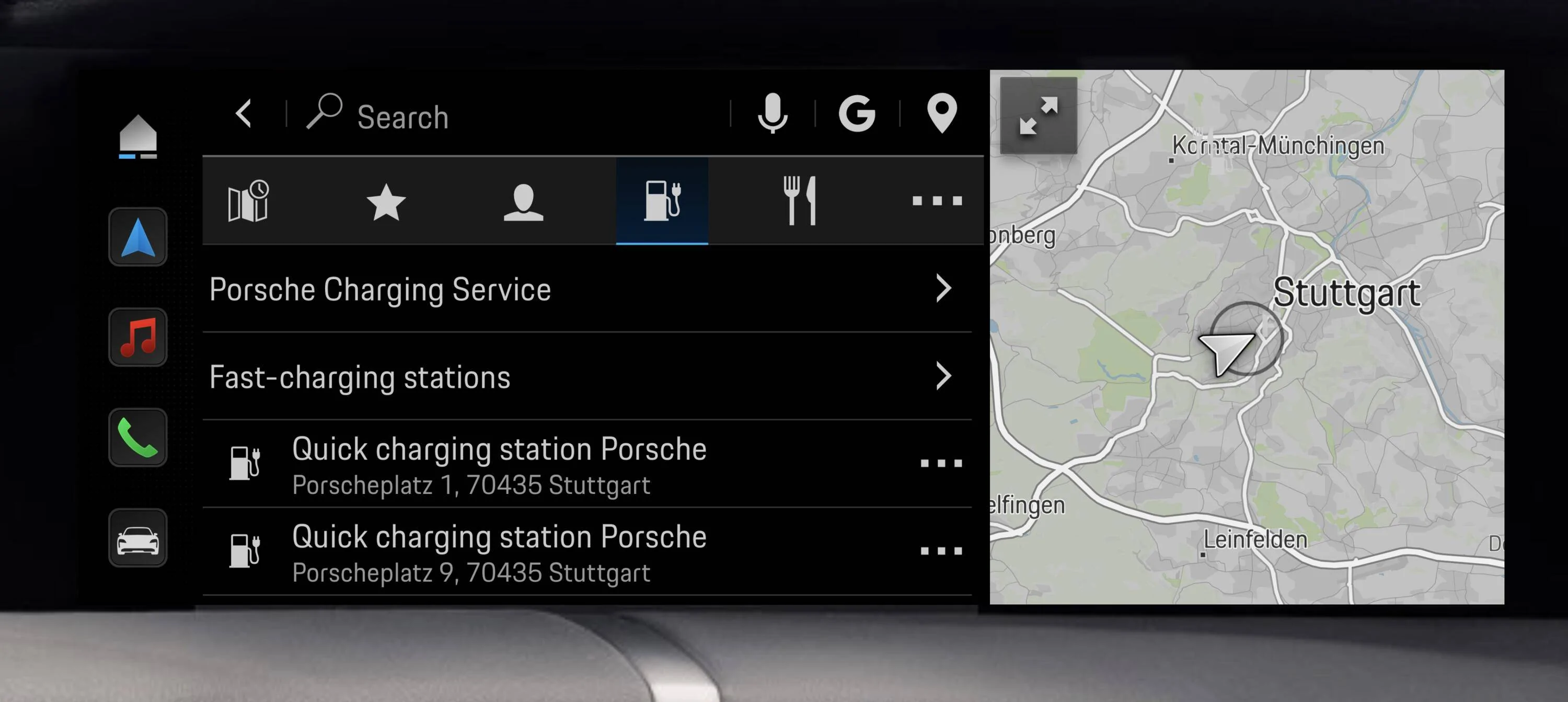

So, my question is, when setting off on a simple journey, and you know exactly which charger you want to use, how do you force the car to stop there?
This is my number one bug-bear with the PCM navigation at this stage. Why can't I just mark any arbitrary stop as a charging point and have battery pre-conditioning occur?
Anyways, to answer your questions, the way I achieve what you want is with one subtle difference to your otherwise correct steps/sequence.
When looking for the IONITY stop that you want to charge with, make sure you are doing it via the "fuel filter" option, as such:
Porsche Taycan First Long-Distance Trip In My 3-Week-Old Taycan RWD Screenshot 2022-12-19 at 20.04.31
So just select that fuel filter and then do the same text search as you'd normally do. When the IONITY stop shows up, select it as a waypoint and the car will defo know its a charging stop.
Sometimes (normally) the car knows this from a normal waypoint search, but sometimes – as you've discovered – it doesn't realise the waypoint (even though it says IONITY) is an actual charging station.
I don't know why – but my step above should prevent it happening again for you.

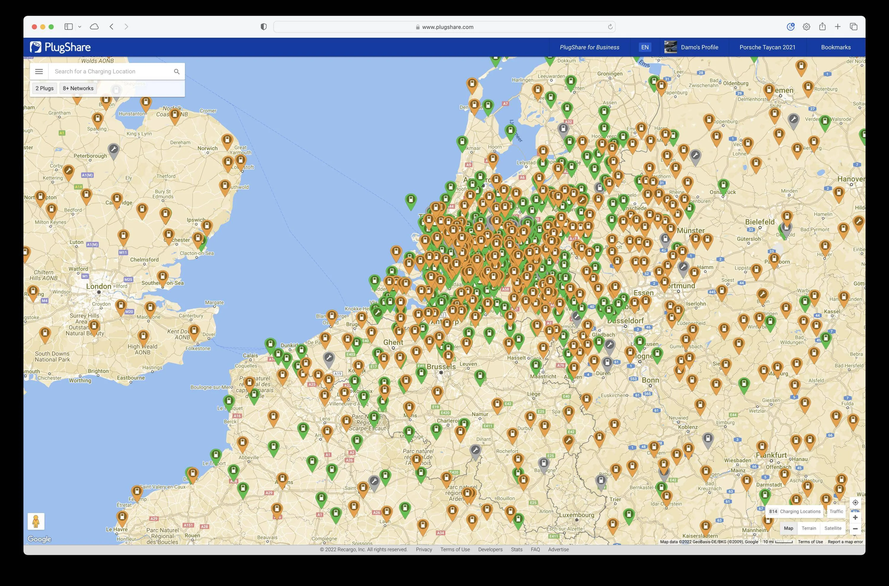

The charger density of the Netherlands looks nuts compared to surrounding countries – I guess matching population. Though looks a little weaker up near Groningen – ironically where I'm aiming for!
