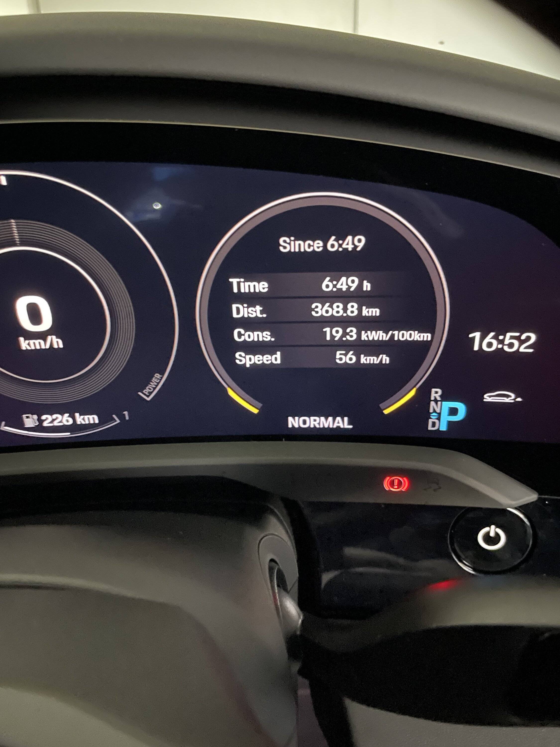

Taycan2023y
Sandeep
Sep 30, 2022
78
36
Australia
Porsche Taycan First long distance trip range IMG_2704
Drive mode sports plus/sports. Electric sport sound on heated seats on. Driving through mountain ranges. 19.3kwh. 368.8 travelled.
