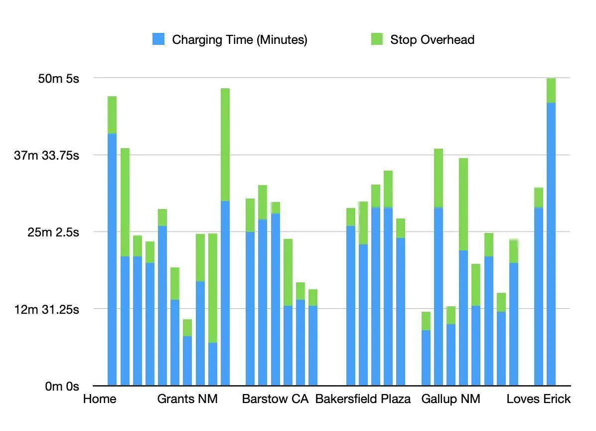

Next year I need to dive 2000 miles to LA and afraid I am going to need to stop every 100 miles to get charged up...not a good feeling
I drove 4000 miles round trip from Dallas to NorCal and back.
Here were my stops and the times with associated overhead.
I found myself looking forward to each stop. Some of them had a lot of "overhead" (shown in green) due to switching from broken pumps, waiting my turn, etc.
