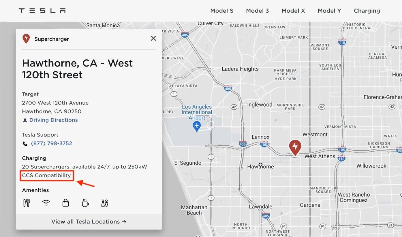

Apologies for the dumb question to hopefully be Taycan owner in May. What is preventing us with CSS to charge at Tesla chargers and superchargers using the adapter. I assume that the charger must identify the car as a Tesla in order to allow charging, is that correct?

Tesla super chargers are connected to a server on the back end that will verify vehicle VIN before beginning to charge.
Also, there is no acceptable Tesla to CCS adapter for high speed charging available as of yet that I know of. The TeslaTap or similar adaptors are for lower charge speed destination chargers.
130
4,432
6,548
Taycan, Cayenne Hybrid, 911(s) GT3/Convertable
+1 for this post
but it confuses me why people think the TeslaTap would work - if you just look at the TeslaTap it has _NO_ connectors for the fastDC pins on a CCS port - there is no way it would ever work.
what is stopping all CCS vehicles from using Supercharger network in North America is:
  • lack of an authorized physical adapter for the different shape plugs
    • protocol compatibility - once you have the physical plug issue dealt with you now have to have both the supercharger and the vehicle "speak" CCS - this is likely a software issue
  • lack of any physical hardware changes required to all existing superchargers in North America
    • roll out plan is unclear - will Tesla retrofit all superchargers? some? most? few? only-new locations? Urban? V1? V2? V3?
  • [plausible] lack of final software updates for the superchargers to recognize/support CCS vehicles - this is an internal roll out issue for Tesla
  • lack of the feature being "enabled" on the Supercharger's back end servers.
  • lack of enabled support for a non-Tesla to begin a charging session - likely scenario is that you'll use the Tesla app w/Tesla account to start/stop supercharging for non-Tesla's
  • there are probably more issues, but the list above is most likely the major issues
all that being said this is coming - but it will take time.

There is no physical stall that has the magic docket yet.

It’s a bit simpler with ā€˜public’ Tesla SuC over here in UK and Europe…
Authorisation is done using the Tesla app. You just input what stall/tombstone you’re at and away you go.
The SuC sites that have been opened up here are all V3 so they have just one CCS2 tethered cable that runs up to 250kW @ 400V.
If I’m charging my T at a V3 site I use a Tesla supplied CCS2 adapter - even though that’s effectively the de facto standard now - when my car was built 2017, the car only had a Tesla specific Mennekes Type 2 connector.
I’d doubt there’ll be any insolvable issues stateside and Canada - the hardest is convincing the dyed in the wool Teslarati you’re not an enemy of the state plugging in there šŸ˜…

What I find interesting here is that this supercharger station is about 2 miles from the SpaceX HQ and the Tesla design center in Hawthorne. I wonder if the Tesla engineers in Hawthorne are doing some testing with non-Tesla EVs.

There's been a lot of discussion about this Magic Dock thing and cable length. Anything less than 4 extended length CCS cables per station will result in mayhem and a very bad look for Tesla. Hopefully they are smart about this.

No Tesla supechargers have a CCS adapter and there are no CCS adapters out there on the market that would work for Tesla fast charging, and if you see one advertised its a scam because there is no way for the Tesla chargers to handshake with the car and approve a charging session if Tesla hasn't even set up that capability yet. Is the Tesla charger just going to go "oh weird i dont recognize this car, eh have juice anyways why not ill just charge Elon's credit card" obviously not.
This move was done simply to get government funding to expand the network. I highly doubt Tesla is going to spend the time/money to retrofit the thousands of current supercharger stalls across north america for full CCS capability.

Not really a wishlist, just the minimum viable design.
A Taycan (or any front fender chargeport vehicle) will only reach if parked perpendicular to the typical back-in spaces, thus blocking other chargers. Lack of a standardized charge port location was a huge miss on the part of automakers.
If they're going to "open the network" as Elon said, they should be implementing the double cables as they are doing overseas. One charger per station will not be well received.
