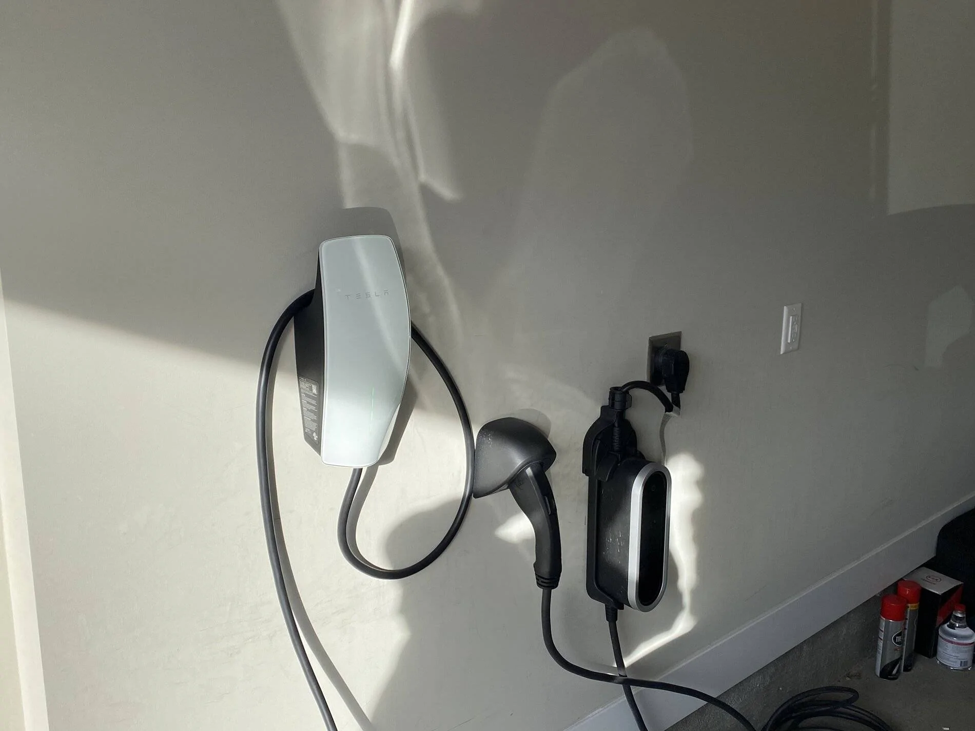

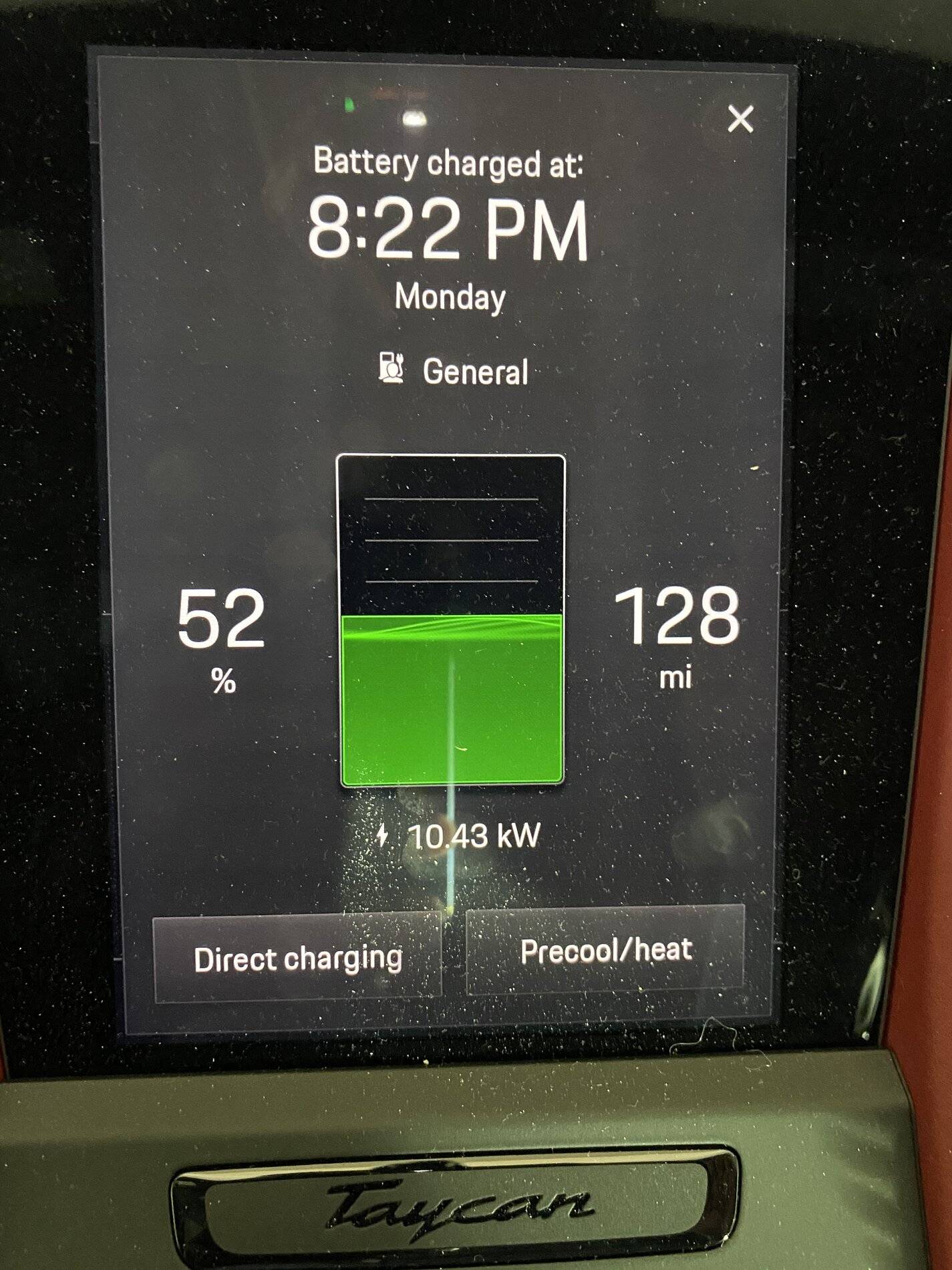

I installed a Tesla Gen 3 wall charger along with my NEMA 14-50 outlet and Porsche Mobile Connect and now have both 48amp and 40amp charging available for two EV’s. The charge speed with the Tesla wall unit and Tesla Tap adapter for the CCS plug on the Taycan was 10.43kW, I was getting around 8.5kW with the Porsche Mobile Connect at 40 amps. Mainly upgraded to be able to charge Tesla Model Y, Taycan, and future Rivian SUV all quickly and at least two at the same time. If anyone has a Tesla wall charger, it works great with your Taycan and the Tesla Tap adapter. Thanks to the posts from other forum members for this info., very helpful!
