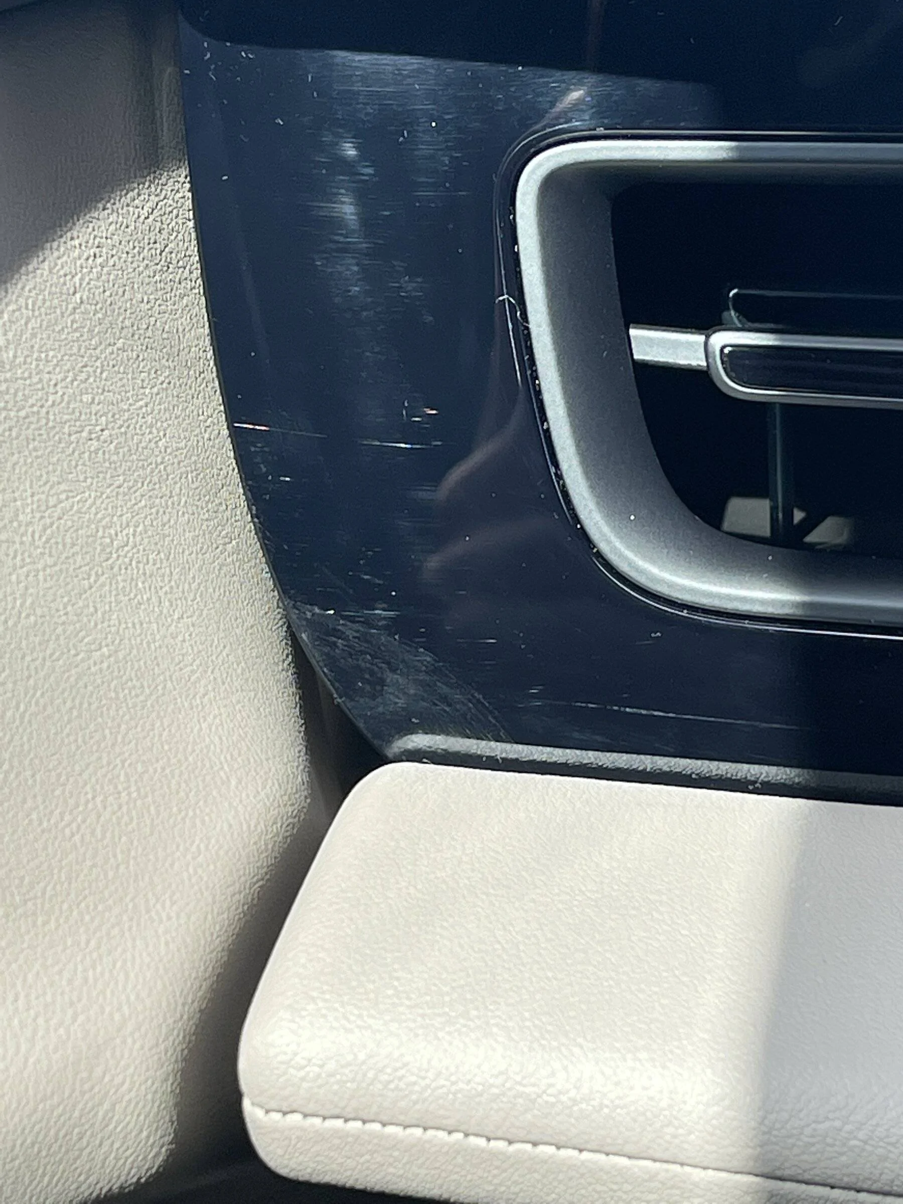

Took delivery of my Taycan right before the new year. Noticing now in certain light that the glossy black dash board has quite a few scratches on it most like from the factory. Anything I can do to repaint/ fix this?
Sorry, man. Probably a dumb question but is there a protective film that comes from the factory to protect the finish that maybe wasn’t peeled off during the PDI? It kind of looks like there could be one in that pic.

Just get it wrapped with XPEL. Any installer can do it. All scratches will disappear.
This. Or plastic polish should take care of it.
Warranty claim is worth a shot if you can assert they were present when you took delivery.
Pretty poor quality IMHO and a poor choice of materials for what is a premium car.

I have just very successfully removed the scrathes from the black gloss panel above the glove box using SONAX PROFILINE Perfectfinish - High Gloss Polish for Slightly Scratched or Pre-polished Paintwork. Took 2 minutes polishing by hand using a very soft cloth. :like:
