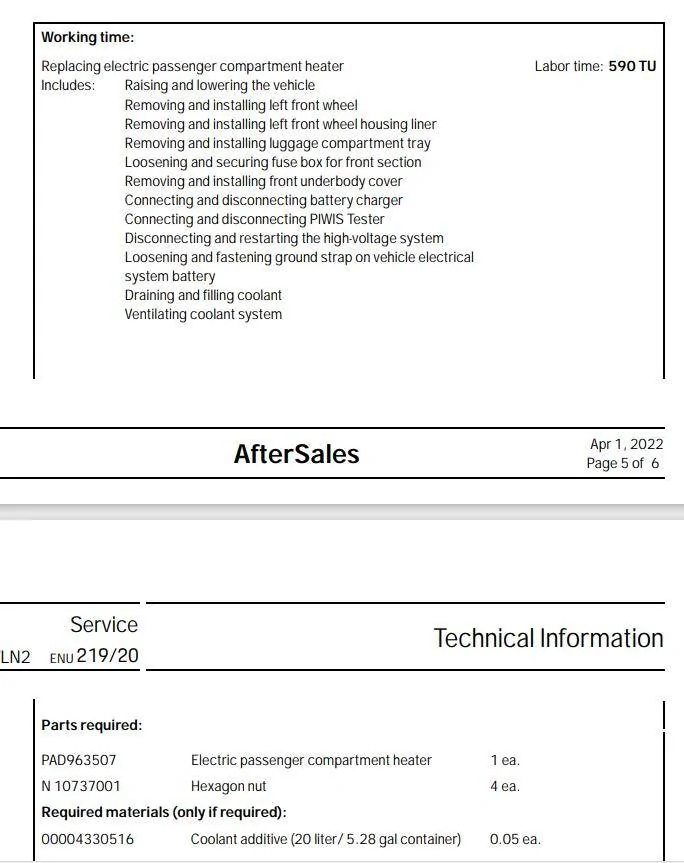

Thanks for the hours estimate, good to know!
Although that estimate is for cabin heater. Seems like my fix is for a separate HV battery heater?
It's the same.

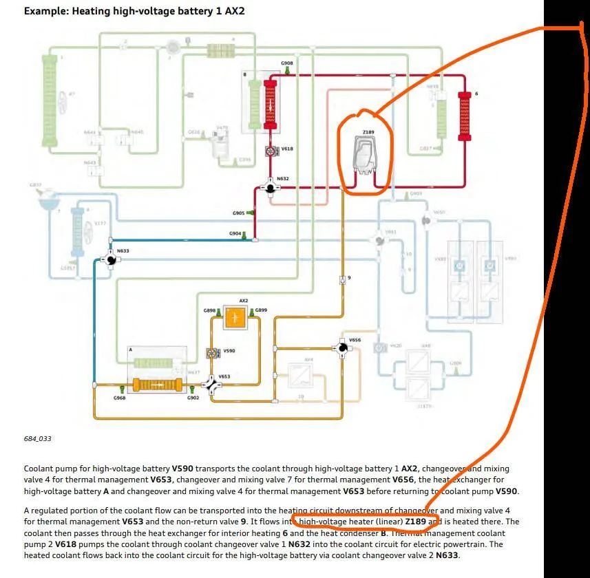

Whoops, silly me -- I was so focused on getting down low to the garage floor to see the sticker with the tire pressures that I missed the sticker higher up: September 2021.
So my required fix is just the same heater as this infamous one:
https://www.taycanforum.com/forum/threads/heater-broken-my-turn.13788/
The email's emphasis on the battery made me think it was something different.
Oh well, best to get it replaced ahead of failure, and also (I hope) in the same day.

Took them longer than a day when they fixed my car.
At ~6hrs as per the previously linked doc, seems like you have a decent chance of it fitting it in a day, but also any surprises or scheduling issues and you're looking at it spilling into the next day.
