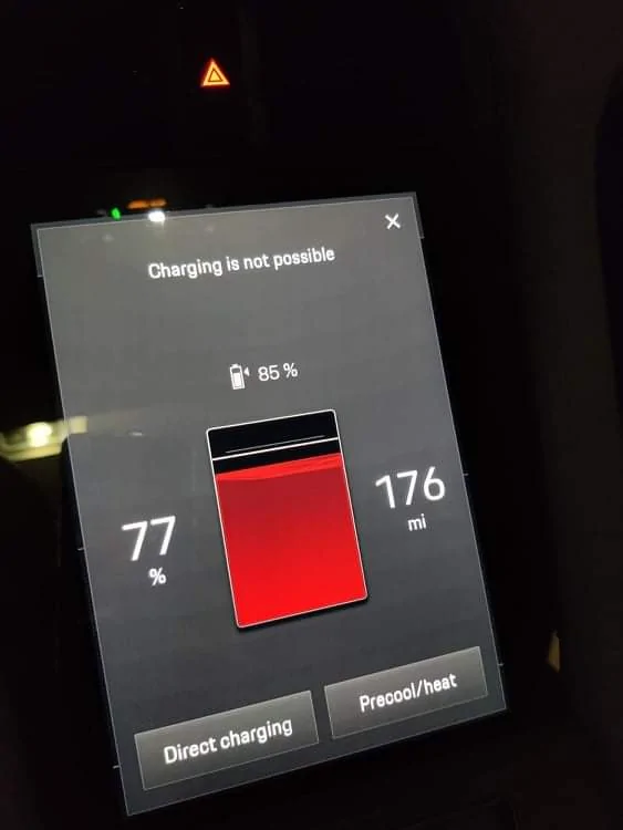

So I learned that a timed charging program on my wall mounted level 2 charger & a time charging program in the car, do NOT PLAY WELL together.
Porsche Taycan Fun with timed charging programs... received_153929216949970
Since the programming of timed charging on the Taycan is a convoluted mess using customized charging profiles & a separate timer feature. until I figured out how to do that I was using the programmable function on my Wallbox lvl 2 charger to start charging at night once plugged in.
Porsche Taycan Fun with timed charging programs... received_244828561083868
I spent some time on the Taycan forums puzzling out how to set the cars customized charging profiles (way more complex than it needs to be) and once I set that up I forgot about my Wallbox timed program. So once I plugged in the car I get an angry red ring of death followed by this error msg
Porsche Taycan Fun with timed charging programs... received_928082811160105

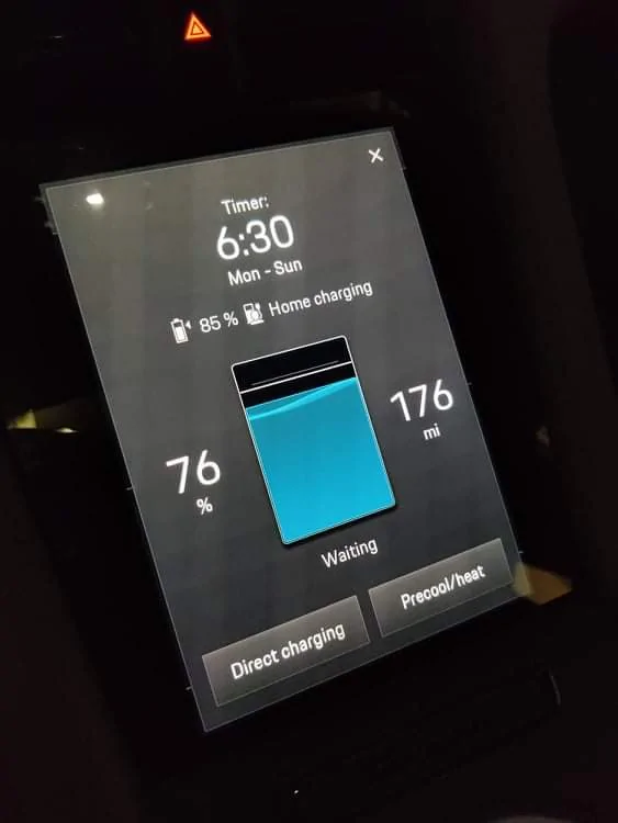

After panicking for a bit that I already broke something on the car, after some pointless troubleshooting I realized the timed program on the wall charger, not due to provide charge until 10pm, basically looked like a 'broken charger' to the car (while it had its own timed program activated) when they tried to communicate. I quickly disabled the time program on the Wallbox and then voila, the car is now in 'timed program charging' mode:
