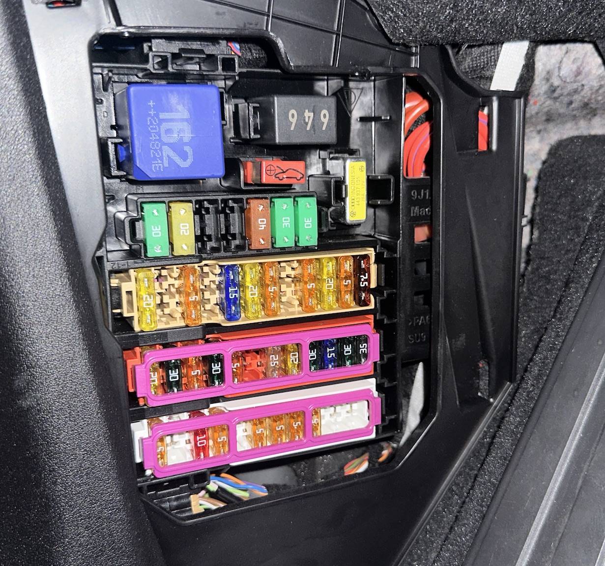

I have been having trouble logging into Porsche Connect from the PCM for weeks now and have found several posts that say to remove fuse 8 for 15 minutes; when I look at the fuses (US Model), I don't seem to have a fuse 8 on Row A- am I looking at this wrong? Thank you.

8 isn't even the right fuse. According to the owner's manual 8 on a LHD car is "Radio-controlled parking control unit (left-hand drive), charge port sensor (right-hand drive)". You probably want either fuse 2 or 7 on the right fuse box that is to the right of the dashboard. Not the footwell.
Check your owner's manual.

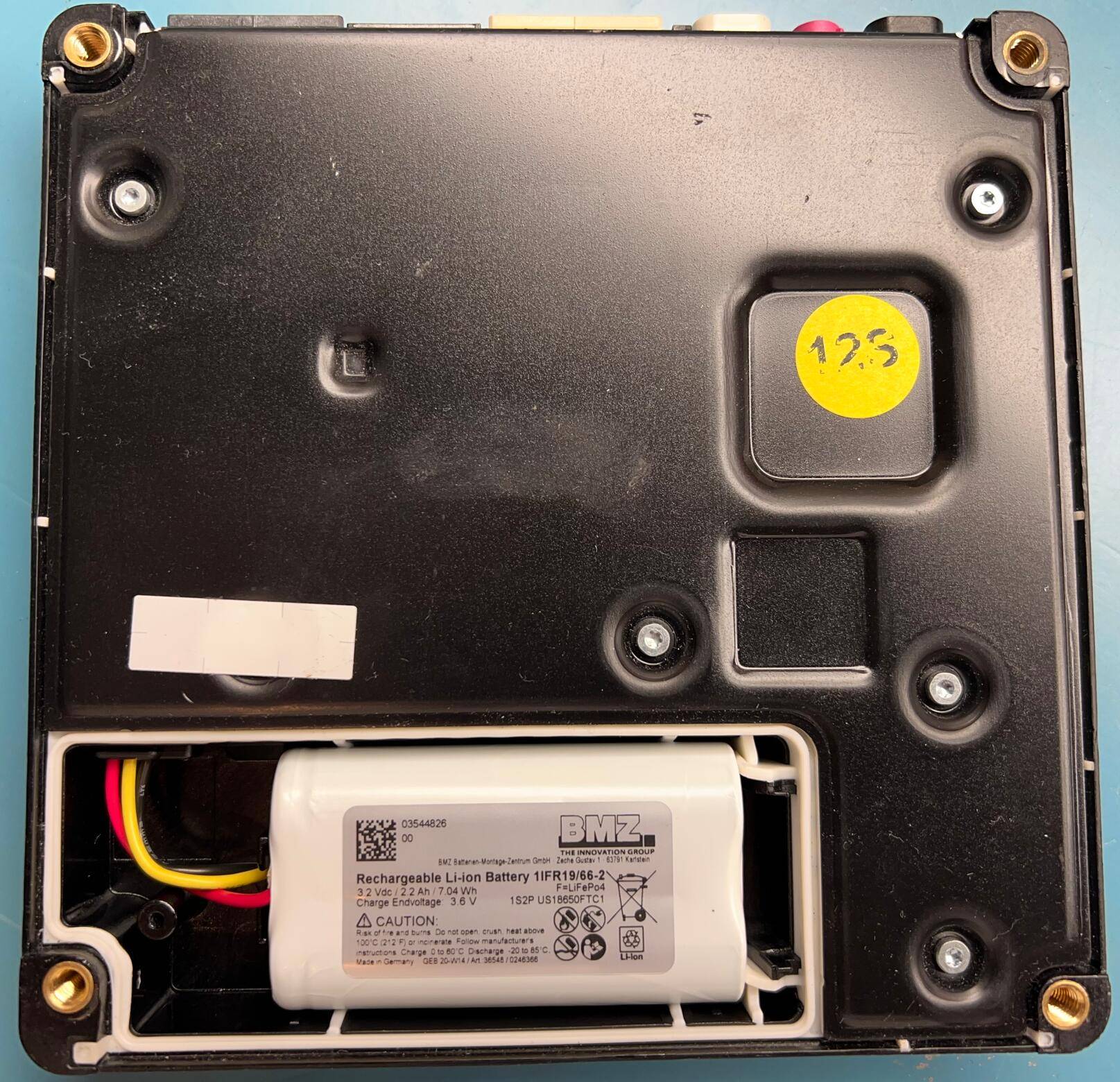

Just FYI, AFAIK LTE is not part of the OTA control unit, it is part of the conBox-High. OTA module gets connectivity from the conBox-High via the gateway. Side note, conBox-High has an internal backup battery so few minutes without 12V will not necessarily power cycle everything.
Below is what this battery looks like inside the conBox-High ECU. 7.04Wh capacity, but not sure (at least yet) what it backs up and for how long (could be full LTE modem, could be just modem/eSim parameters). Perhaps the step "disconnect battery overnight" is meant to ensure this battery drains completely?
Porsche Taycan Fuse 8? (US Taycan) 1663830022883
PS> I wonder how often this battery needs replacing - the design looks like it's a serviceable part - takes one screw to get into the battery compartment and the battery has a connector (not soldered in). I also wonder whether it dying or not holding charge will result in LTE not working correctly.
