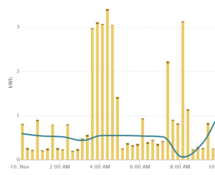

It does though. We have timers set to finish charging at 5:00 AM and pre-heat at 8:15. Below is the graph of power usage for our whole house last Friday in 15 minute increments. You can see the 15 KWh charge finishing at 5 and then there's another spike at 8:00 which is the power draw on the house from the battery being pre-heated. Note that it only draws "shore power" when preheating on the timer. If I initiate a pre-heat from the app it heats from the battery, not the EVSE.
Love the data! However, I think you're wrong about the App. Asking to "Pre-Heat" only applies to the cabin temperature, seat heater, etc.
To my knowledge there is no way to manually ask the Taycan to pre-heat the HV battery. On a number of threads you'll find requests for this feature.
Are you sure it's actually heating from shore power, rather than deplete the battery and then start charging to replenish it before departure? What is your max EVSE current and do you have a graph showing KW rather than KWh? That could show us if it was drawing just enough to heat, or was it drawing the max in order to charge the battery.
That's KWh in 15 minute increments. The EVSE max draw has been 10.8 to 11 KW. So what you're seeing just prior to 5 AM is the EVSE drawing 2.7 KWh in each 15 minute span on top of the background consumption. Then again in the 8 to 8:15 segment that's power going through the EVSE It's going into the high voltage system bus. It could be drawing at full power, but the battery is absolutely being heated during that time and the charging timer is set to finish by 4:55 AM and the garage is kept at 45 degrees, so it's the preheat timer that's causing the power to be drawn.
The heater at 10 KW, plus the pumps essentially matches the 10.8 KW the car can draw from the EVSE. Perhaps if the ESE was only delivering 5 KW the battery might be getting drawn down. Porsche has said in as many words that 1.4 KW charging can actually drain the traction battery in cold climates because the power going in is less than the battery heating consumption.
