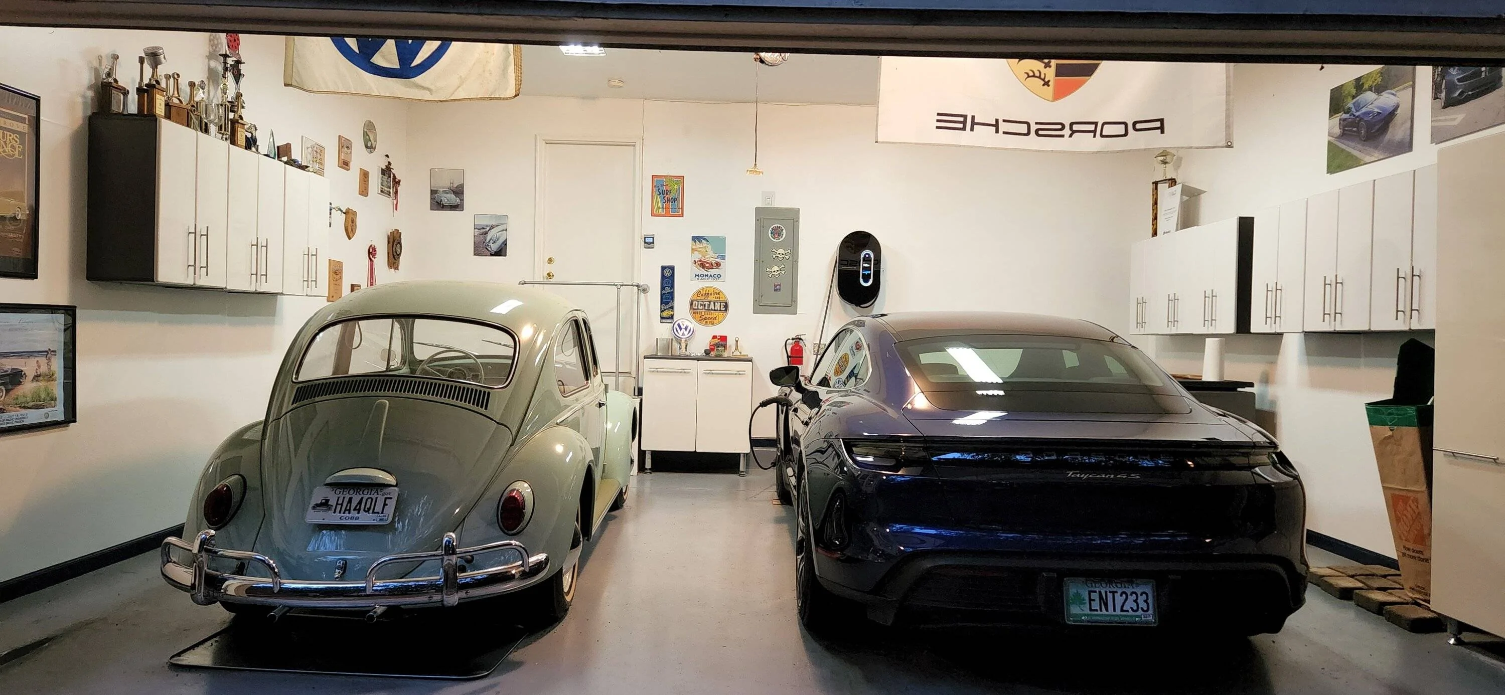

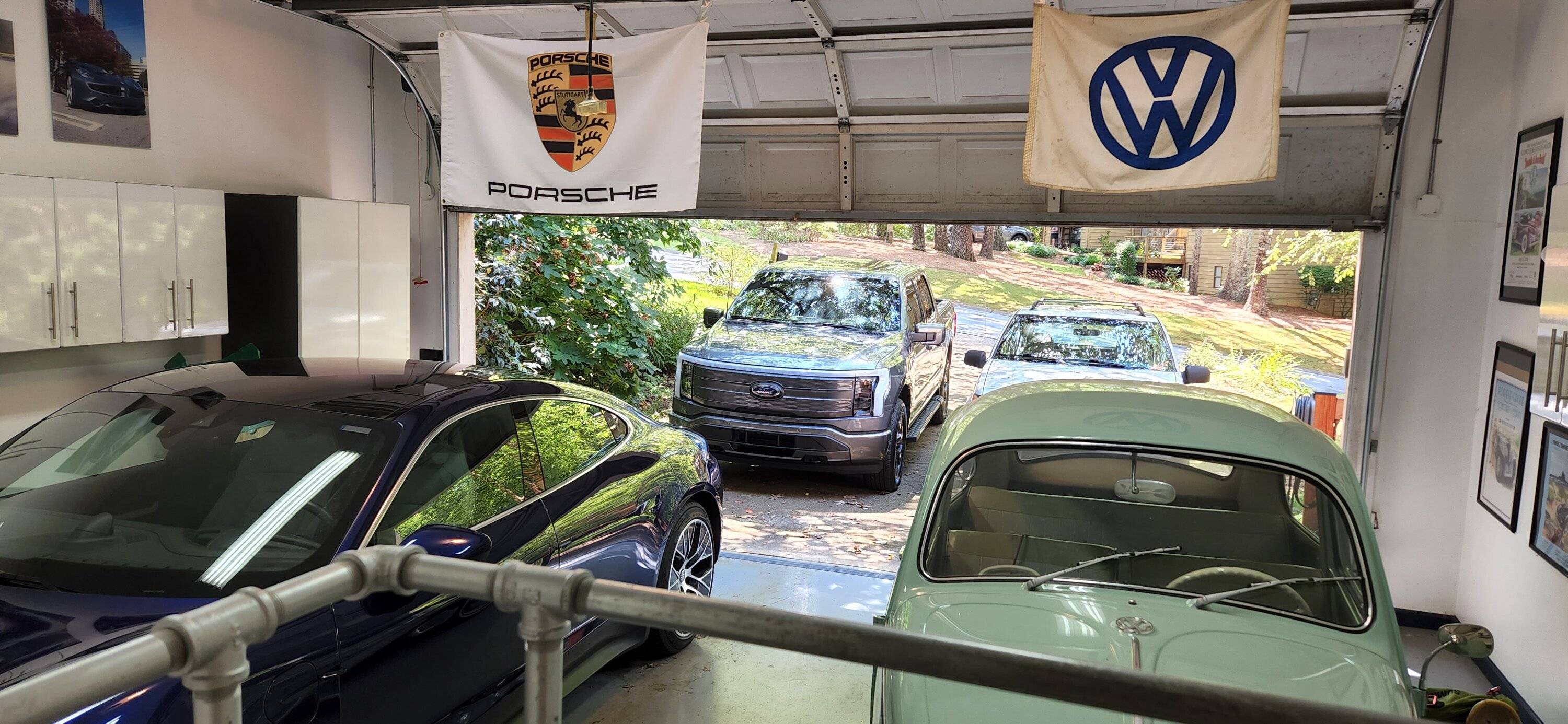

I'm a big fan of torsion bar garage door openers instead of traditional mount if your garage will support it. It's much cleaner and allows for a higher garage door retraction height and much more usable height in the parking area, which may better allow for lifts or stacking car storage.
My garage is relatively small compared to some here, so I prefer to keep it bright and uncluttered, and the extra airspace afforded by the torsion opener really helps.
Porsche Taycan Garage Remodeling/Upgrading Feedback. 20220816_201727
Porsche Taycan Garage Remodeling/Upgrading Feedback. 20220828_132527
