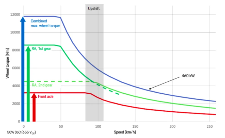

From the Jalopnik article.
Porsche says it used two gears “in order to improve efficiency, and also to help optimize both low-speed acceleration and top-end speed”
The article says “at about 100 km/h, or 62 mph, first gear runs out of steam, and the motor isn’t able to send much torque to the rear wheels (and at 81 mph, the motor hits its 16,000 RPM max speed), which hurts vehicle acceleration.”
“It’s at the point around 62 mph vehicle speed that the Taycan upshifts, yielding the solid green curve you see below, allowing for more torque at the wheels, and thus more acceleration to a higher top speed.”
(The torque curves have appeared in other threads).
Then goes on to say “Range and Normal mode, Porsche told us, prioritize second gear to optimize efficiency. “

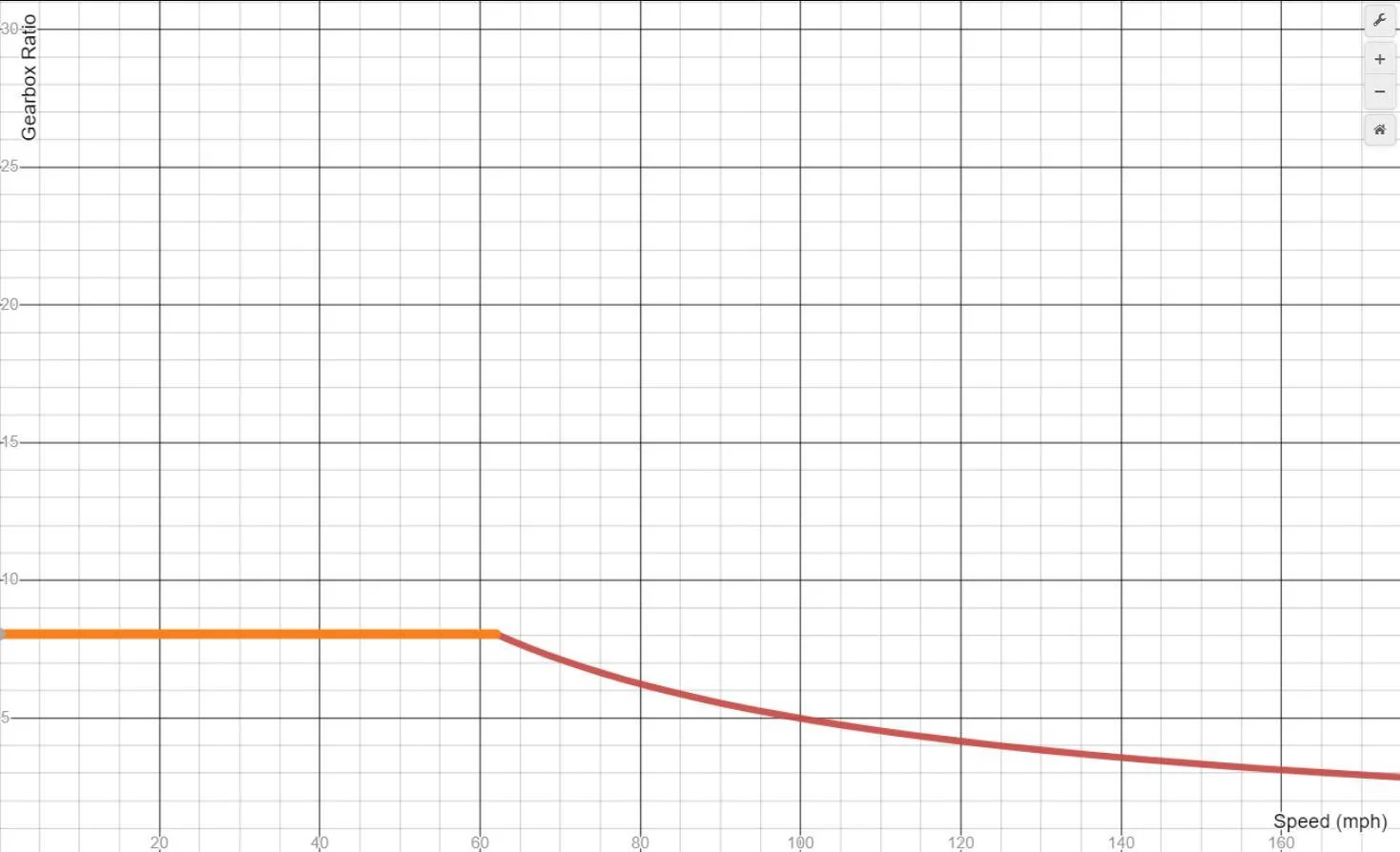

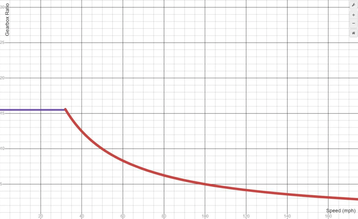

I think most people are familiar with this:
Porsche Taycan Gearbox: totally unnecessary. 1657749420936
Notice how the 1st gear wheel torque follows the 2nd gear wheel torque in the constant HP region (around the upshift).

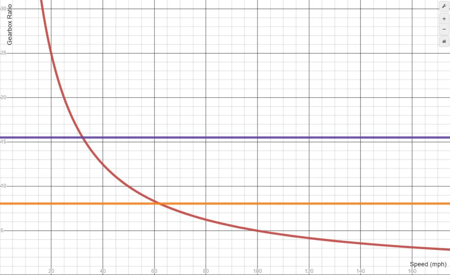

We can extend this further to arbitrary gear ratios.
The below graph shows a constant HP torque curve in red.
The X axis is mph.
I've marked the Y axis in gear ratio.
From there. You can draw a straight line out to the constant HP curve and that will be the motor torque curve (the straight line until the constant HP torque curve, and it follows the constant HP torque curve from there).
I've put two lines on here. One for 1st gear (purple) and one for 2nd gear (orange).
But you could put a line on there at any gear ratio and see the expected torque curve.

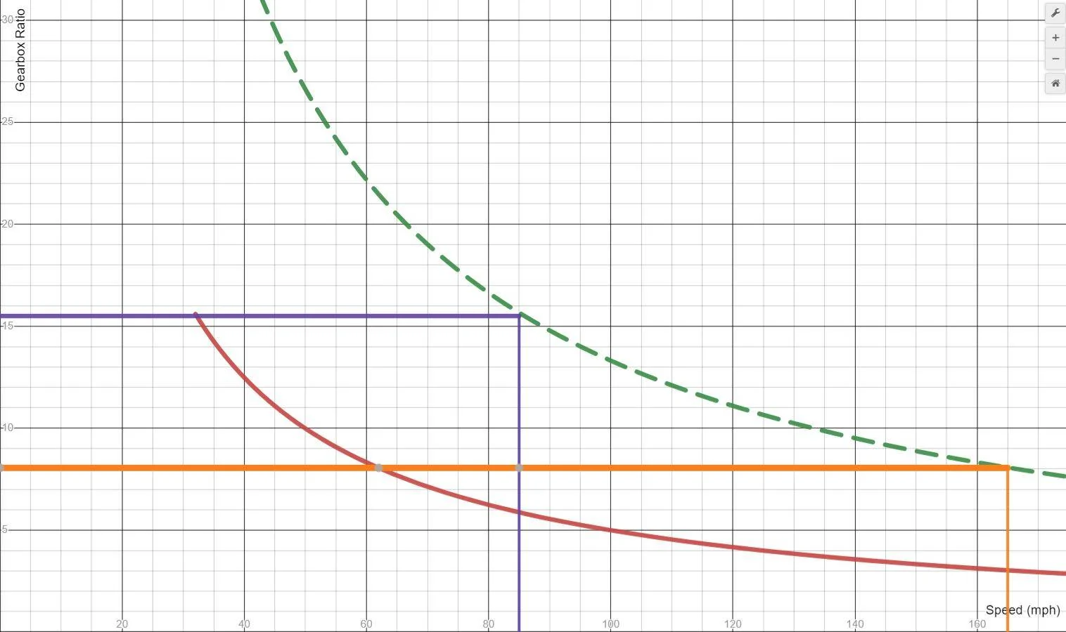

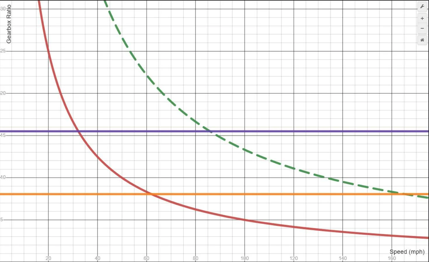

Now, the other thing to consider though is the maximum motor speed.
I've added another green, dashed line here for that.
Wherever the straight line from the gear ratio intersects the green line, that's the maximum speed for that gear ratio.
Porsche Taycan Gearbox: totally unnecessary. 1657750542131

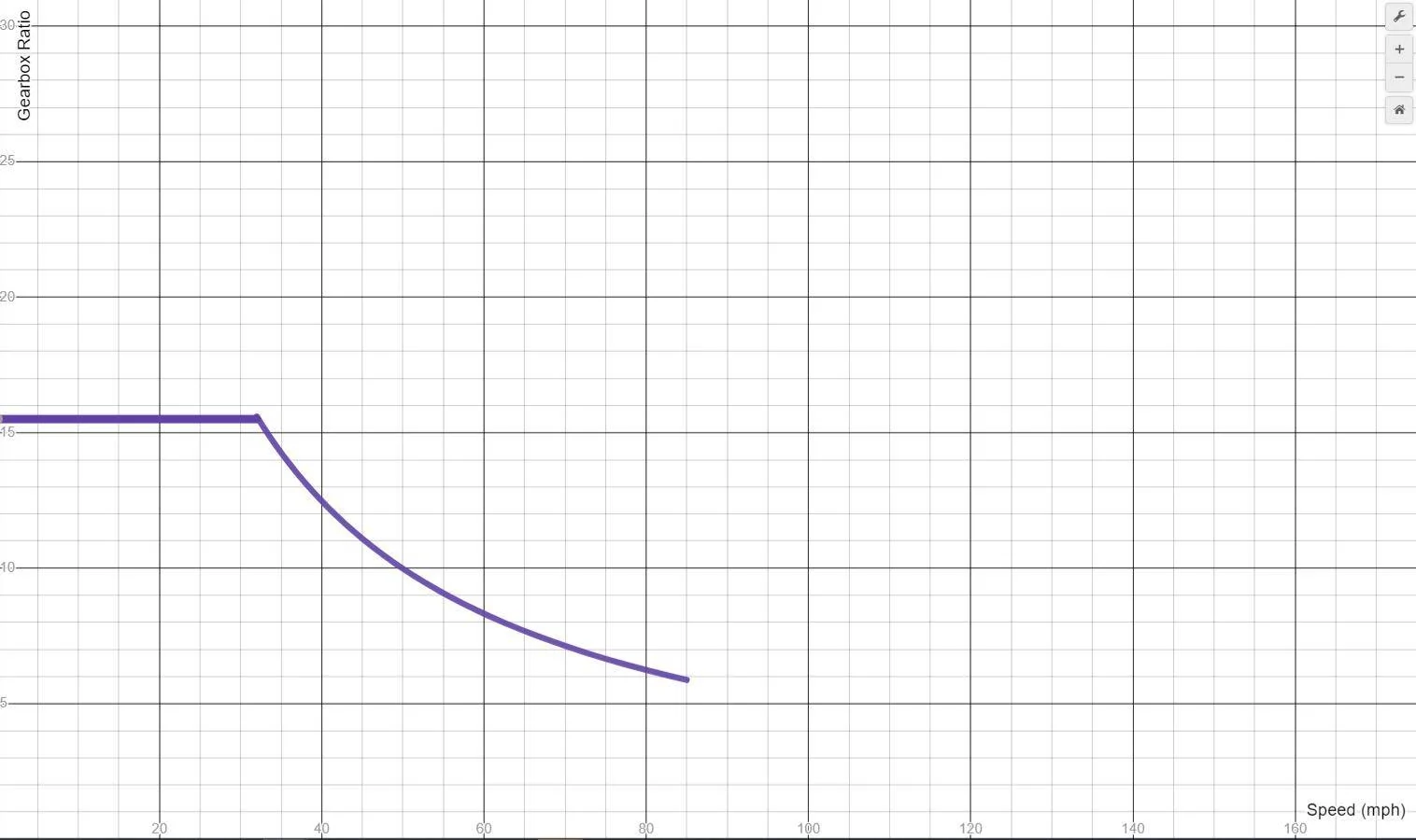

So, our torque curves will actually stop at those maximum speeds here:
Porsche Taycan Gearbox: totally unnecessary. 1657755741410

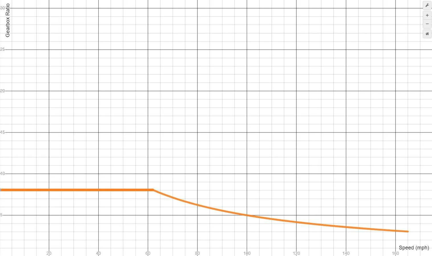

And we're left with the following two final torque curves within the motor's speed range for each gear:
Porsche Taycan Gearbox: totally unnecessary. 1657755813243
Porsche Taycan Gearbox: totally unnecessary. 1657755857905
So, it is as @JimBob quoted from Jalopnik.
First gear for for low end acceleration.
Second gear is for top end speed.
Neither gear can do the other anywhere near as well.
And anything in-between will be a compromise of both.
