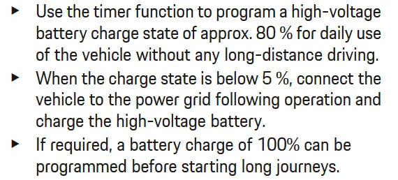

so what is the minimum % we shouldn't go below and we have to charge our cars on it
On the owner manual, I found that:
This is poorly written. It’s not suggesting you wait until the SOC is below 5% to charge, but rather sitting below 5% can be harmful and you should charge ASAP.
Yes. Letting the car sit at a low state of charge has been left out of the discussion which has focused on the car sitting at a high state of charge.

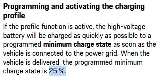

Yes you are right.
I think that the minimum SOC should be 25% as suggested on the default profile.
