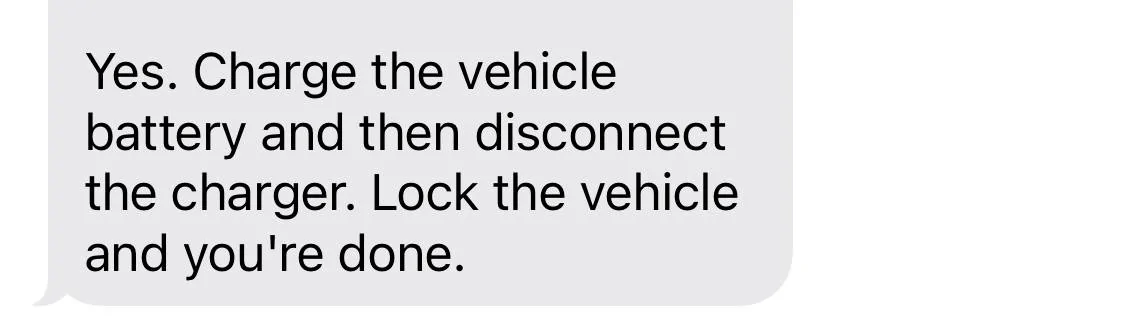

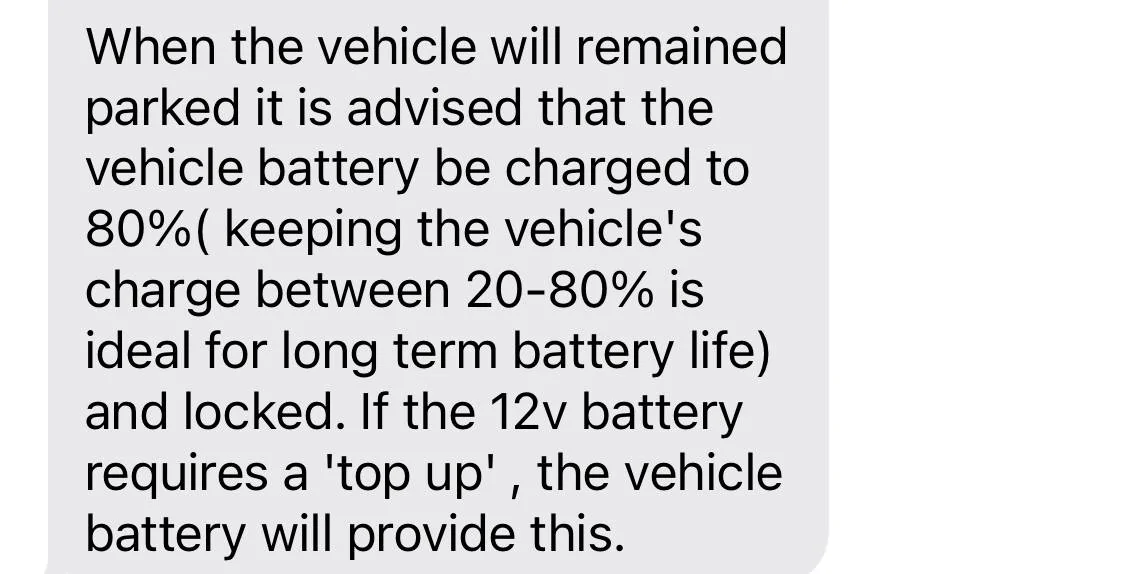

Canada, -20C. Gone for 2 weeks..
As per my dealer's instructions, I charged my Taycan 4S performance battery plus to 80%, left it unplugged in my garage. Turned interior monitoring off. Locked the car. Did not lose any range whatsoever in 18 days.
