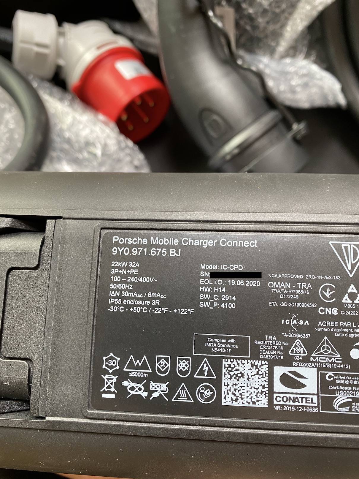

I have my 4S delivered today and to much surprise i got a 22kw charger!
Ordered my car in february and 11kw was in spec. But i got this upgrade for free.

Are you sure it's not charging at 22 kW DC rather than AC, since, you know, it has a 270 kW DC charger.
3,081
2,678
That seems standard supply charger here in Europe. I got the same type 22 kW that will be installed today, but my car only accepts 11kW. Good to have for future models though so all installation will be prepared for 22 kW.

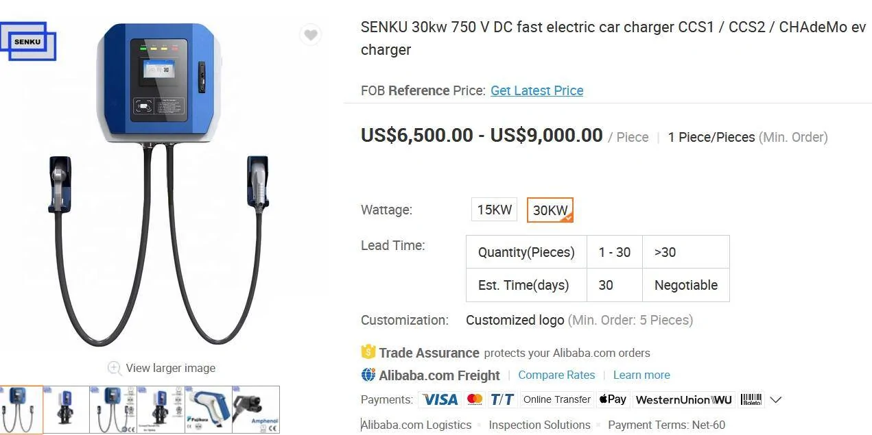

my personal $0.02 is that once you’re above 60 amps - I’d really prefer a 17 kW Fast DC charger - which would require about a 80 amp breaker - and would by-pass the onboard AC charger on the vehicle…using the fast DC support which we all know is 50/150 kW for 400 volts, and 270 kW for 800 volts. 99% of US residential homes could only support a maximum of 15 to 17 kW fast DC charging, well below even the “slow” 50 kW maximum charge rate for most CCS based EV’s (Bolt, eTron, Taycan)
Sign me up for an 80 amp Porsche Fast DC charger - and they can even charge me tooooo much money for it :rock::like::clap::handsinair::involve: - right @Toby Pennycuff? you’d pay Porsche ungodly sums of money for a 17 kW fastDC residentical charger? right?
that would mean the limit of the onboard AC/DC rectifier would no longer matter and I could charge as fast as my home residential power supply would allow me.
Dig in here and you might find what you need? Like this one:
Porsche Taycan Got a 22kw charger in Estonia 1614303897229
