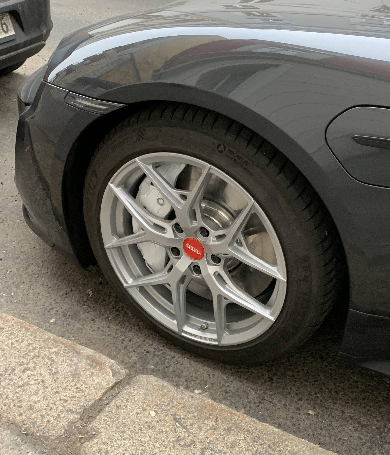

Finally have my fitment all sorted out :) It was fun having a hand in the process for BC Forged. I was sent some basic templates and got to measure for offsets re: caliper clearance to get nice and flush.
Also, lucked out tire wise. I had no idea the Pirelli P Zero Elects were on sale in the states. Ordered some P Zeros and realized as soon as the order went through that they were indeed the Elects.
Updated with specs:
The wheels and tires are the same spec as the 21" Mission E wheels. I wanted to stay within spec at least on that. The offsets were built to match the 15mm spacers I had on my 20" Turbo Aeros. Soooo...that puts them at: 21x9.5" +45 front and 21x11.5" +51 rear.
Updated with specs:

Just wondering if you have real wheel steering and if the adjusted offset on the rear hits anything?
Updated with specs:
Looks fantastic! Whats the finish on the wheels? Looks like brushed clear with a polished lip, yes?
