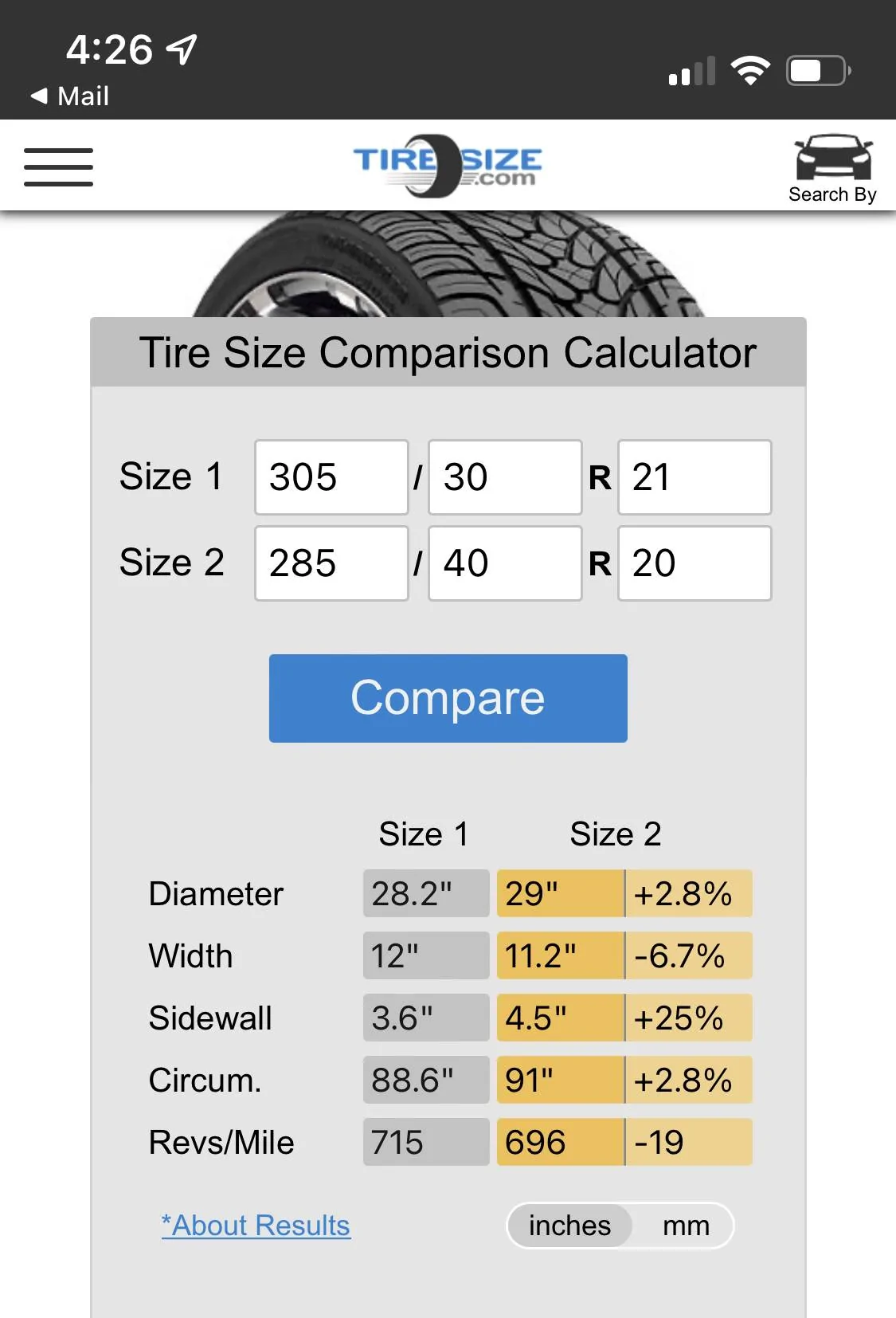

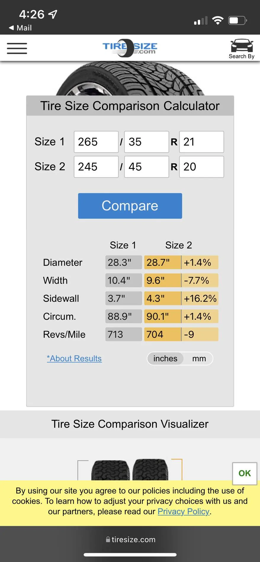

You have to take in account the height of each tires size.
20 inches
front is 245/45 R 20
rear is 285/40 R 20
21 inches
front is 265/35 ZR 21
rear is 305/30 ZR 21
Here Is the link to calculate it.
Tire Size Calculator
Bry5on
Jan 25, 2021
184
141
CA
'70 electric Jaguar, ‘21 Taycan 4S CT
You’re right - 5mm more clearance in front and 10mm more in rear. I had only run the rear numbers previously. Good call!
