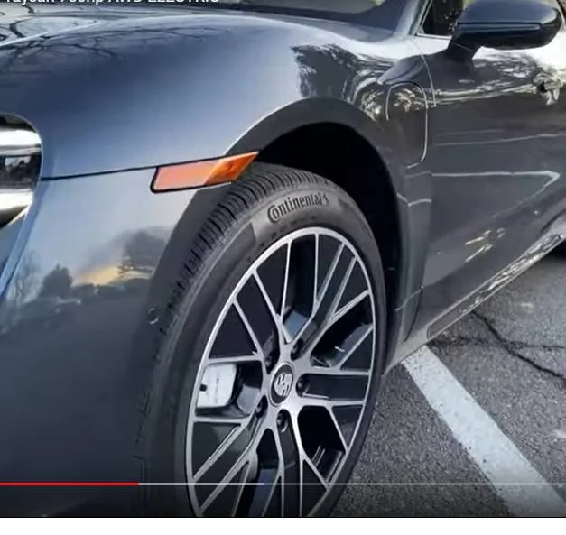

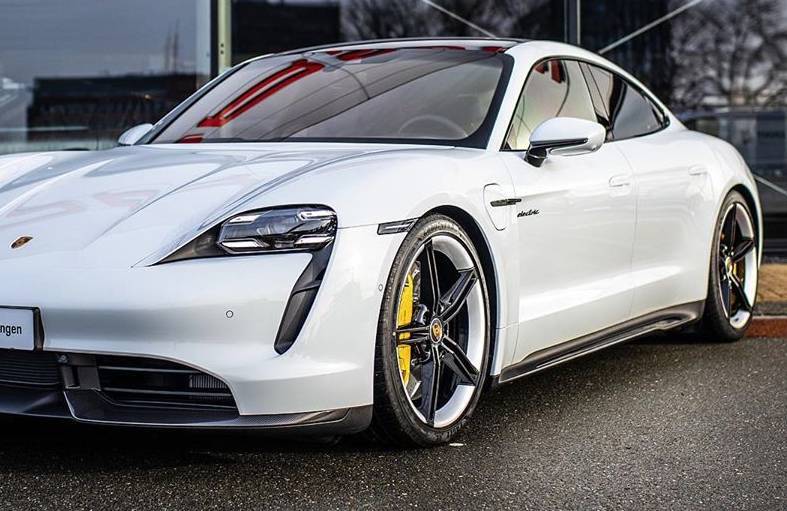

I'm trying to understand why suspension height varies so much across the hundreds of customer/dealer pics I am viewing on line.
I 1st saw my dealer car yesterday and I have an issue with this. I'm admittedly anal about offset, ride height, and the relation of both of those to a Porsche's fender line and wheel arch.
What I saw yesterday at the dealership is unacceptable.
I have many more examples of these two extremes.
Porsche Taycan Ground clearance on Taycan 4S? Front no 1
Porsche Taycan Ground clearance on Taycan 4S? Front no 5

I watched a video on YouTube last night where a guy complained about that difference. The other guy simply uses the on-board controls to lower it to the level in the second picture. Sorry, don’t have a direct link to the video.

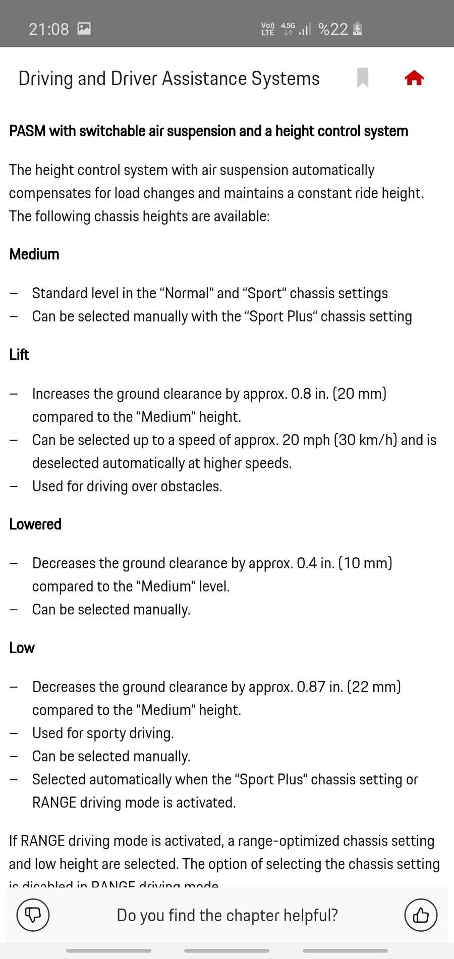

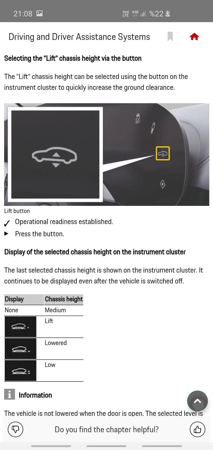

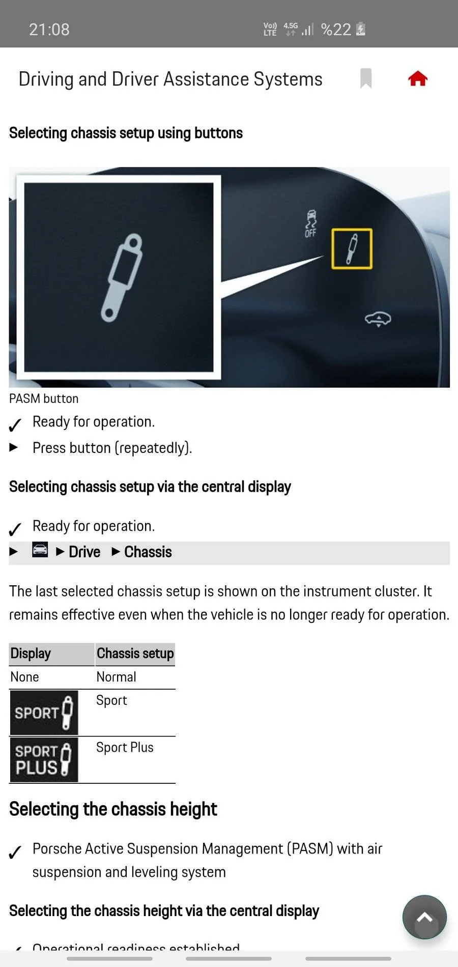

I'm also a bit worried about the ground clearance generally. Not really that it won't be enough when in raised mode, but what if I drive into something steep with the wrong driving mode? In Range & Sport Plus modes the car is always at its lowest setting. With Normal & Sport it depends on driving speed, so at low speeds it will be raised.
I'm so worried about this I'll probably rarely drive in Range or Sport Plus modes, as otherwise I'd have to be fairly paranoid to check the mode every time I'm closing in on something tricky. Normal & Sport for me most of the time probably.
