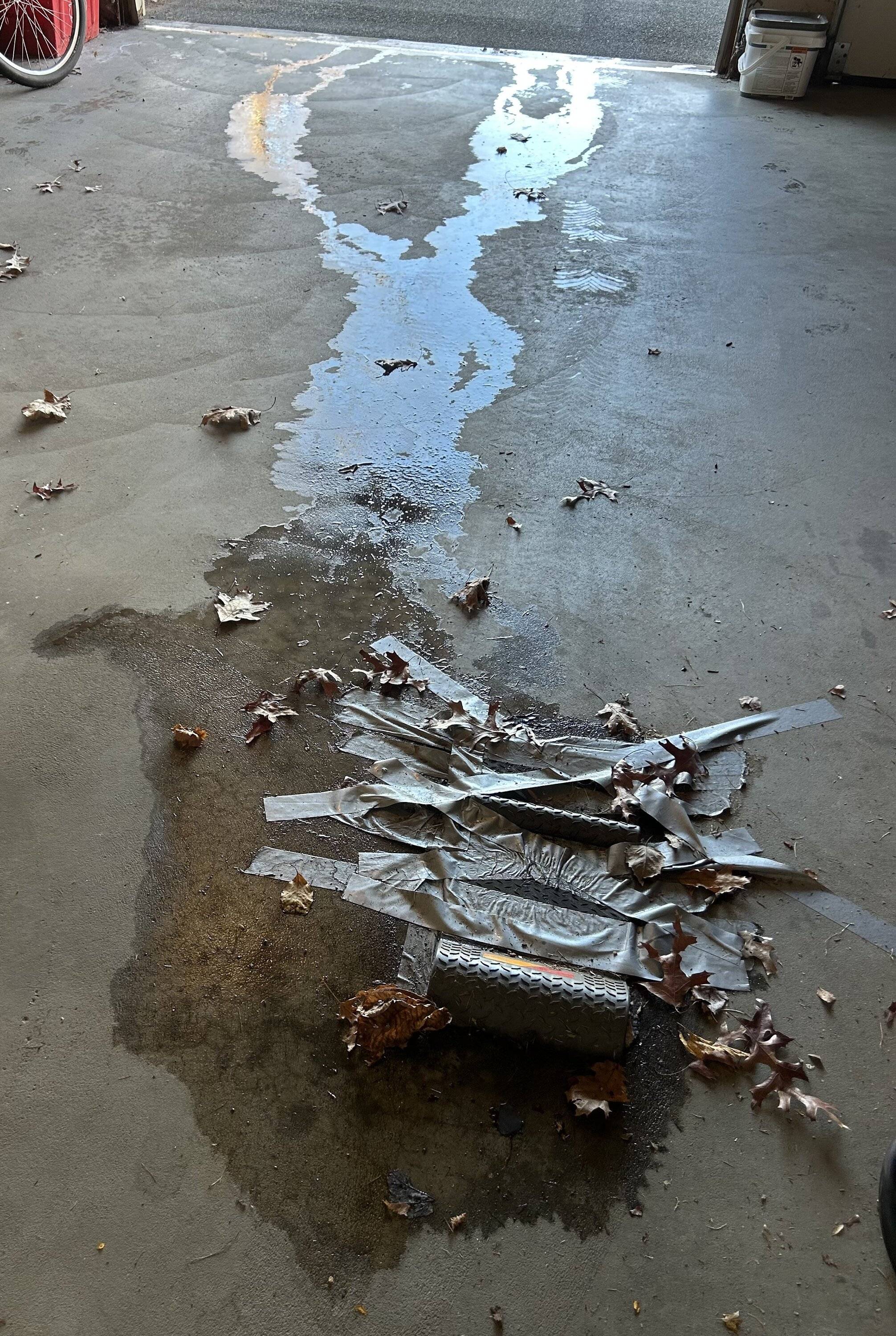

Picture, well, as I previously wrote, no visible damage.
However, here is the coolant leak.
(Before I mopped it up with some stuff I bought almost two decades ago -- and have been saving every since, just in case! -- when I took my Subaru Legacy to Jiffy Lube for a change and they neglected to use the necessary crush gasket, as explained by everyone's favorite local Subaru guy at the time before he had to stop for health issues.)
You can see that it started near the left front (the messy duct-taped thing is a wheel stop) then flowed out toward the garage floor.
Impossible to tell how much leaked, since I was away from Wednesday morning to Saturday night, and the fluid flowed under the garage door and down into a small gap in the driveway.

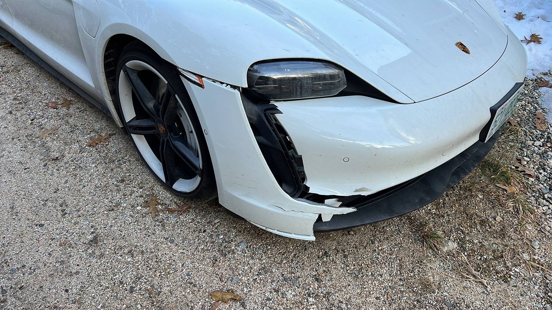

I'm curious too about the seemingly high cost to repair, maybe they can take pictures?
A baby carriage, sans baby, was sitting on the middle line of Route 3 North in Plymouth.
The car ahead of me brushed it into my path and took out my bumper and a few grill slats.
Including fixing the scraped rim from a Chick-fil-A drive through, bumper PPF film, and ceramic coat on both only cost $3,133.

Sorry to hear about your Groundhog attack. We have them here in Kansas too and they seem quite large and heavy looking to me. I have often thought when seeing them that it would suck to hit one. On an unrelated note, I am guessing you were angry when you put down that duct tape (You! Will! F'ing! Stay! In! Place!).
Yes, hardly the elegant fixation technique there!
However, in fairness to myself, when I first put it down in 2022 for my A6ar, I used only a modest amount of duct tape to supplement the OEM double-stick tape plus some of my own double-stick tape.
Stayed put perfectly!
But then when I got the Taycan, had to shift it over a bit.
And the placement has to be precise in order the solve the optimization problem of enough space between the rear end and the garage door, enough space in front of the front end to allow the person door to open to the outside, enough room on the right for the car door to clear the short banister on the steps leading into the house, and enough room on the left for the car door to clear my wife's i4 (which she parks all over the place, hah!).
So enough instead of trying for a clean fixation, I just went nuts with some cheap duct tape -- works great, even contaminated now with coolant!

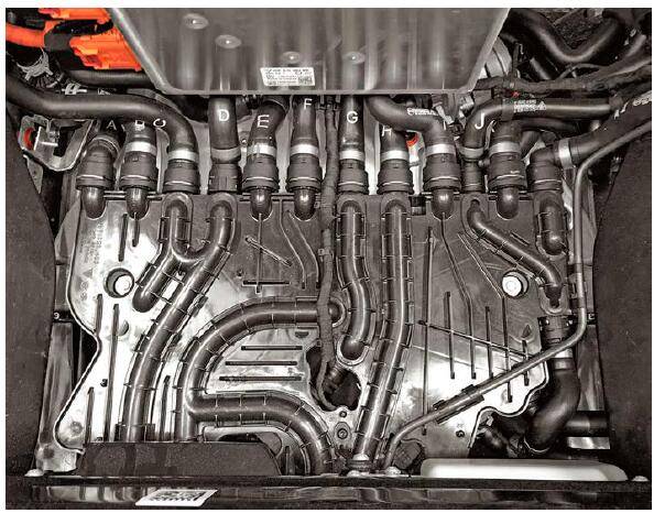

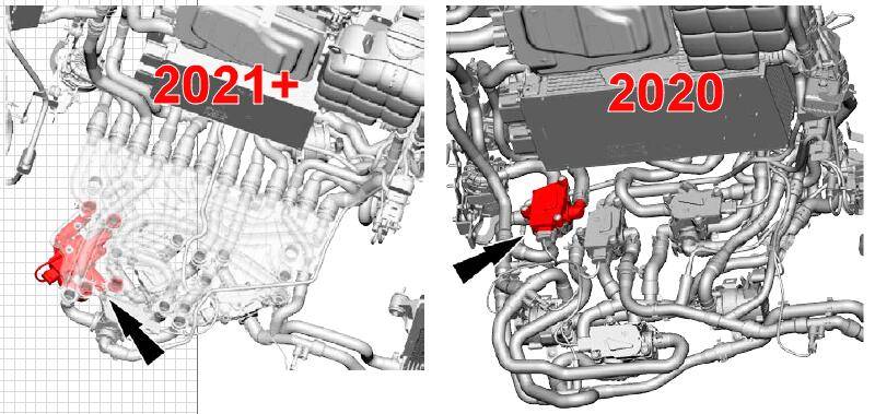

Maybe that whole spaghetti coolant pipe assembly is only replaced as a full unit and you can't just do individual parts?
The initial 2020 spaghetti of pipe design was replaced by a single manifold the following year.
Porsche Taycan Groundhog (or more likely a Raccoon) 0, Taycan -$17.8k (damage) 1732100250483-c6
The new coolant manifold looks like this:
Porsche Taycan Groundhog (or more likely a Raccoon) 0, Taycan -$17.8k (damage) 1732091873296-6n
