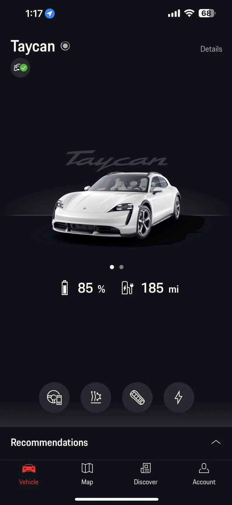

I've yet to see an estimate this high.
Porsche Taycan GTS Sport Turismo range was much more than initially indicated/expected on long drive! 1680250791063
58
4,929
4,100

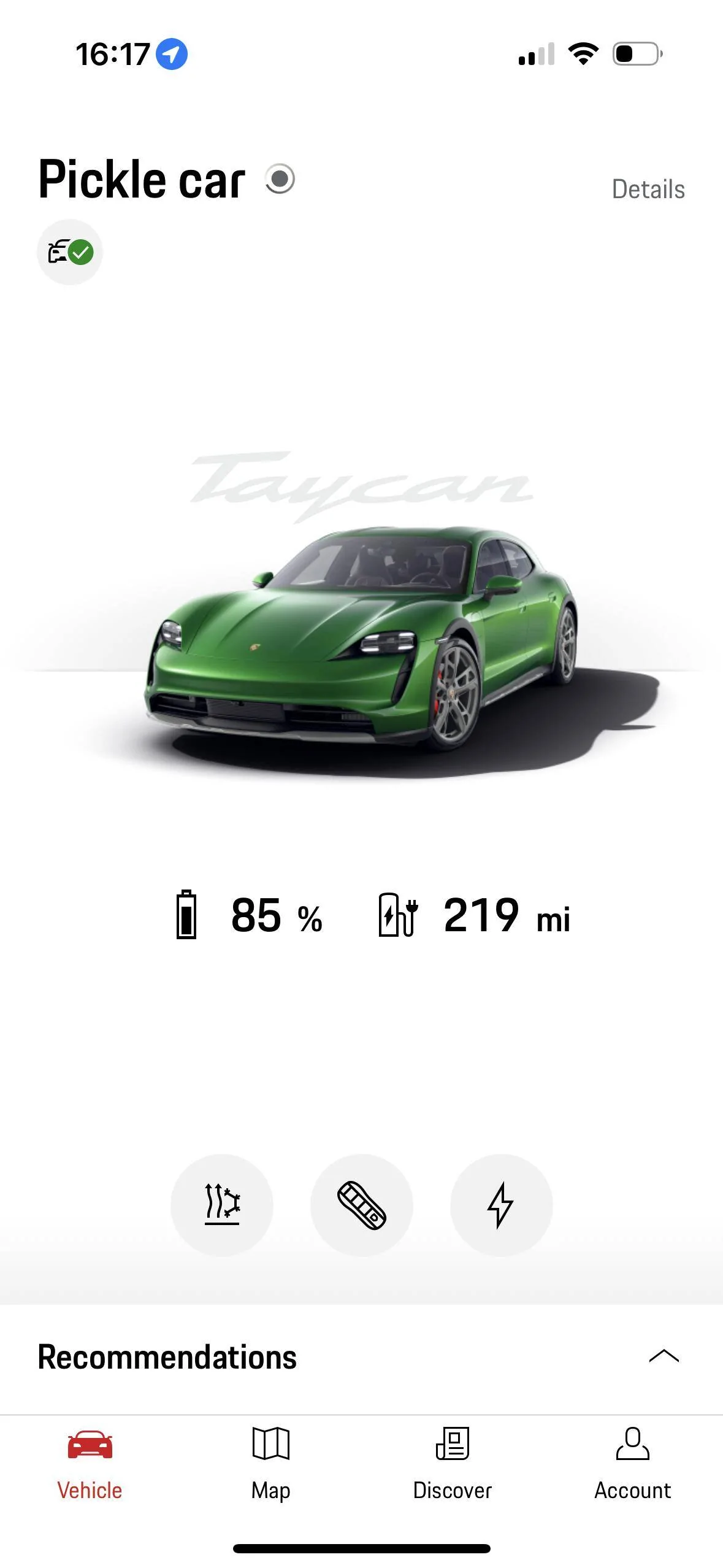

193 miles at 69% as it sits right now. Just how hard do your drive that poor car? I know your answer - the way it's supposed to be driven.
I don't like paying for things I don't use. I paid for a Turbo. The most I have every seen at 85% was 186 miles. It was in the 160-something when I finished my cross country roadtrip, so it's actually going up (WA speed limits are not as high as most of the other states I traveled through). Than again, I've only had it for a month and half, ~4000 miles, so all winter'ish so far. Will switch to all-season tires soon too (maybe even this weekend if I feel like doing the swap).
