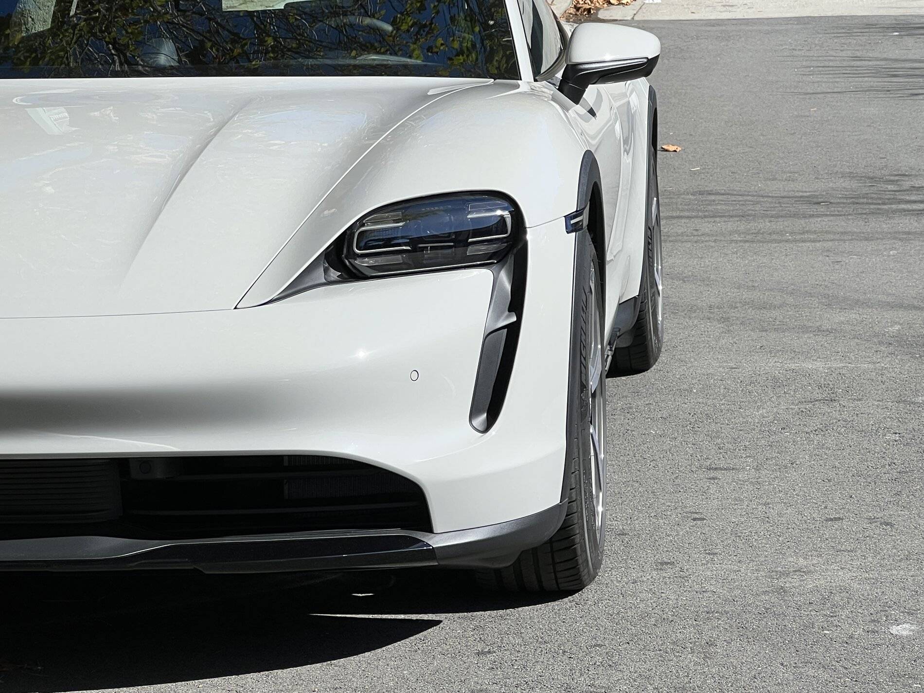

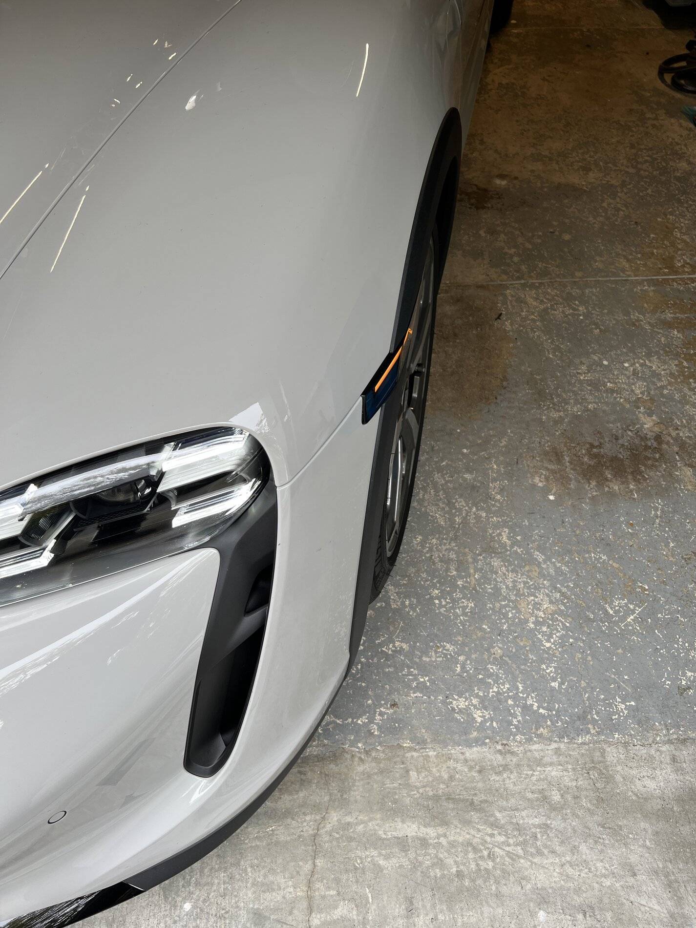

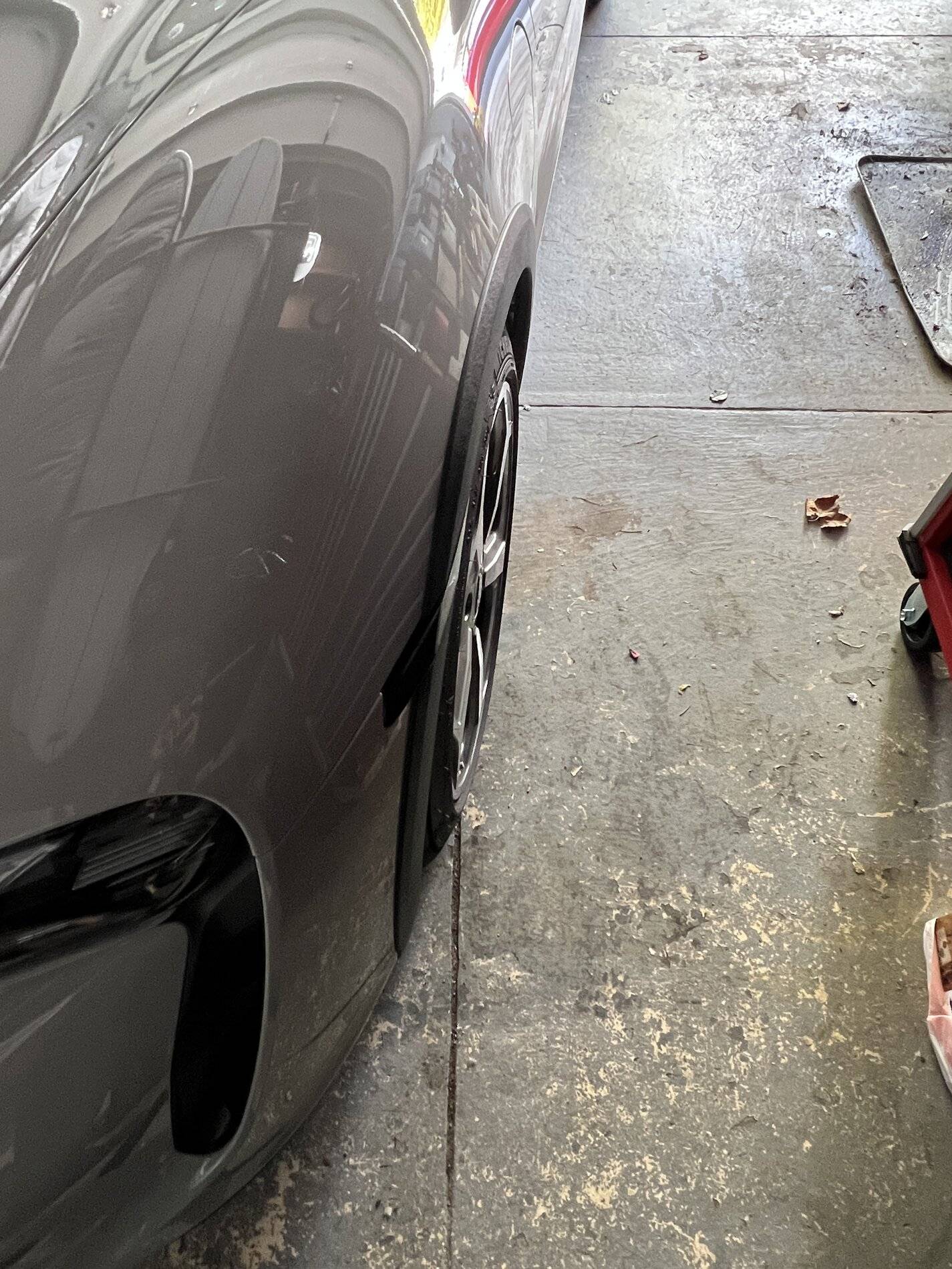

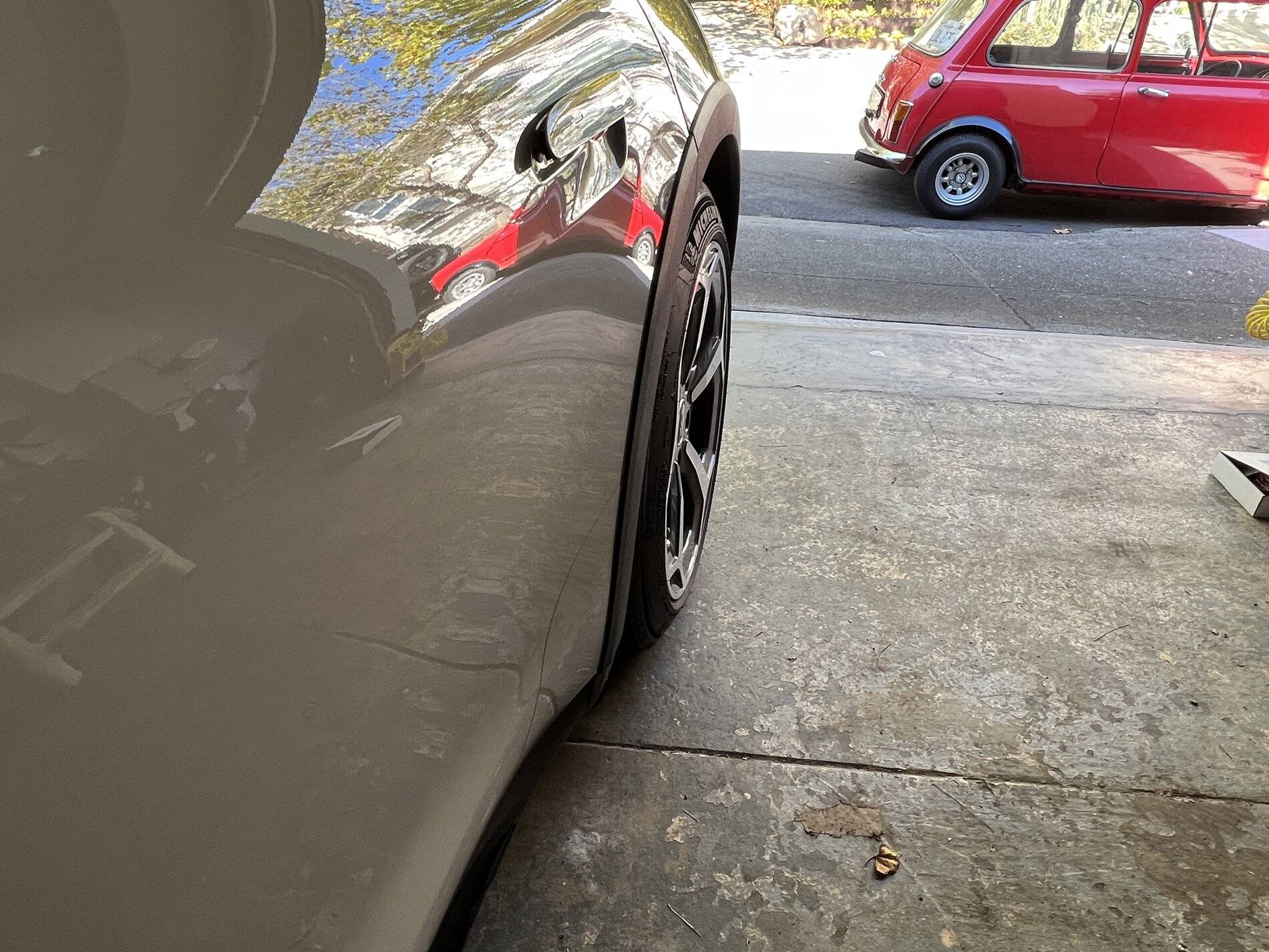

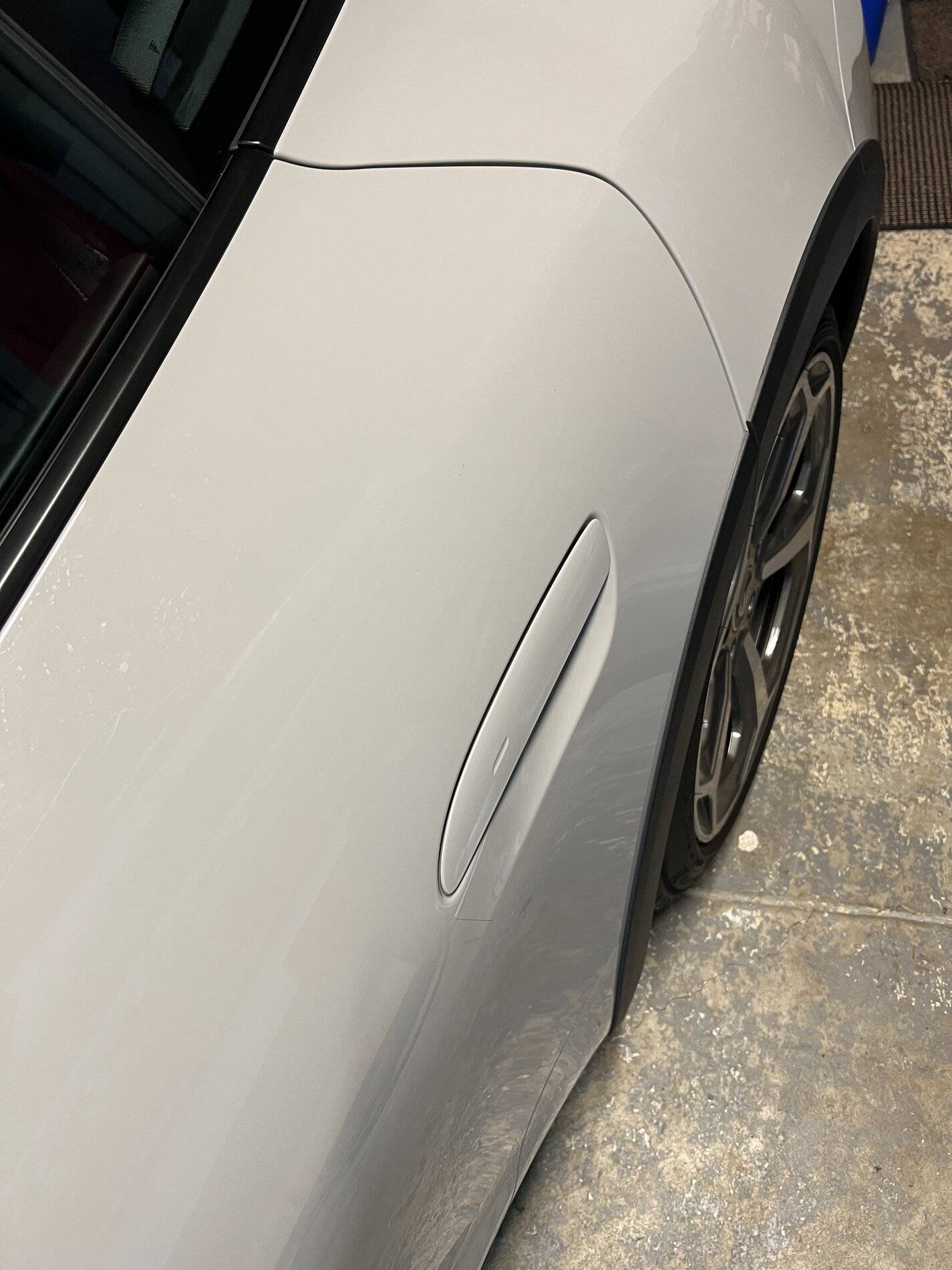

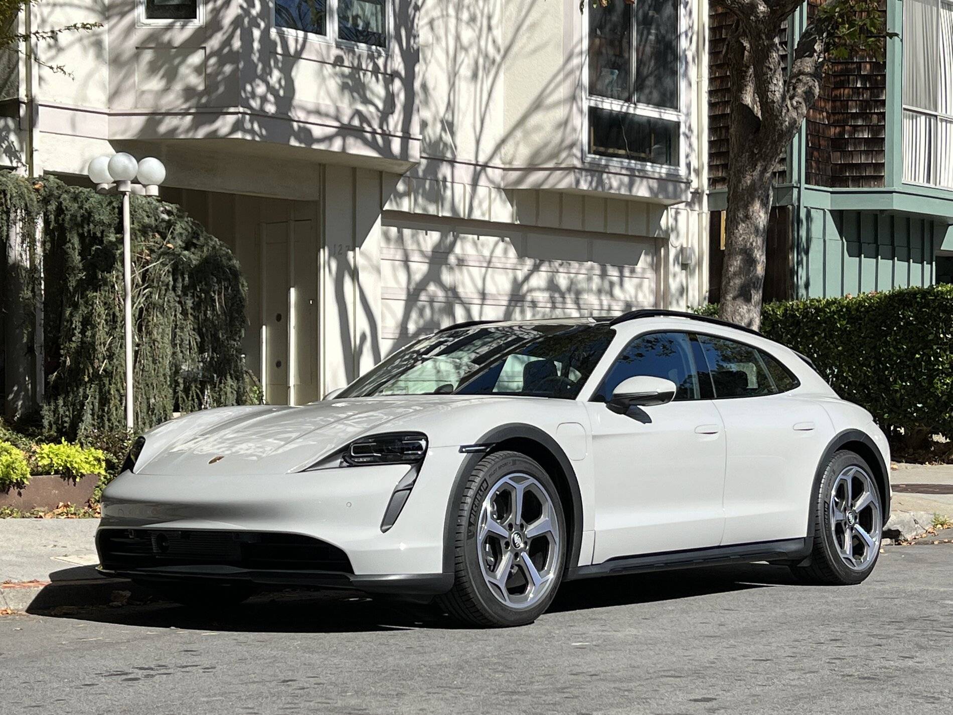

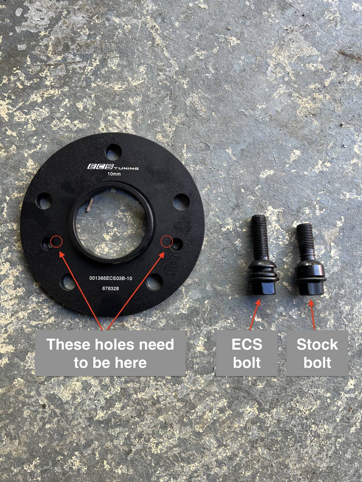

Here is my CT wheel spacer update. The goal for me was to keep the car looking stock and aligned with the design intent but getting rid of the tucked in look that the wheels had from the factory. After some testing, I found that the magic number for my Cross Turismo with the 20" Offroad Design wheels ended up at 10mm all around. The overall difference is subtle, but can look significant from certain angles.
ECS Tuning has a spacer test kit you can rent (or purchase) to try different spacer sizes so I started with that. I initially tested with 15mm and found that the front was mostly OK with that size, but the rear doesn't like going that wide. The fender starts to taper inward behind the rear wheel so from the front, 15mm looks good but the whole tire stuck out a little when viewed from the rear. I tried 10mm next and I liked it so didn't bother with increments between those. I decided to take the front down to 10mm as well, to keep the look more uniform with the rear and I'm pretty happy with the results.
I ended up buying 2 sets of ECS Tuning 10mm spacers that are a multi Porsche model fit in a kit that included the proper length bolts. Their part number is: ES#2702490. Their fitment info on the site isn't updated, but I confirmed with them first that this will fit the Taycan. They seem to be well made an have some nice details to keep them light and easy to remove. There was one small issue- they come with screws to secure the spacers to the hub, but the holes on the spacer did not properly align with holes in the hub. I have never used mounting screws with spacers I have installed on numerous vehicles in the past so I decided to continue installation without them.
They are freshly installed so I can't really comment on anything outside of how they look, but I'm satisfied with them so far. Since they are only 10mm, I doubt anyone would ever feel that difference. I have included some reference photos that I hope someone here will find useful.
This is the stock offset front:
Stock offset rear:
Here is a (dusty) spacer and bolt that came with the kit, plus OEM bolt.
Porsche Taycan Has anyone put wheel spacers on their CT yet? IMG_0275 copy
This is the +10mm front:
+10mm rear
+10mm front and rear together:
Front 3/4 view for reference:

Excellent , thx for sharing - looks really good - that 2nd last pic nails it :)
Curious if you explored using the Porsche brand spacers (assuming they are compatible with the CT)? Nothing at all wrong with ECS, being around for ages and solid reviews - I've gotten other parts from them in the past but was curious if the Porsche parts might not have the screw/spacer issue above. I know someone else pointed out a link to the Porsche brand parts - possibly in that same thread I shared above - will check.
Thanks! Didn't look into Porsche options as they didn't appear to have anything specific for the Taycan. I typically use H&R spacers but I gave the ECS ones a try this time around. They made it really easy with the test kit and I'm just using this car as a commuter and occasional surfboard hauler so I didn't care about how well these might hold up at a track day, canyon carving, etc.
