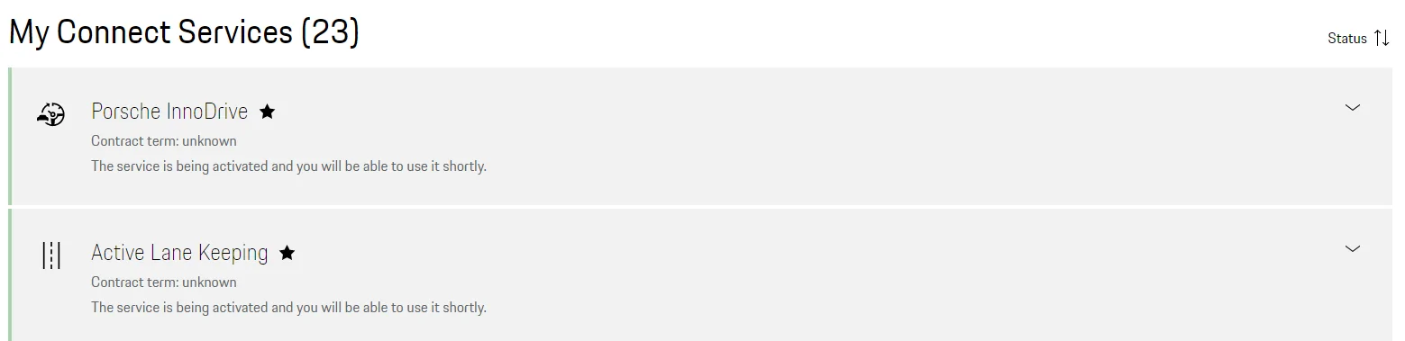

What is the dealer doing in this case to get it downloaded? My dealer doesn't seem to know much so would help if I could give them some indication.

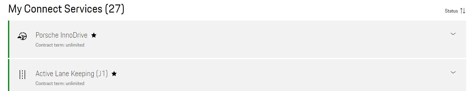

They didn't have to do anything at the end of it. All the service are now in the car.
When you go to my.porsche.com which connect services does it say you have activated?

Been pending for several weeks now.

Mine had that message for a few hours not knowing what that meant but then when I went into the car's pcm and into the 'Updates' section it had the option there for me to install. 10 mins later it was installed and ready to use.
I'm guessing you've checked updates?

All done by me through the my.porsche.com. Trying to keep as much away from the dealer as possible 😆

One thing I did note on your screenshot was your only showing 23 services where mine has 27 services. Now there maybe regional differences but I remember at the same time the updates came through some other odd bits where installed to like; weather, news and podcasts.
Can you see them?

InnoDrive, ALK, Online Software Update, Apple Music, Car Alarm, Car Control, Carfinder, Climate, E-Control, Location Alarm, Nav Plus, Porsche Charging Service, Speed Alarm, Trip Control, Breakdown Call, Calendar, Charging Planner, Finder, News, Porsche Voice Pilot, Radio Plus, Valet Alarm, Weather.

So from that list it's missing; Car security package (PTVS tracker), Smart Service, Apple Podcast & Risk Radar. Only the podcast rings a bell as that was downloaded when the Innodrive updated.
The only other thing I can think of is that Privacy mode feature in the car. I'm assuming you've set it to inactive? Check the settings around that and maybe activate it and the deactivate it again...

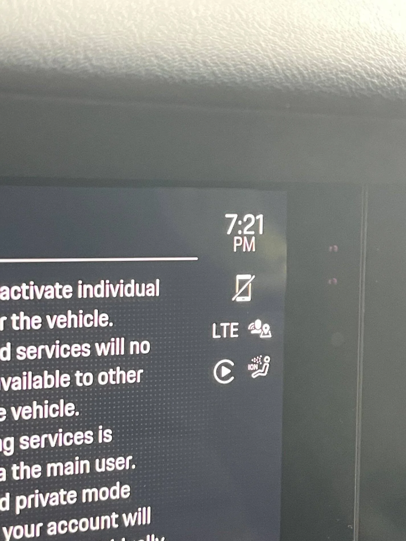

Yeah tried turning on/off private as well as auto updates. Whats your connection area look like?
Yep same icons as yours
