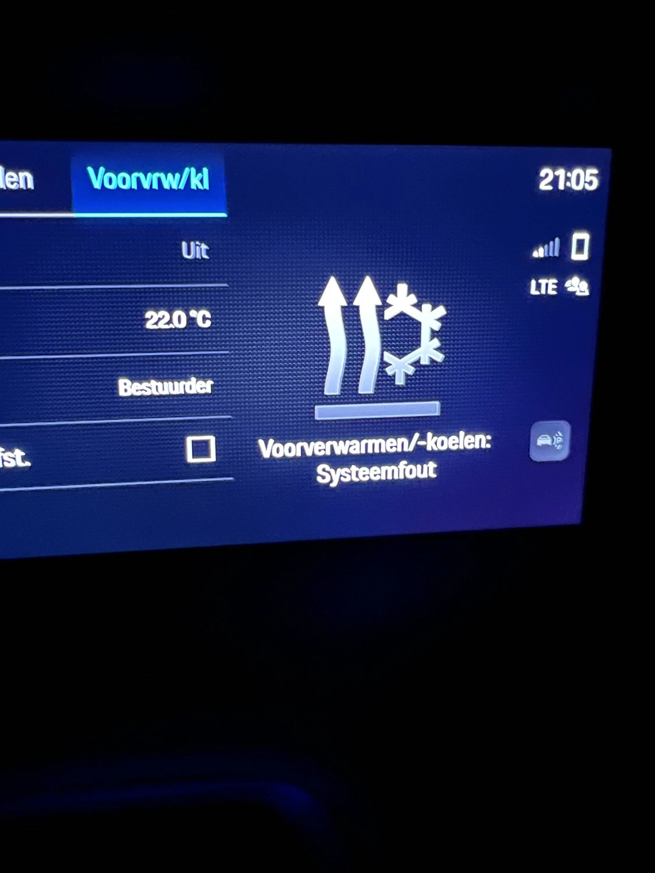

I know there are a lot of posts on this subject but I still want to share my experience and how my dealer is going to take care of this.
Since yesterday evening my heater stopped working. Quick search on the forum showed there is no quick fix. Tried turning AC on en off, max cool max heat, reset pcm but didn’t work. Tried again this morning but no luck.

At the moment my 2022 - delivered 12 months ago - no hot air in cabin, precool/heat function not available with PCM message "precool/heat: system error". Will take to dealer next week.
P**s poor reliability.
Edited to add:
The precool/heat message appears when I go into PCM...AC....tab precool/heat. The line for precool/heat is OFF and to the right of that is "precool/heat: system error".
Also, when I connect the charging plug and use the charging display in the console, the precool/heat button is dark and depressing it gives PCM info: "function not available".

Sorry, I should have included that. The high voltage heater core failed.

Same for me. 5 months old 2022. I didn’t get the message when trying to pre condition. Tried it and checked after 30 minutes but still cold.
From other posts with links about Taycan heating system details in forum, both cabin heat and precool/heat functions depend on the HV heater, which is a third "high-temperature" circuit.
Because the waste heat from the coolant returning from the motor/inverter cooling circuit is insufficient for rapid cabin heating and window defrosting, a third, high-temperature cooling circuit is used. This third system uses a small high-voltage electric heater grid to provide cabin heating and defrosting as necessary by circulating heated coolant through a heater core inside the HVAC box. The high-temperature coolant circuit is also used to “pre-condition” the battery pack for charging by heating it up to the optimum temperature for lithium-ion battery charging, which is about 86 degrees Fahrenheit.

Just checked. I have the same message.
My car is parked inside. I think it might be ok to drive 30 km to Gent to the dealer. I don’t have much spare time however and certainly not during working hours. I hope they can pick it up at and leave me a decent replacement at home.
