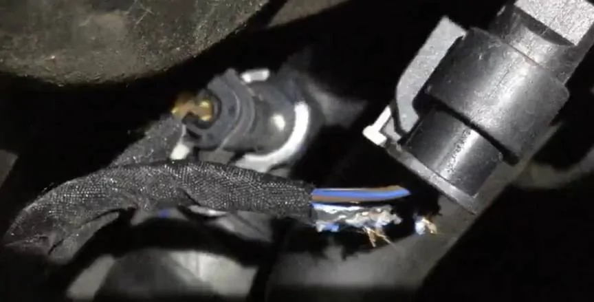

4S was with the dealer for 8 days awaiting a £950 wiring repair caused by a little mouse gnawing away at 2 little wires connected to the coolant valve (as attached image). Under final test the dealer found an unconnected heater problem. Now it's left with the dealer awaiting 2 heater server motors. I was told that the heater/AC system is very complicated and there are numerous of these devices within the system. Evidently, parts of the dash have to be removed to gain access. There's no doubt that the delays are caused by both a delay in parts and lack of Taycan EV mechanics. Worries me going forward as I've a new Taycan coming in second quarter 2022.
