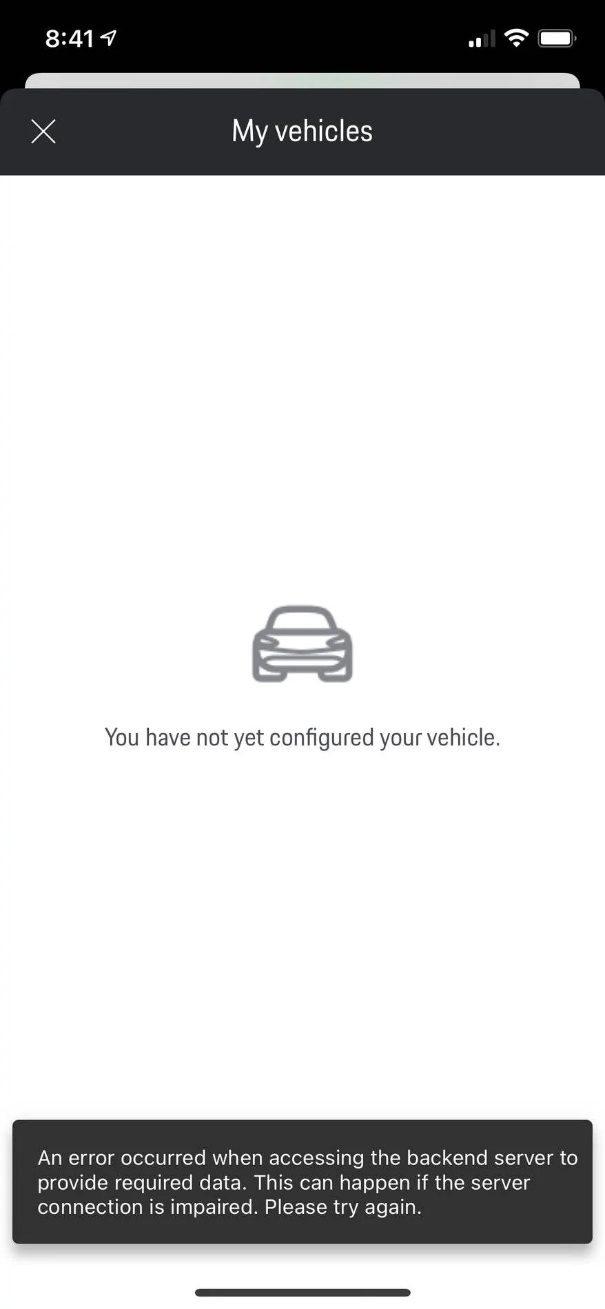

interesting, do you have plug and charge toggled on the charge NA app?
Nope, because the My Vehicles section of the Charging NA app has always been empty for me, and I dunno how to fix it:
Porsche Taycan Help! I accidentally liked the PCM! IMG_8F555AEED46C-1
This remains my most promising lead on why Plug & Charge doesn't work for me, but I don't know what to do about it.
I've done some unofficial polling of various users who also have had Plug & Charge issues, but I thought I remember someone saying they also had an empty My Vehicles section but Plug & Charge worked for them, so I don't really know what to think.
you cannot fix it, the plug and charge option has been removed from our cars.
it was removed because of the conflict caused by the 19.2 kw onboard charger.
this stinks because we don't have access to a feature because of a flaw that porsche baked into the car, they are doing nothing to rectify the issue for us and we paid for that 19.2 onboard unit.
