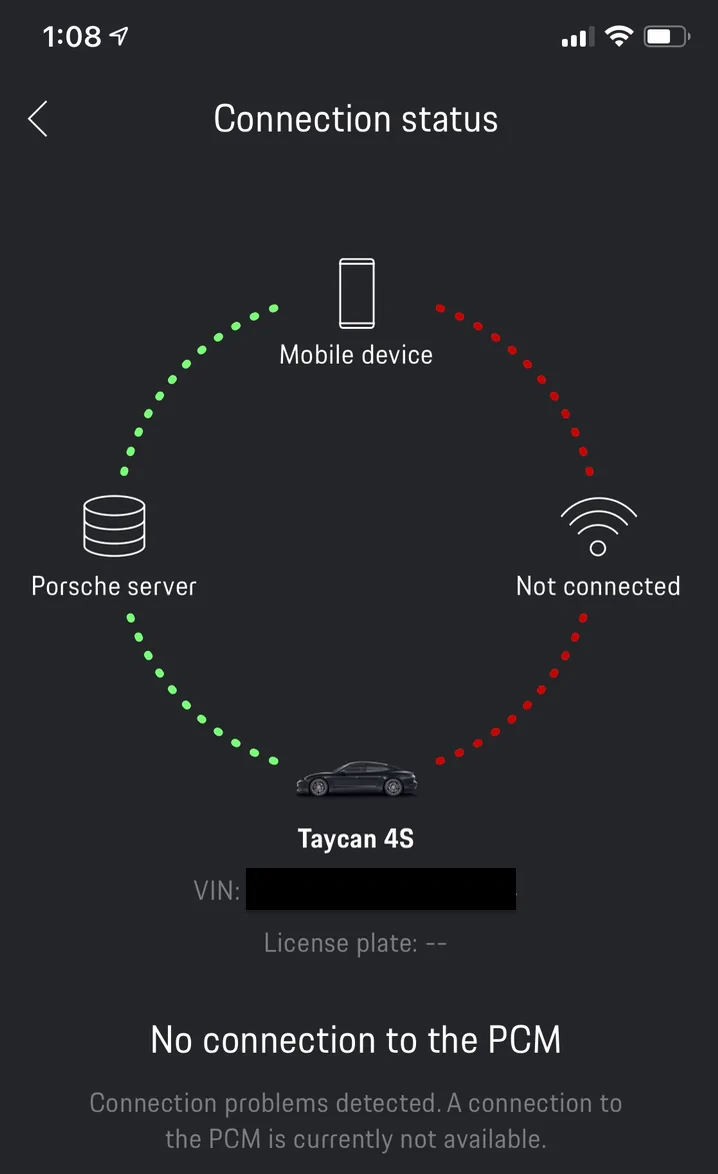

My 2021 Taycan 4S was delivered on August 3. It is an incredible vehicle! Unfortunately, I am continuing to receive the “No connection to PCM” message on Porsche Connect. Also, I cannot load the Porsche Charging Locations on the Nav or the “news” or other information that access cellular data service. I have tried to connect at numerous locations to ensure that the cell service is not the problem. Any thoughts on how I might get a connection?
The bottom right quadrant is not relevant to anything unless you want to connect your phone to the in car WiFi hotspot to sync your calendar(s) - not much use besides and has no bearing on any other access.
The key pathway is from your Mobile to the Porsche Server and then to your car (not the other way around). Normally bottom right quadrant is always red (next time you're in the car start the in-car hotspot and then connect to it to see the red go green).
Top right quadrant should be green e.g. when connect via your home WiFi (or other)
Missing / inactive services are possibly due to your service activation process (by your Dealer) - so Weather, News etc are part of that process. Check the state of your services on My Porsche to see what is active and what is pending. Also there could be an issue with Verizon (or whomever provides the LTE service for the vehicle).
None of these services require the optional / additional data service - you only need this if you have non-cell enabled devices e.g. tablets that you want to share data via the car's hotspot rather than using your mobile as a hotspot.
