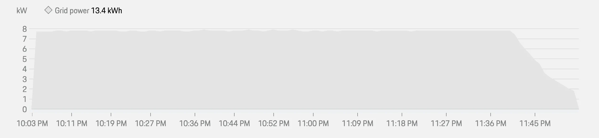

here is the power draw graph from charging my Cayenne the other day - nearly 2 hours solid "flat" line at a full 7.x kW - no other home appliance behaves like this…the taper at the end is when the battery is close to full so the amps are backed "off" to gently land the battery at 100% for longevity.
for the mathematically/engineering inclined the two axes of the graph are "kw" and time - at any given moment this graph shows we're close to 7.2 kW - the area under the curve is kWh (kilowatt-hours) - the summary at the top nicely illustrates the area under this curve is 13.4 kWh of billed electricity usage - my off peak rate is about $0.08/kWh - so this charging session cost me $1.07
