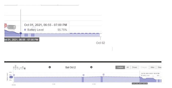

My car just sat in my garage for 23 hours and 55 minutes without losing a single battery percentage. Not plugged in.
Try 3 weeks! I was on vacation and left it home. Same battery %, about 54% (I was trying to be close to the 50% storage percentage recommended in the manual).
Typical SoC loss through vampire drain is about 1% per month (with internal monitoring set to off).

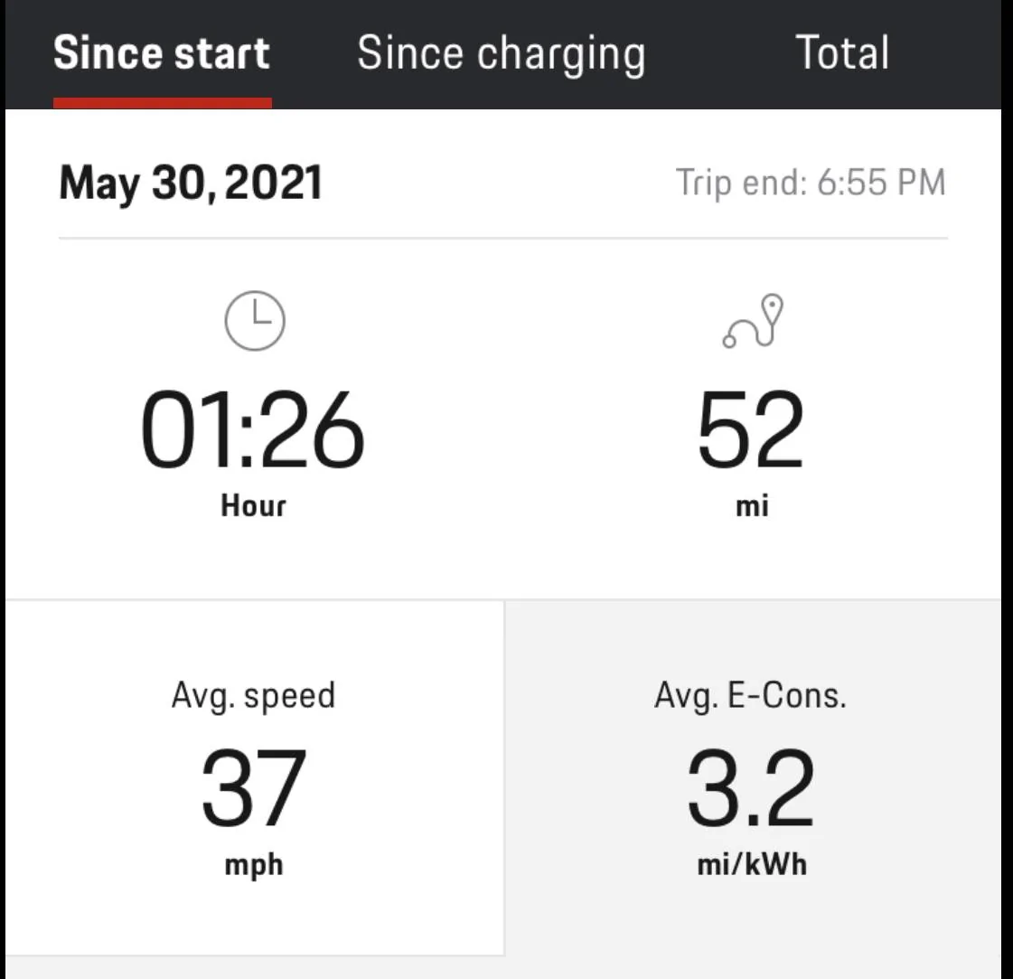

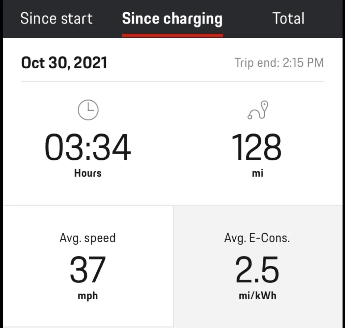

turns out I have mounds of data…
the porsche connect app has complete history of “trips” and if you scroll back far enough you can find all your “efficiency” data from your deep dark past
my Taycan was clearing a 2.8-3.2 mile/kWh consumption rate in april/may - then I swapped tires in June/July (all seasons were at wear bars) - and after that point my trip data clearly indicates a drop of new ratings in the 2.2 - 2.7 mile/kWh range - making the Taycan a 220 mile vehicle…
turns out with summer tires on the car the EPA range estimate isn’t too far off the mark - the Taycan still does better than the official 201 range estimate - but with OEM Factory All Season the vehicle routinely did 260-290 miles vs. the 210-220 range I’m seeing with the Goodyears…
I’m ditching the summer tires as soon as I can find some Factory OEM all seasons EV tires in stock - for street driving I want the range more than I want the marginal increase in grip vs. all seasons.

Before the tire change with Factory OEM All Season Tires (contenential) - 3.2 mil/kwh - max range = about 265 miles (easy to accomplish)

after tire change - Goodyear F1 summer tires installed by Porsche Dealer…max range = 207 miles maximum range - 210 - 220 possible - hmmm pretty much in line with EPA estimates of 201 - hmmmmm - seems the all season factory tires save Porsche’s butt in terms of real world experiences.
