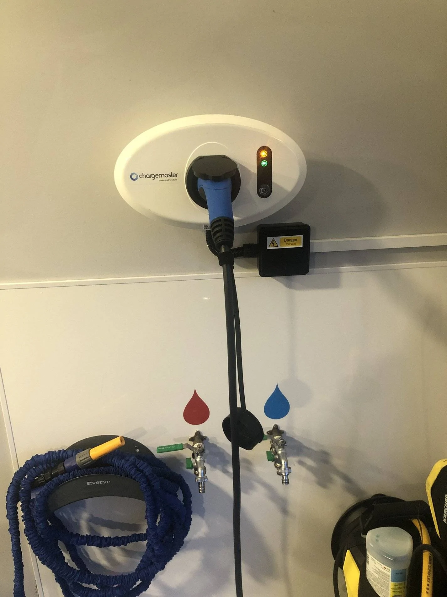

I’m going for a BP Chargmaster. I already have 64amp cable wired to the garage and already have a point installed for wife’s car. The second one will allow us to top up at the same time.

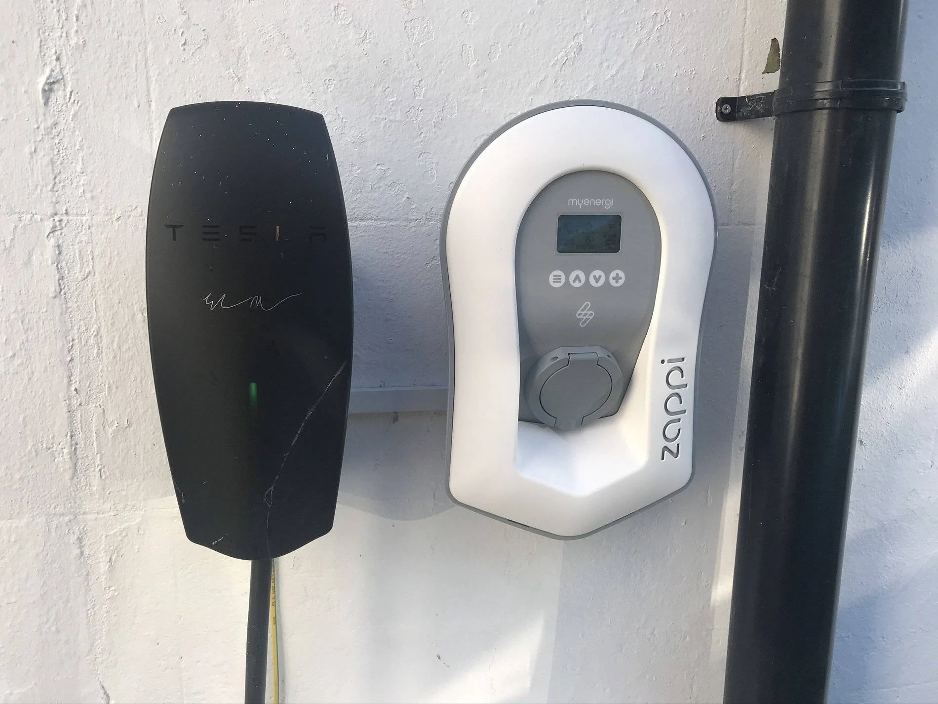

As for the unit I would go for, the last unit I had installed was a MyEnergi Zappi 2. It’s main trick is that it can sense when excess is being generated by the solar panels on my roof and it then charges the car using that excess. It uses wireless clamps around the grid and generation feeds to determine this. It also co-ordinates with the home battery I have and the water heating distribution unit as well. It has an app that you can view and control what is going on.
At my leat house I had two Rolecs which I used for 4 years. They are one of the cheapest out there. Initially they had breakers that used to burn out but they are now solid as a rock.
This is a pic of my set up. The grey one is the Zappi and the black one is a Tesla unit which Elon Musk scribbled on! The Tesla unit has a permanent tethered cable which cannot be removed. Great until it breaks and requires a replacement (which it has!).

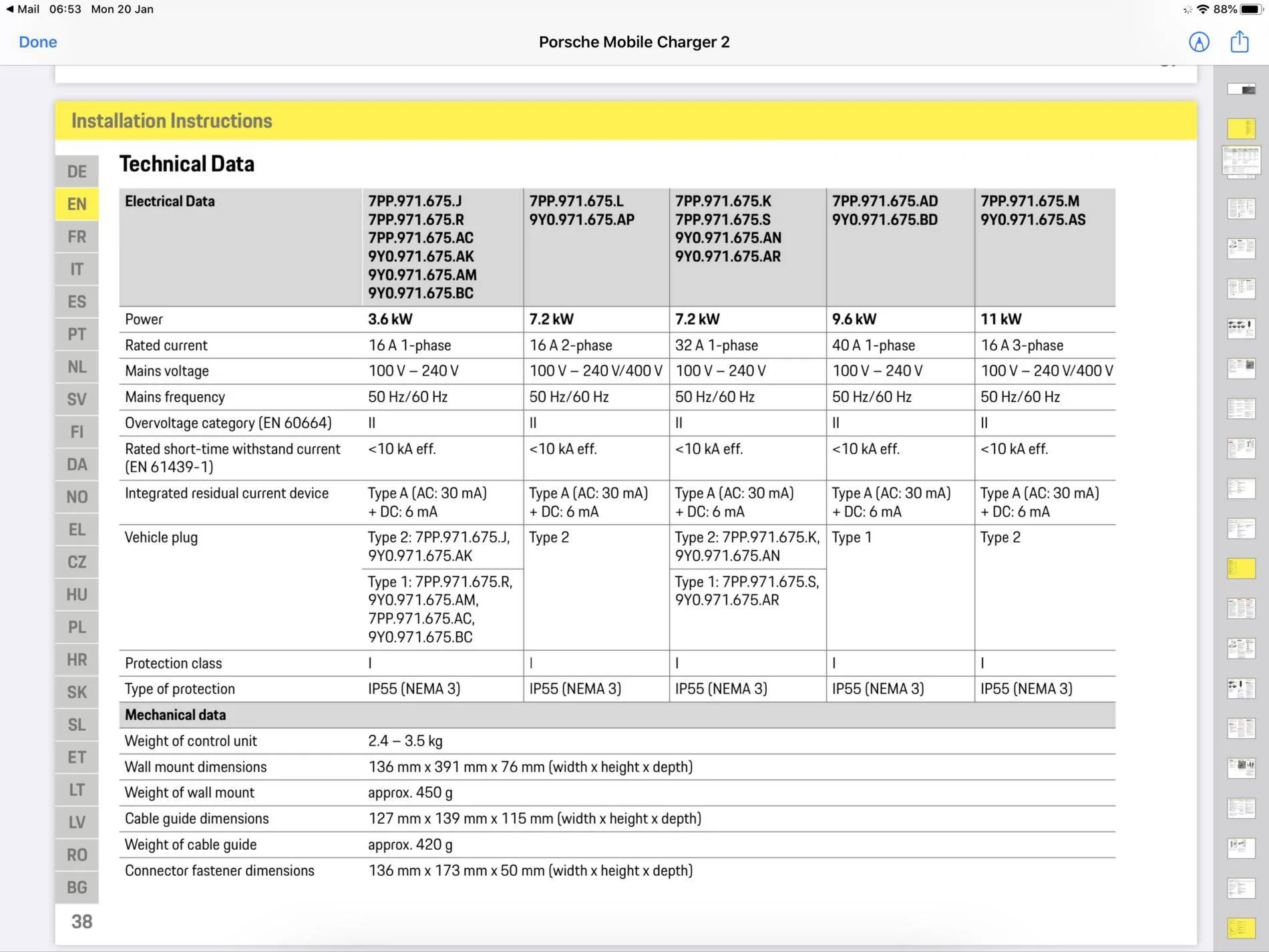

I’m not sure you will get 7.6kW from the charger on single phase in the UK. From the information I’ve being seeing it appears The Porsche charger is only capable of providing 3.6kW! So just the 30 hours to charge For your forced £730 option. I hope I’m wrong........

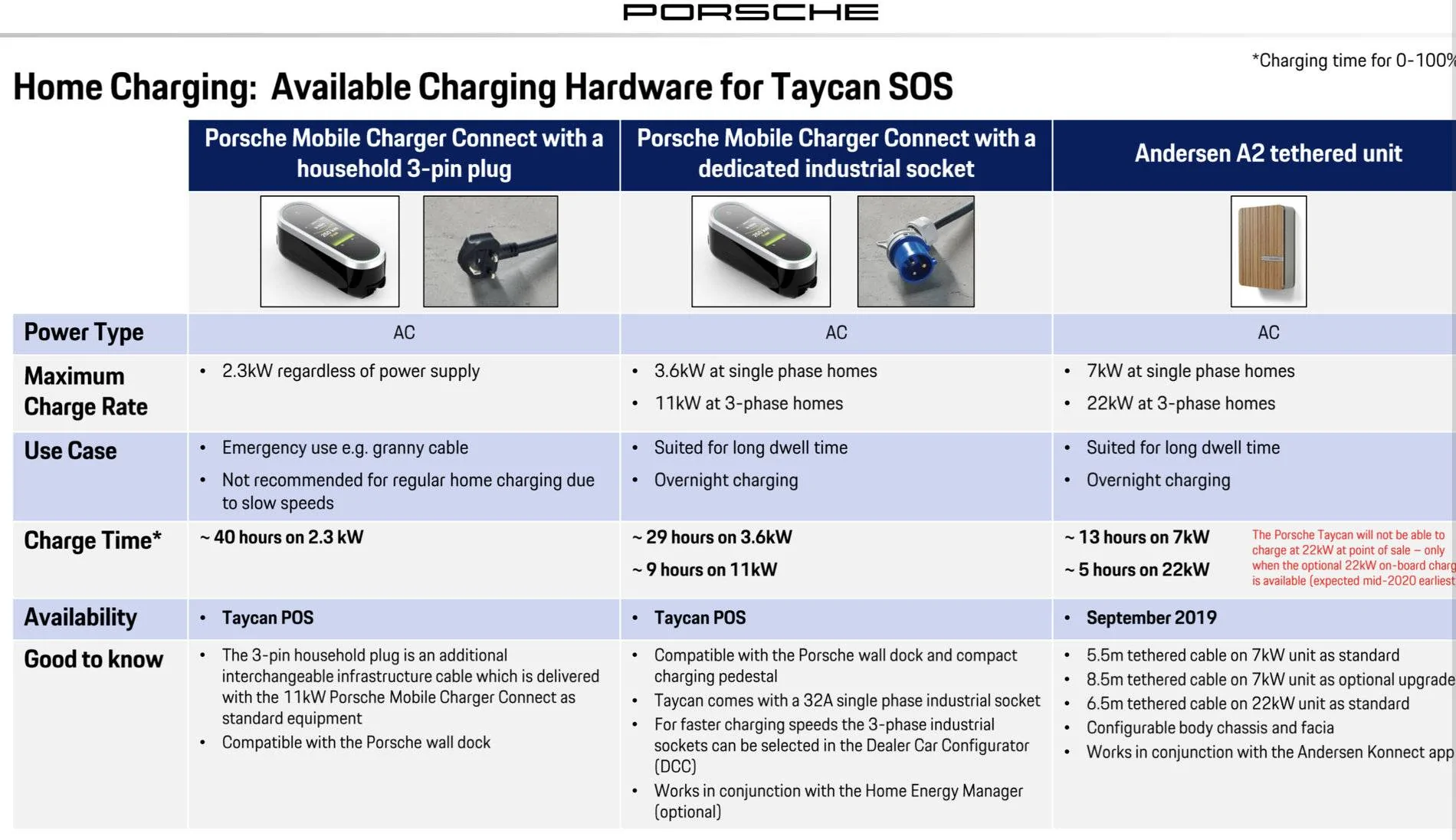

I think it might be worse than that!
2.3kw if connected to a 3 pin plug, 3.6kw I’d using an industrial socket on single phase.
You only get 11kw if you have 3 phase power.
I’m lucky in that I have 3 phase but circa 40 hours if you use a plug!
Porsche Taycan Home charging in the UK 0236093A-DEDB-4087-9DDB-3018FD6835C0

Looking at the extract from the charger installation documentation it shows more than the low 3.6kW charging current. It shows up to 9.6kW.
from single phase 40A supply.
