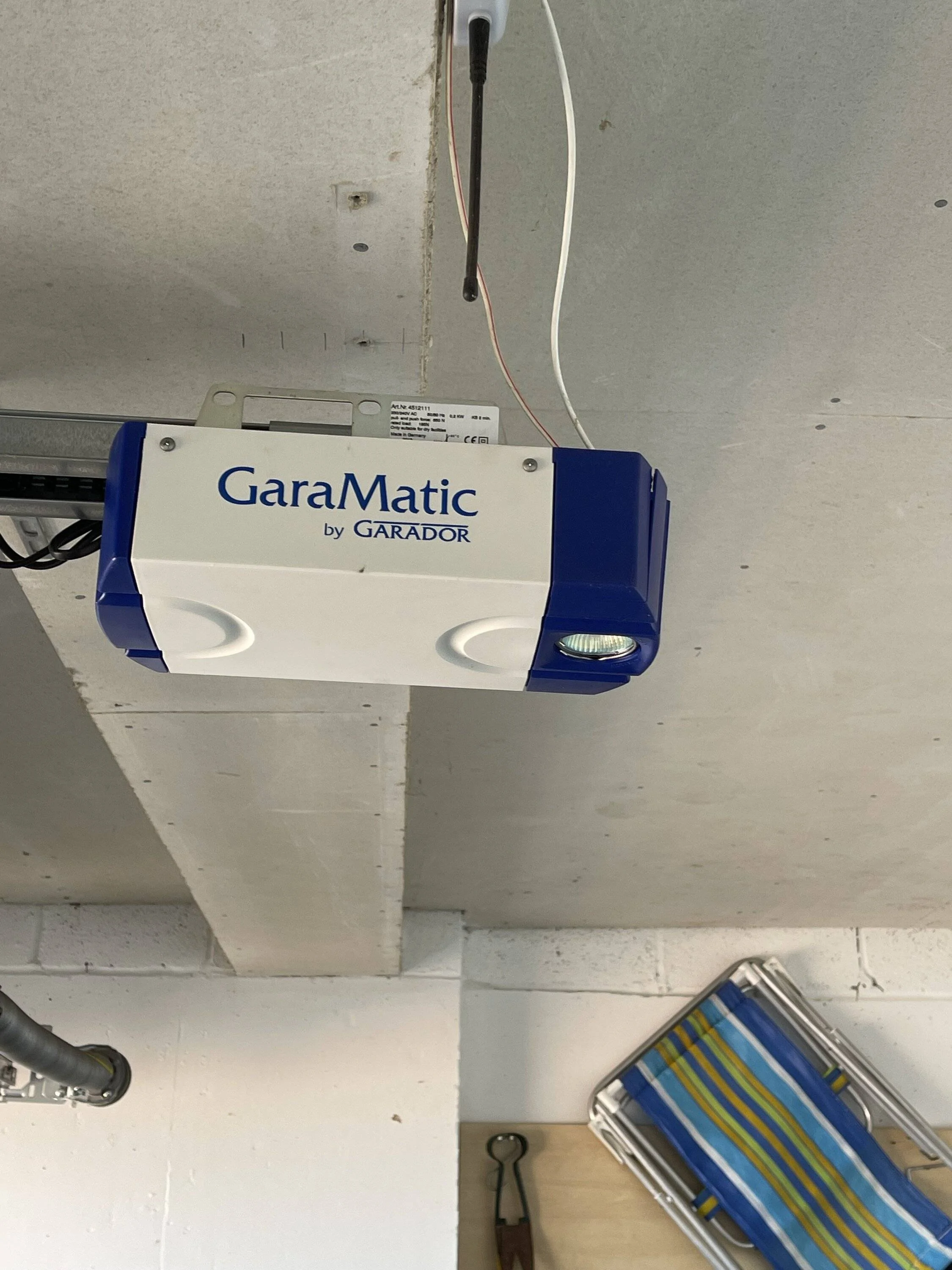

Can anyone advise on settings up the home link to my Garidor (GaraMatic) garage door?
The car accepts the signal from the fob, but I have not idea how to program the Garador unit. I’ve programmed key fobs before with no issue, but can’t find info online to get the unit to talk to the car. Any help would be appreciated
Porsche Taycan Home link help IMG_0026

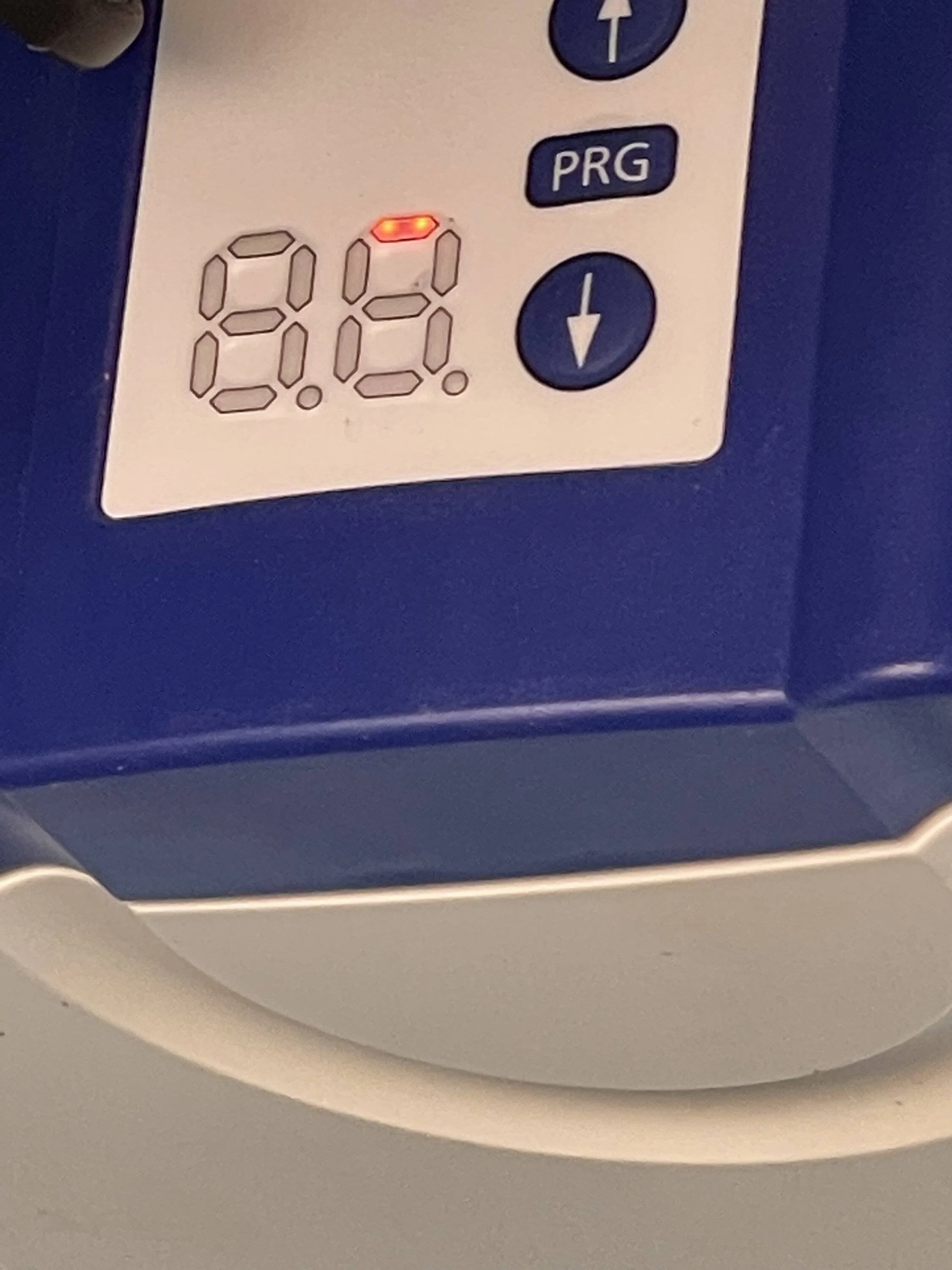

thanks for the reply. There is no program button on the front panel!
Only this , see photo
Porsche Taycan Home link help IMG_0025

Yes the button changes the numbers on the digital display
I can do this to program a new hand set that open and closes the garage door.
unfortunately I cannot find the method of setting this digital display to connect it to the car.
