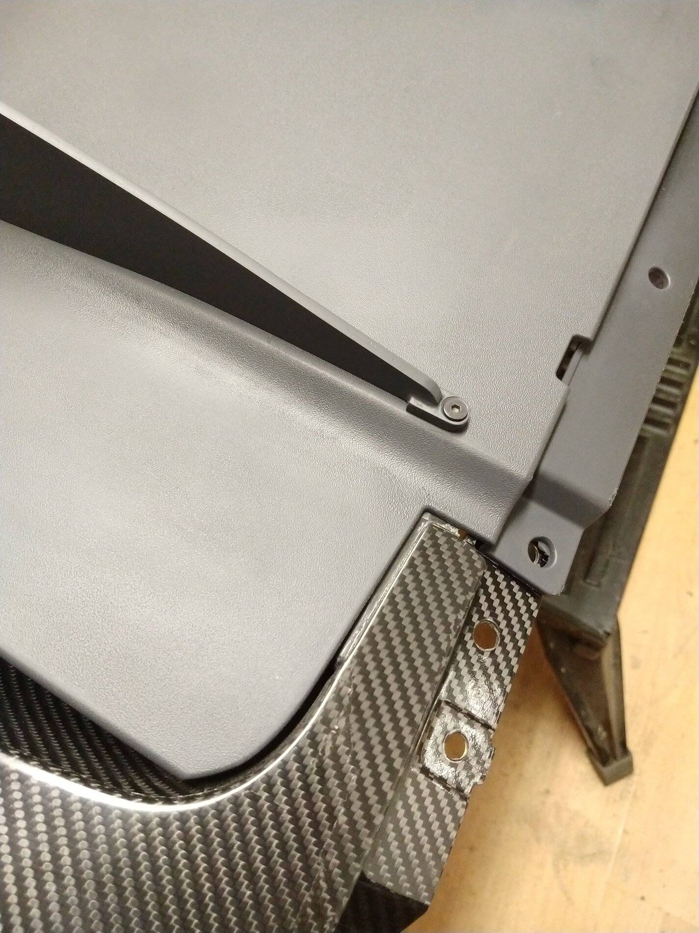

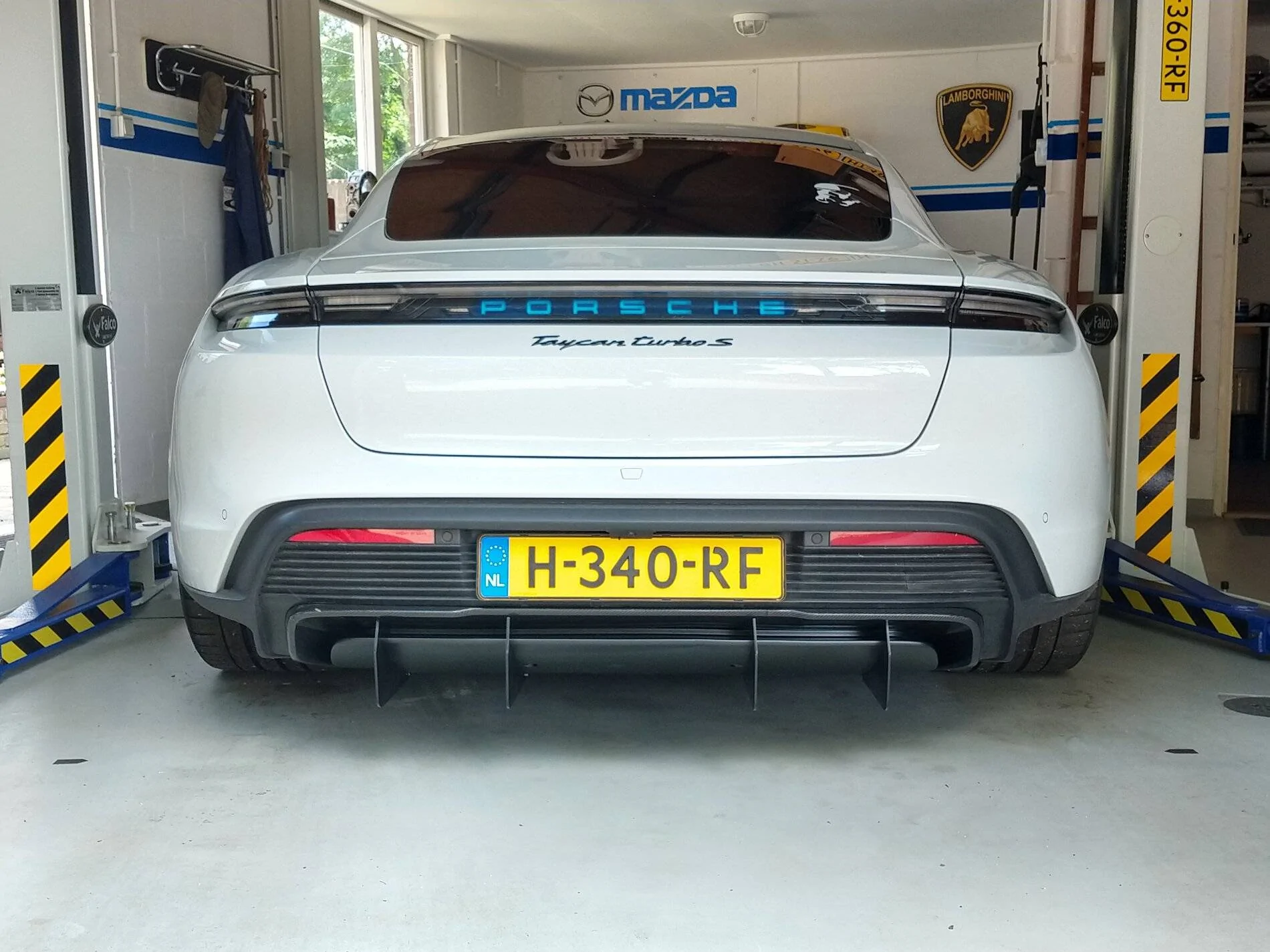

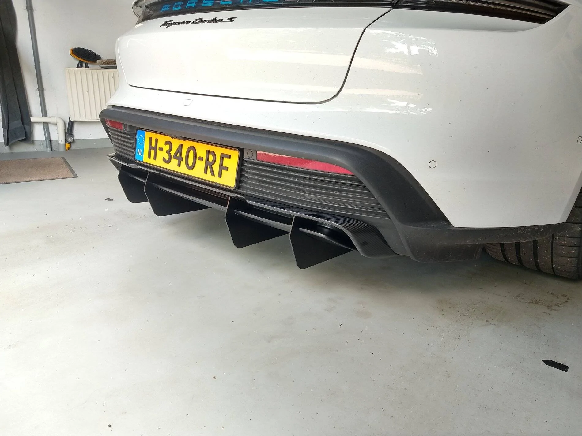

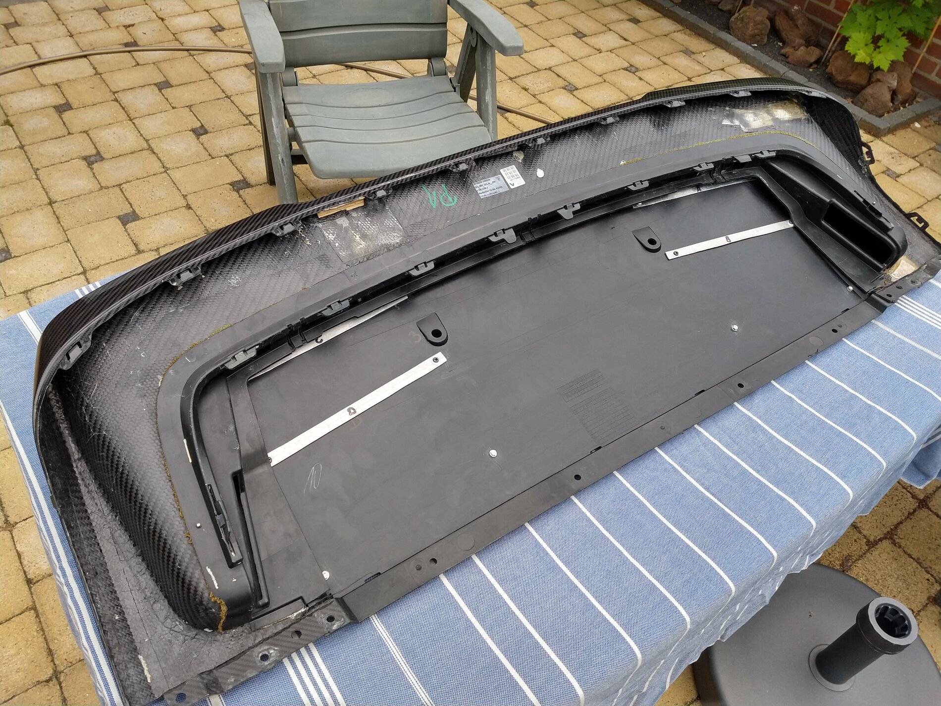

After several protypes (cardboard shapes), different mountings, trying different materials (acrylic -> abs plastic) and different colors (dark grey->black) I'm proud to say Project Diffuser is finished to my satisfaction.
Enjoy:
Porsche Taycan Home-made diffuser finished! IMG_20210709_151427111_HDR
Porsche Taycan Home-made diffuser finished! IMG_20210709_151345760_HDR

Blends in nicely!
How is it mounted?
Reactions: Dee

Blends in nicely!

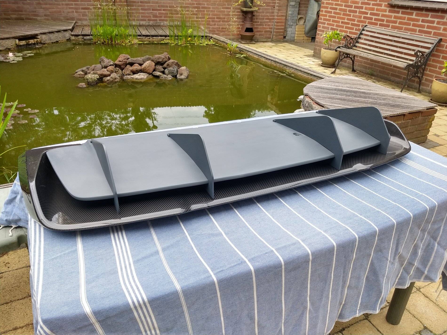

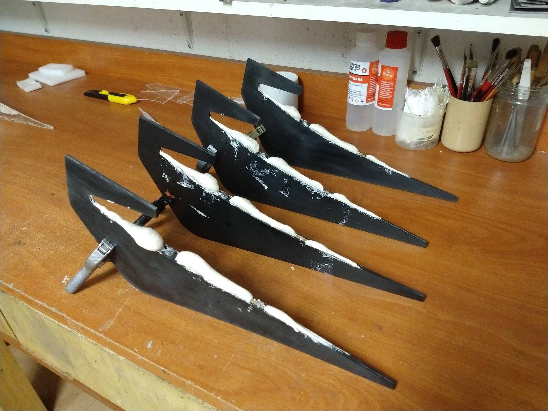

How is it mounted?
With three screws per fin.
Just to be sure they don't fly off...
The alu strips are for more sturdiness (in case they start to vibrate).

How is the ground clearance in the back? Do you find it harder to reverse into these (below) when in low suspension setting?
Nothing has changed actually.
The fins are as low as the car's bottom (the underside, not the ass :) )
Still, I'll take bumps on normal level just to be sure.
It's different when you drive off a curb cuz the suspension compresses a bit due to the weight of the car, only then you'll have to drive slowly.
