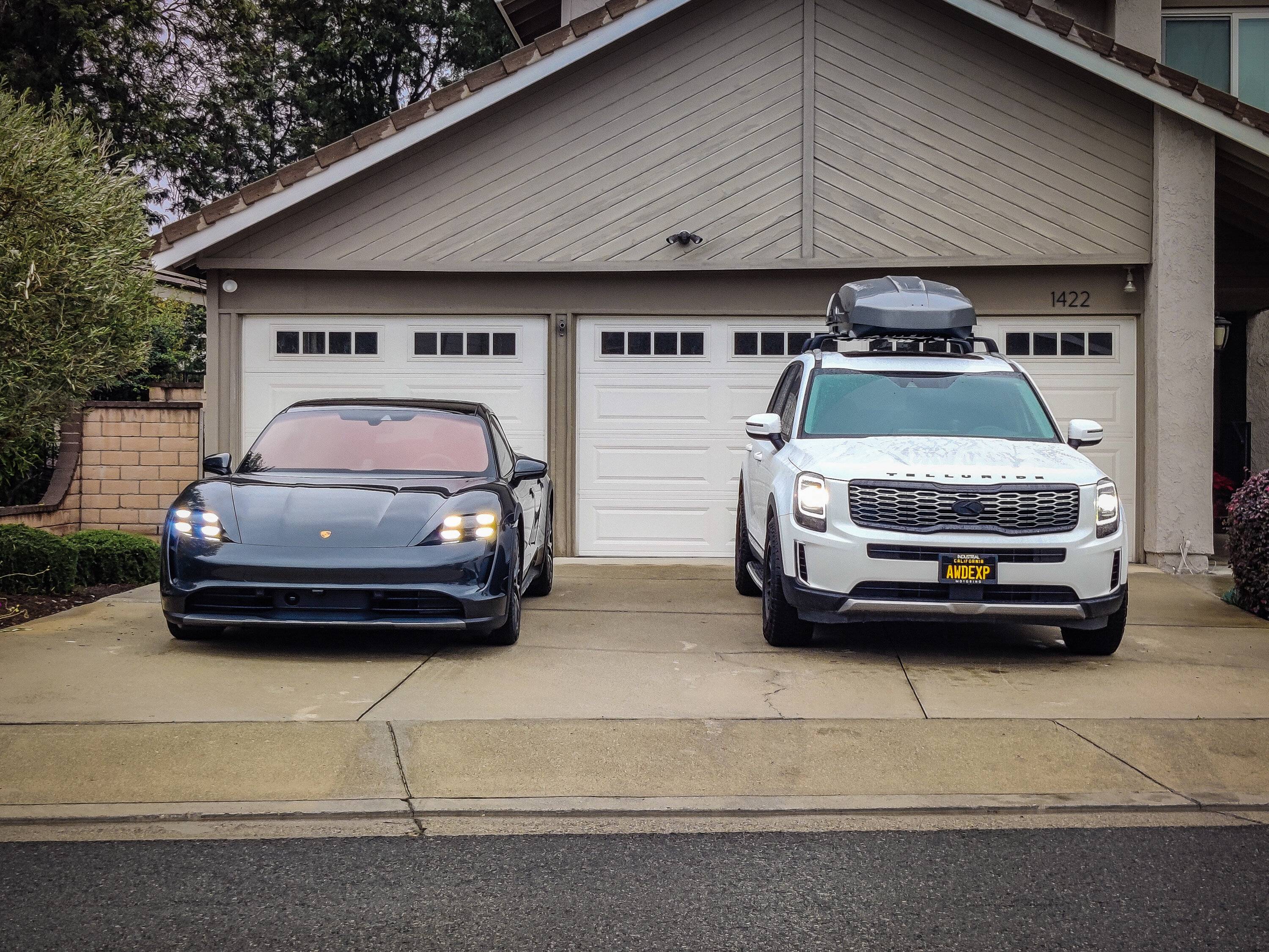

So can the Homelink be programmed with more than 1 door opening profile?
Porsche Taycan Homelink Profile - I don’t get it… PSX_20211223_111942
I have mine programmed to open the smaller of the two garage doors in my 3 car garage but there are times I want to open the main door ,just park the car in the driveway and walk into the larger door just to go inside the house.
I believe you can program an additional door - I saw the option when I was looking for options on the profile I already have programmed. I’m not sure if you’ll get a shortcut button but you would see both doors Listed under the Homelink menu item on the main Home Screen (with all the icons).
