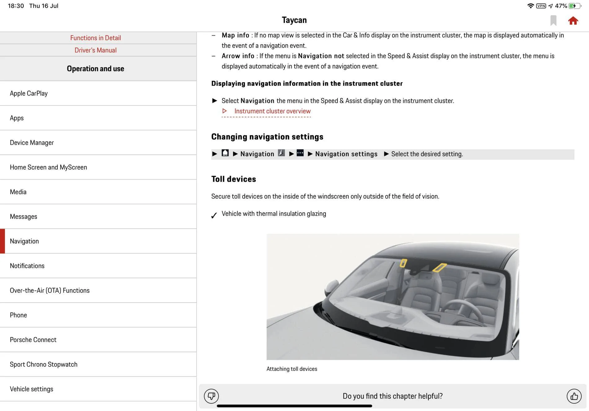

I can't find the picture that I found, but there are two rectangles to the right and left of the rear-view mirror mount that they have removed the laminate to allow ez pass to be read through this....I have mounted mine at that angle flush to the rear-view mount (it is almost vertical) and it has now been registering just fine....you just can't have it mounted 'flat' or parallel to the dash/road. I will look for the diagram/picture if I can find it.
I’ve tried here without success in the Taycan. This is the area that works in my other cars. Perhaps I should try a different angle. I’m curious to see your pic. I do have tint - but it’s not metallic - so it shouldn’t interfere but I think it might be. I have a proximity tag for the parking lot at my office and it doesn’t work either. I have to hold it out the window.

Another poster found the picture I remembered and I attached it below on where to and what angle to place the toll pass. I have mine on the passenger side and I can't see it when I drive, but this is the illustration I was talking about on it being at the overhead consul / rear view mirror set-up. You can see that it has to be at a slight angle and not perpendicular or parallel to the road (which is how I had it).
Hope this helps!
It would be great if you could post a pic taken from outside!
