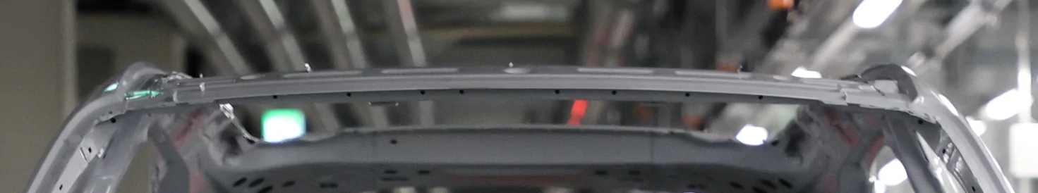

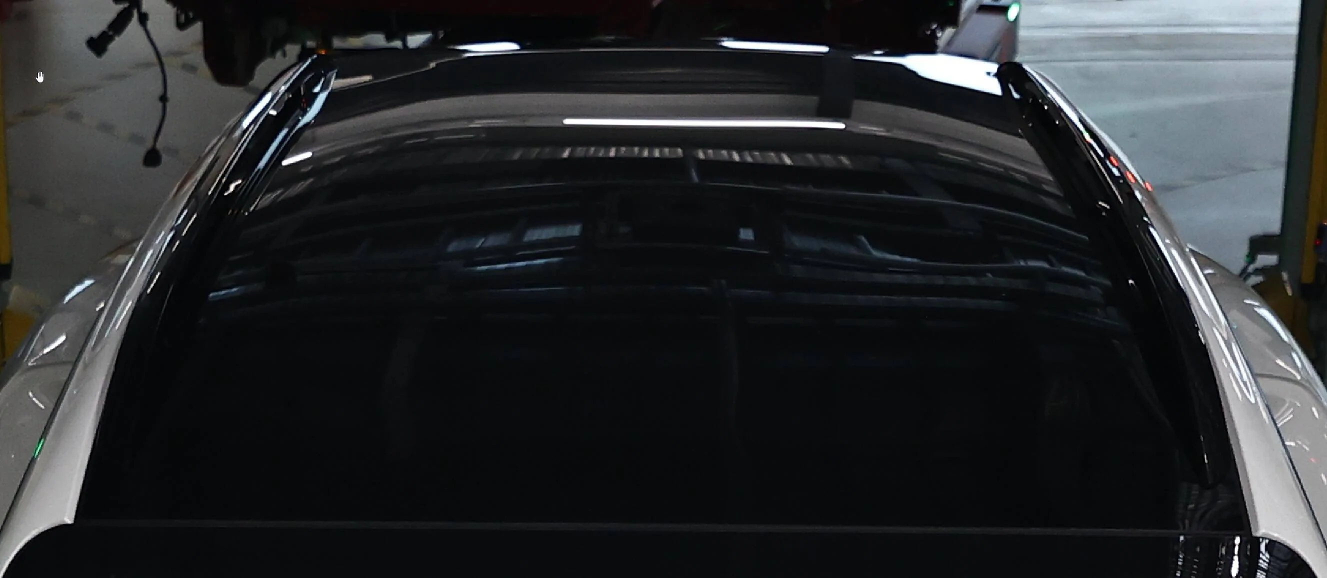

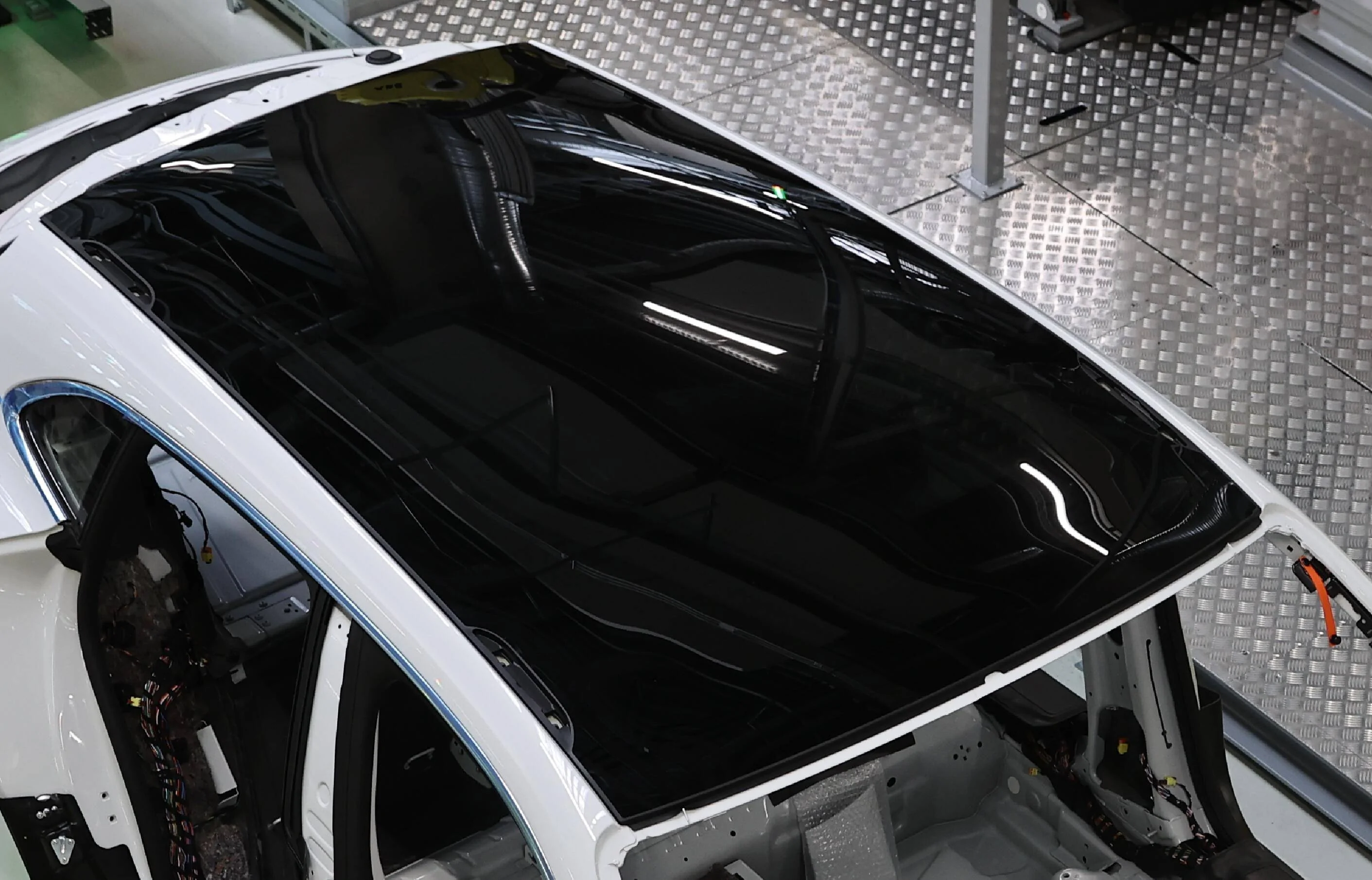

From my factory photos, that does not seem to be the case.
First body with no glass or rails:
Then the glass goes on:
Then the rails:
It stands to reason, you'd disassemble it in reverse order.

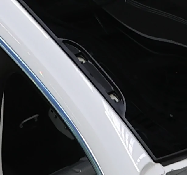

Like this:
See picture in the previous post for context.
Thanks for this. My car already got the rails on for the TYD factory picture. Looks like the entire headliner will have to come off to access those mounting points from inside the car.
Then the rails:
Thanks! So glad to see that the rails do not require the roof to come off.
