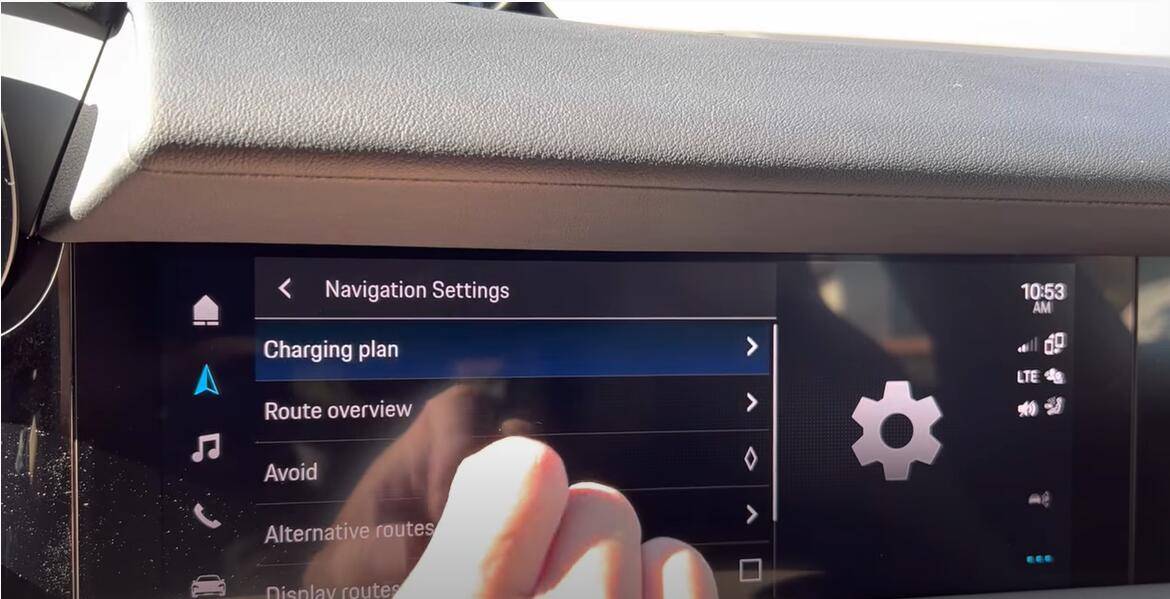

When I pressed the 3 dots on the bottom right of the nav screen, I don't see the Charging Plan option. The first option in the sample screen below is the Route overview. From what I can tell, for that menu option to appear, I need an Active Porsche Connect Service. Isn't that the service that everyone has to have to track TYD, or get a PIN for your PCM? So, I should have that. Second is an active charging service, which I know I have since I've been charging at EA stations all the time. Is the charging plan an optional feature?

Yes, I was asking if the Porsche Connect Service the one that lets you TYD.
I have activated my PCS and it's good through 2023. Am I missing anything else for the charge planner to not show?
No it is not related to Track Your Dream' (TYD). TYD is only available in North America and is part of the order acceptance process.
I don't think you are missing anything but suggest to call your dealer to check your Porsche Connect ID and related services if anything is wrong there.
Sometimes menu options disappear and then magically reappear after a day or so.
To me this looks like an admin glitch.

My SA initially told me the charge planner wasn't showing up because it's part of the Range Manager option, which I did not purchase. But, after digging around, that is not the case as although the range manager is an option, the charge planner is standard on all Taycans. He's going to get with the "expert" at the dealer tomorrow when that guy returns...lets see.
Ok that's interesting - you are missing a trick without the Range Manager - PIRM (I assume). STD for UK cars.
Perhaps there is a dependency here.
