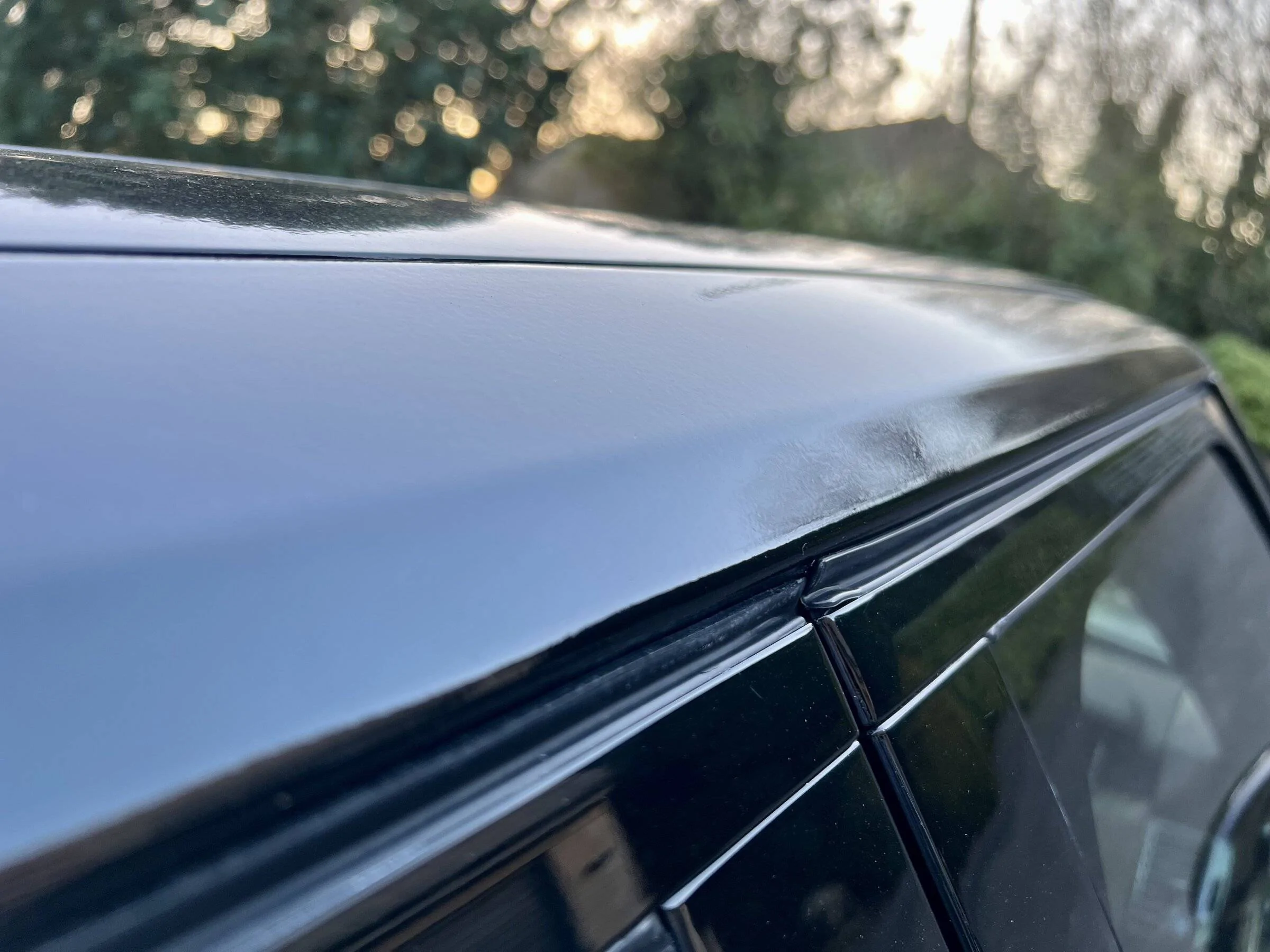

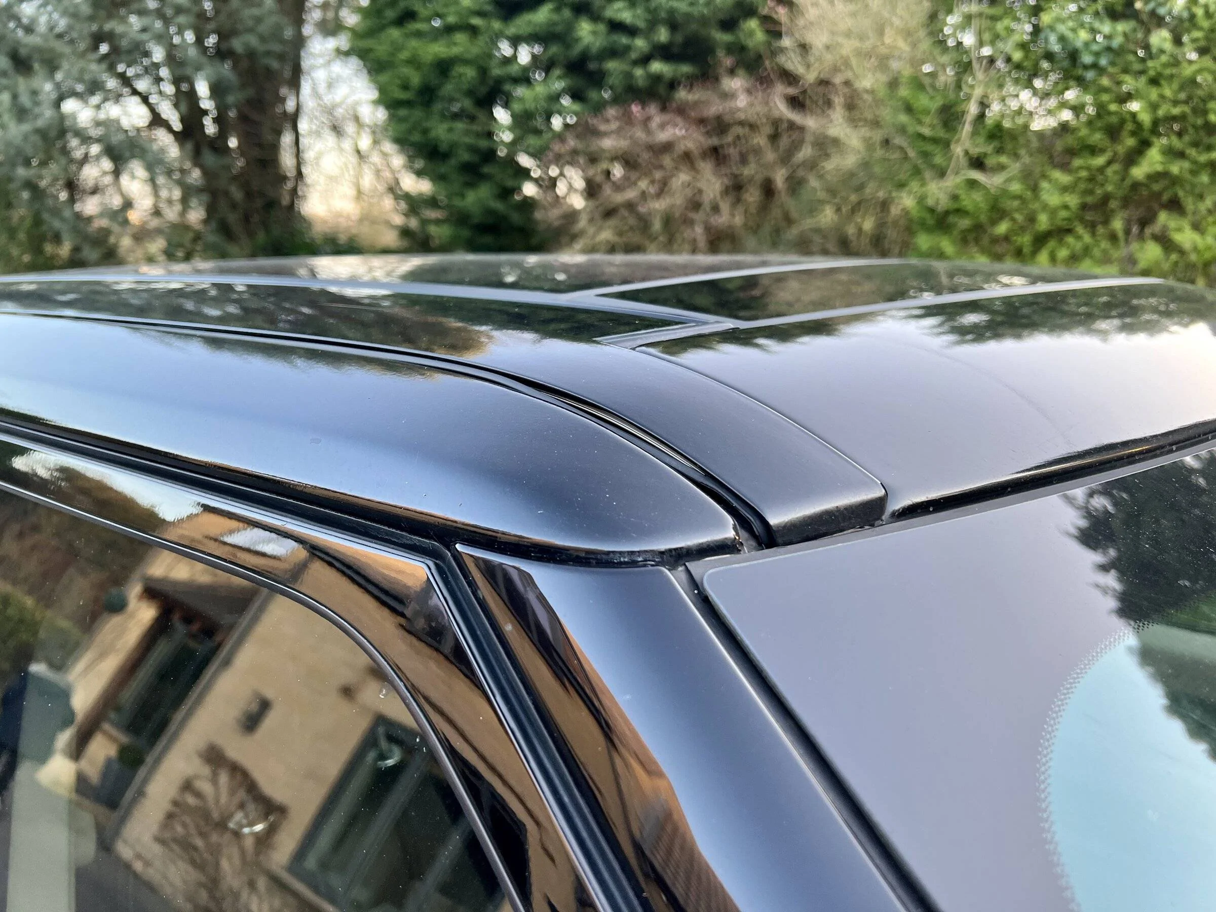

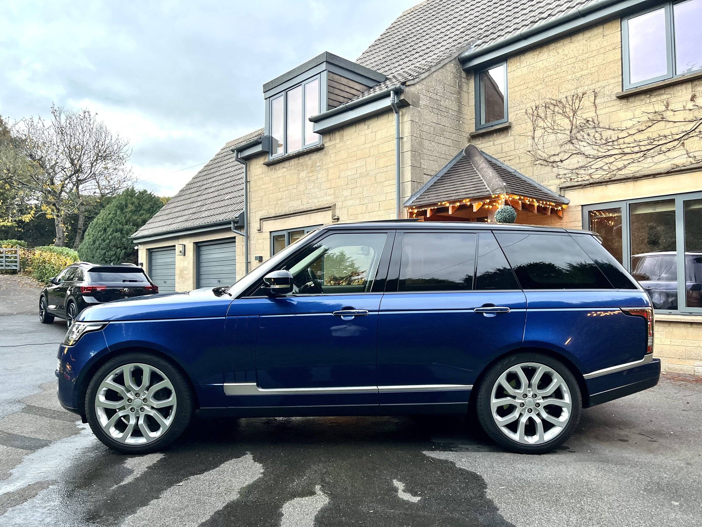

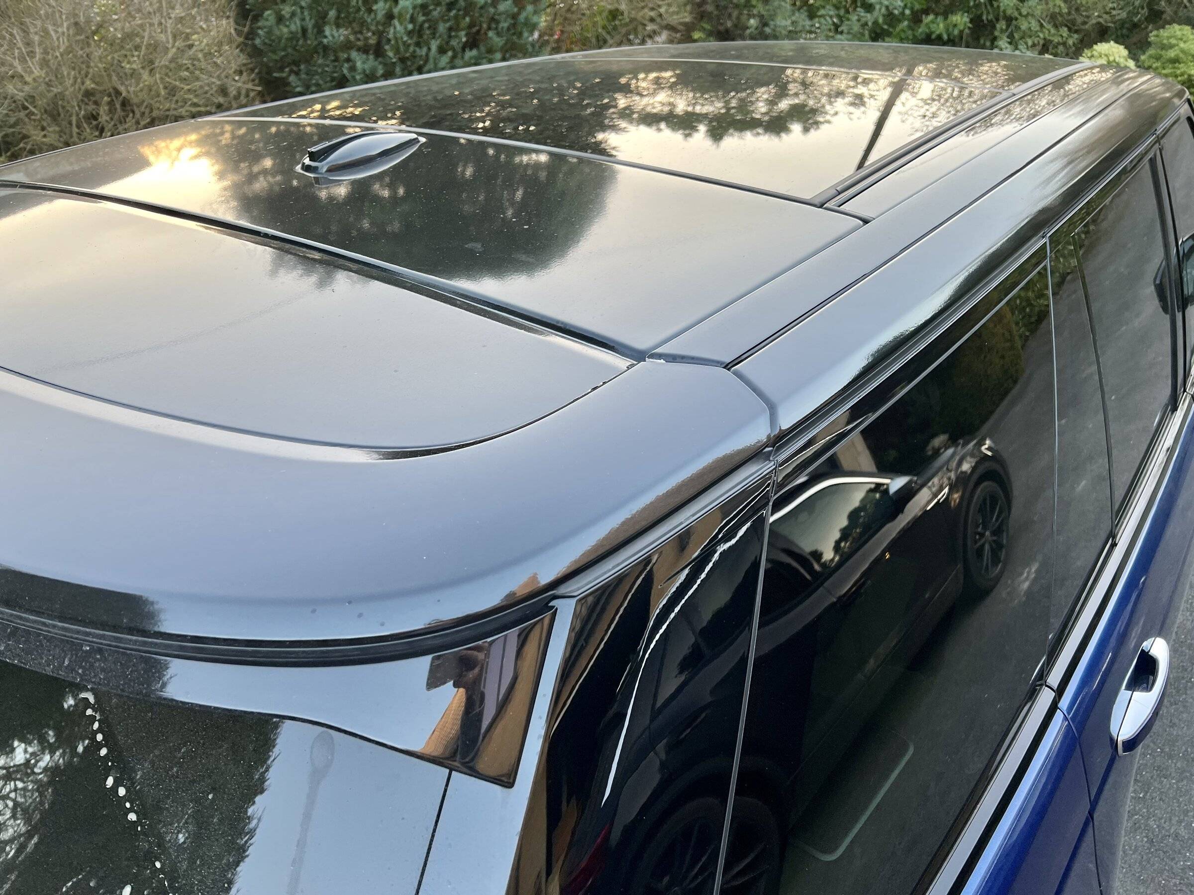

Snapped a couple of pics of mine for you - the door/back window trim, windscreen A pillar and pan roof trim are factory painted gloss black. The rest of the roof/Mirrors/car is wrapped. I tried to show the difference but you have to look hard in person. Note it’s been there for 3yrs and is filthy at the moment.
FWIW no one ever clocked that it was a wrap unless I told them so, even at the dealership when in for MOT & servicing.
