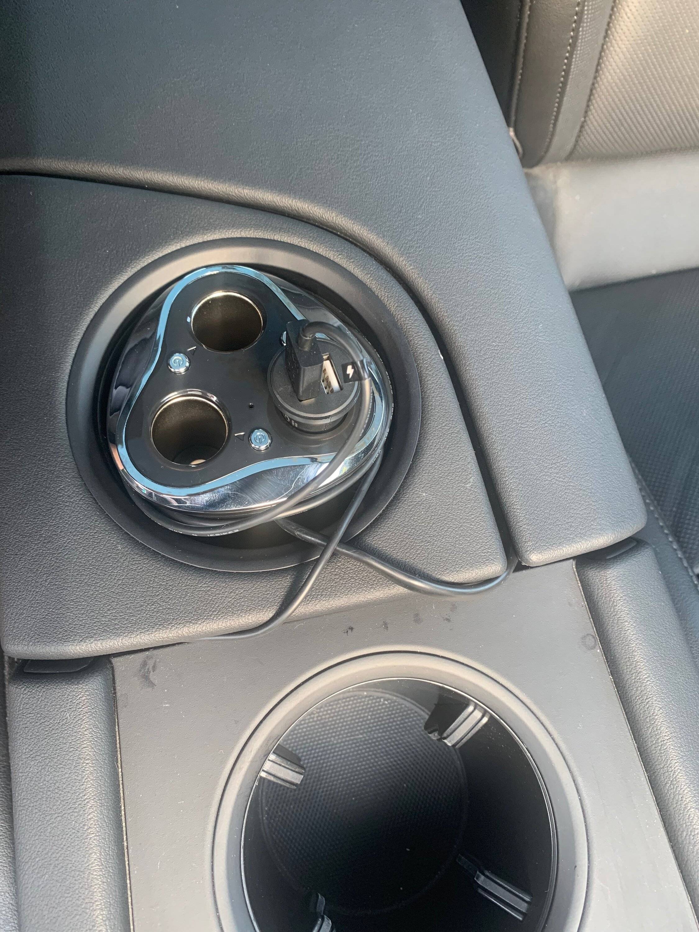

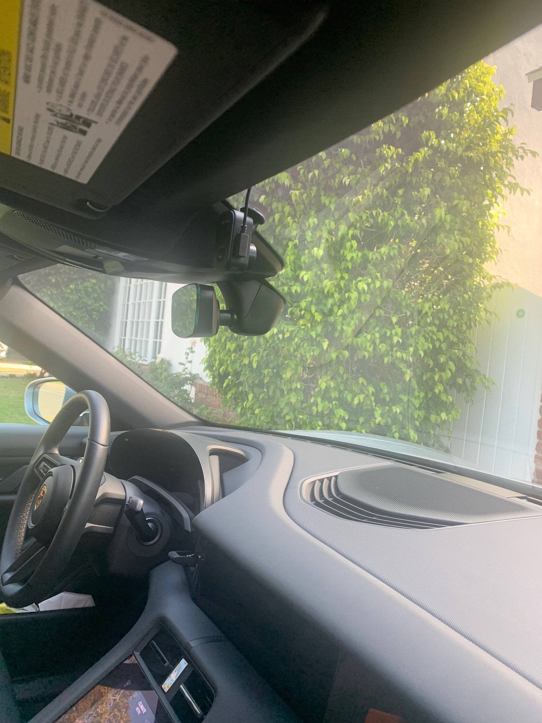

I purchased the Garmin Mini 2 for $130 and the Skyocean cup power socket from Amazon for $20.
I was able to hide the cable leading from the camera to the 12V power outlet in the center console. As you can see from the picture the cables that do show are minimal. I ran the cable from the camera to the console by pushing the cable behind the trim. I used a plastic tool to push the cable behind the trim and it was easy.
The 12 V outlet has a cutoff timer that turns power off to the outlet after 30 Mins when the car shutoffs. I purchased the Skyocean power adapter so I can turn the power off to the camera( camera has no on -off switch) by pushing the power on off button on the Skyocean, just added protection to ensure the camera has no power when I exit the car.
