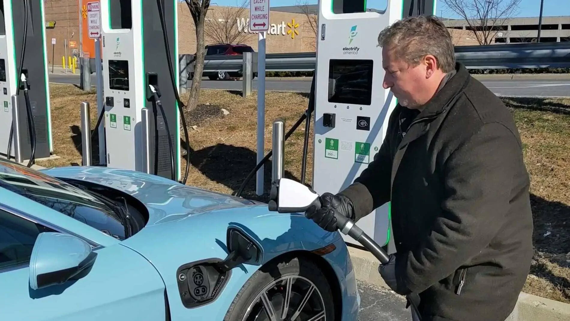

At about 12:30 on the video he addresses the 150 kw/400 volt charger option on the Taycan. He says all 150 kw DC fast chargers in the US are 800 volt, so the option is not needed. I know this has been debated in other threads. So, is he right that 400 volt DC fast chargers in the US max out at 50 to 60 kw and those above that level are 800 volt? My 4S order will lock soon, it‘s a minor charge for the option, but if it is not needed, then no reason to tick that box.
I understand your concern. I had made that determination that 90% of non Electrify America chargers that are over 50 KW are 950v+ and 100% of EA chargers are 950v+ so I skipped it on my spec. Though many other owners and I know dealers suggest you get it as an insurance policy. I know it's relatively cheap at $500 but there are a lot of places to spend dollars on Porsche options that you actually get to enjoy like maybe massaging seats if you are into that. I am still convinced I made the right decision to avoid additional hardware that is unlikely to be exploited in the United States. I did spend the $300 on the charging planner and that is so far not a very effective use of money, but I am still hopeful that for sure will eventually make that a worthwhile investment.
One thing you can look at is plugshare and select the filter option choose ccs and deselect superchargers and select over 120 KW and deselect Electrify America as a network. Look across the United States and all I see is one major Network in Oklahoma (Francis) which I called and their Chargers are 950 volt and mostly the rest is chargepoint which generally does not install such fast Chargers but when they do they use the tritium Chargers which I believe are 950 volt.
Of course in the first three years I will focus 100% on Electrify America as that is where I get the free charging and beyond that I am hoping that Porsche will give a good rate plan maybe for continued Electrify America use. Their Chargers are not 100% reliable by any means but I found them to be more reliable than evgo and chargepoint in my past experience with my Chevy Bolt. And their customer service is top notch.
All the best in your spec decisions. I know that there are many. From the beginning of my decisions I had the premium package and eventually I ended up with the performance package also. I am happy with the behavior of the vehicle. That confidence inspiring so many use is not an overstatement.
